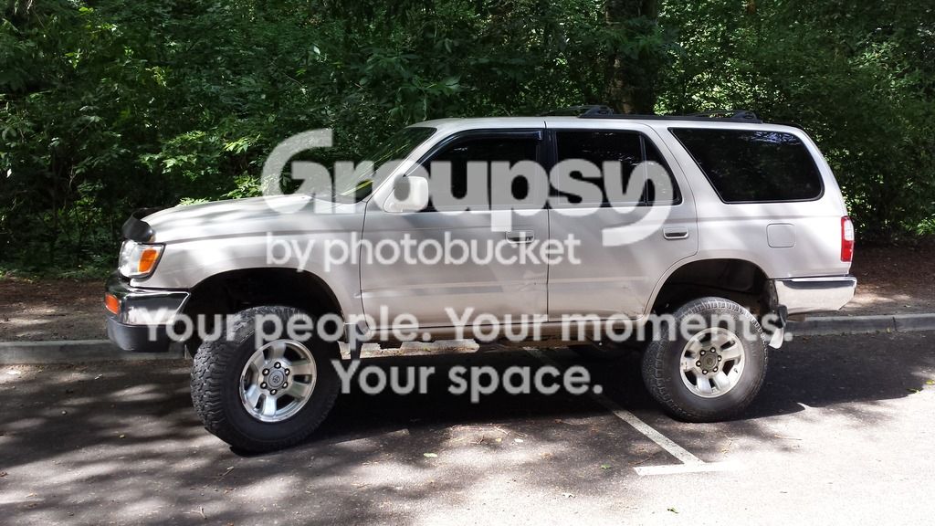

Toytec BOSS coilovers in front with 550 lb springs. I have not moved the collars to change the height from when I bought them (used) from A.Wilson, but I think he said he didn't change them either.
LC 8-wraps with Tokico Blacks in rear. I'm probably carrying 100-150 pounds in the back.

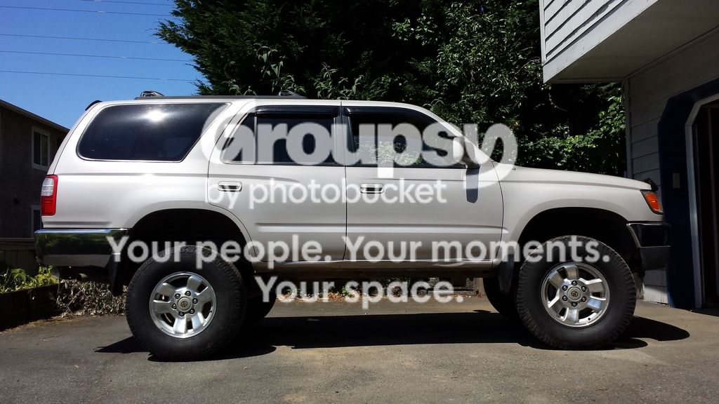

Here is a direct side-on view which shows the rake a little more clearly:
20150616_111930.jpg~original
Yeah pretty much wanted to see how it sits..also curious of the ride qaulity.
Ride quality? The front feels good, like it was meant for the truck when used in a more aggressive manner. It is not too firm, but I suspect it is firmer than stock. The rear is good, but not perfect for on-road. I'm happy with it. I feel that it is just a little more bouncy and firm than the truck would come with stock. I don't have any complaints about it being too firm. I aimed to build my 4Runner for a 50/50 on/off-road setup. I don't need it to be a cushy, luxury ride. Also, I think if it were any softer, I would be complaining about body roll. FYI, I am not using sway bars front or rear.

So you have the exact setup I am inquiring about? I am not too concerned about luxury ride qaulity but it cant be to bad where my wife wouldnt get in it. My buddy removed the lc8 because it was too stiff but he had a bit of weight on the back at times.
Didnt even see the picture.. [MENTION=101985]ShooterMcGavin[/MENTION] much appreciated. Looks like ill be doing that setup. What size wheels are those?
