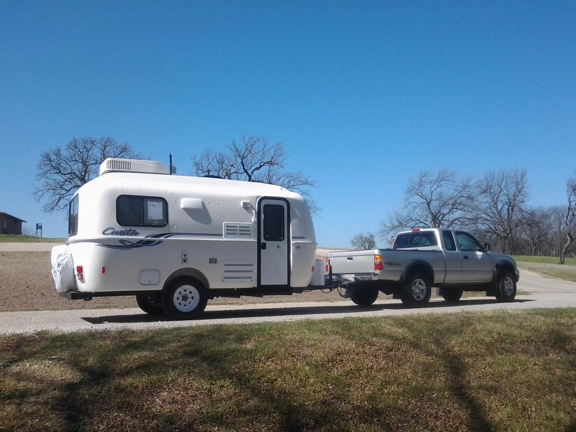

I towed this a couple hundred miles without issue.
Sure it was a bit slow climbing hills but I expected that.

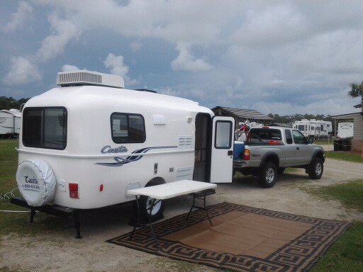

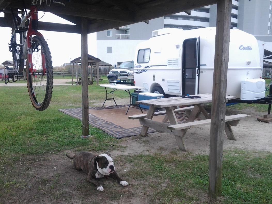

I know i'm late posting pics of my casita but i mentioned above that i would post some so here they are. I got my tacoma project together right before i had to go to Texas to take delivery of my new camper so i decided to use the man. trans tacoma instead of my auto. trans 4runner as my tow vehicle. I put just over 3,200 trouble free miles on it in 6 days, not bad for what started out as a blown up $500 truck. I also just returned from a camping trip in Myrtle beach S.C.
