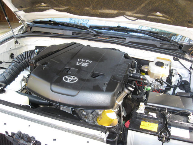

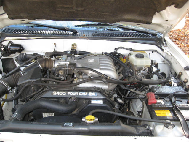

For maintenance, I give the 4th gen the nod. All V6 4th gen. have the chain and not to be too blunt, but chainging the oil in the 3rd is the worse car I have ever owned. Still my overall cost has been low on the 3rd. The oil filter on the 4th is great, sitting right on top for anyone to get to. See pictures of the two engines, below.
