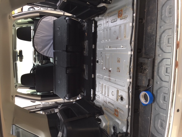

1) Rear seats come out really easily. Very intuitive and self explanatory.
2) after the seats were out, I sprayed all the bare metal with truck bed liner. Not really required, but I wanted an extra layer of rust prevention since water may drip back there with all the dive gear.

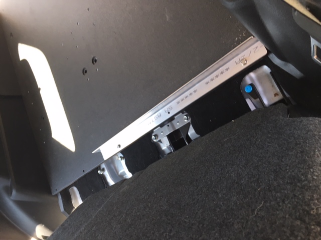

3) The goose gear plate mounts into the existing spots where the seat hardware went. I had to chase the threads, but that was about it.

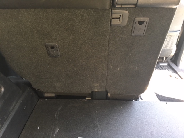

One of the changes I made was to add a piece that covered the rear of the second row seat where it pivots when you fold it forward. As mentioned, mostly dive gear goes in the cargo area, so I wanted to cover up this spot so sand/water didn't go behind the seat.
I used a piece of AL angle and attached it to the rear, using holes in the platform that Goose Gear pre drilled.
Then I cut a piece of 3/4' ply to size and put on a couple of coats of bedliner before bolting it to the angle.
You can see in the final Pic how it covers the gap but sill allows the seat to pivot forward. It also blends in nicely with the rest of the platform.

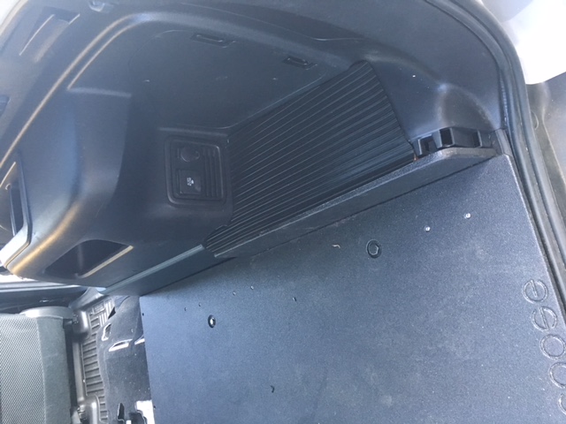

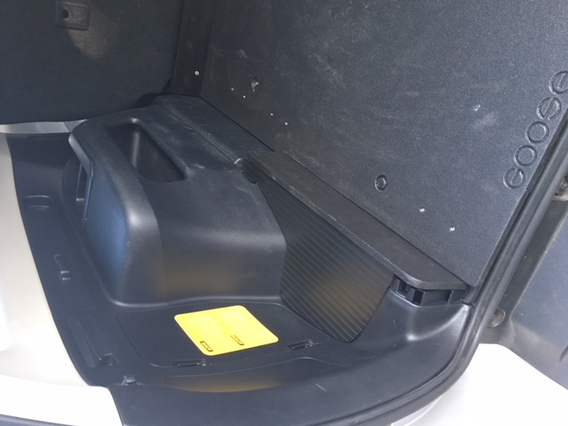

The other change I made was to the 'ears'--the space behind the wheel wells. (not sure what else to call them).
You can put the stock ones back after some trimming, but after you trim them, they are pretty flimsy since you cut of the mounting tabs and there is no way to support them. Also, if you use the stock ones, there will be a big gap where the seat belt use to come out. Instead, made some templates and cut them out of 1/2" ply, made some supports for under them, and covered them with rubber liner. Much more solid, and it covers up the seat belt area.
There is some 'wasted space' under them where you could perhaps store things, but for my use, this will work fine.

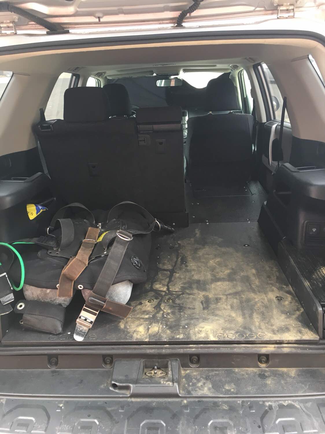

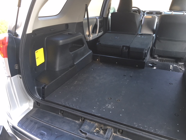

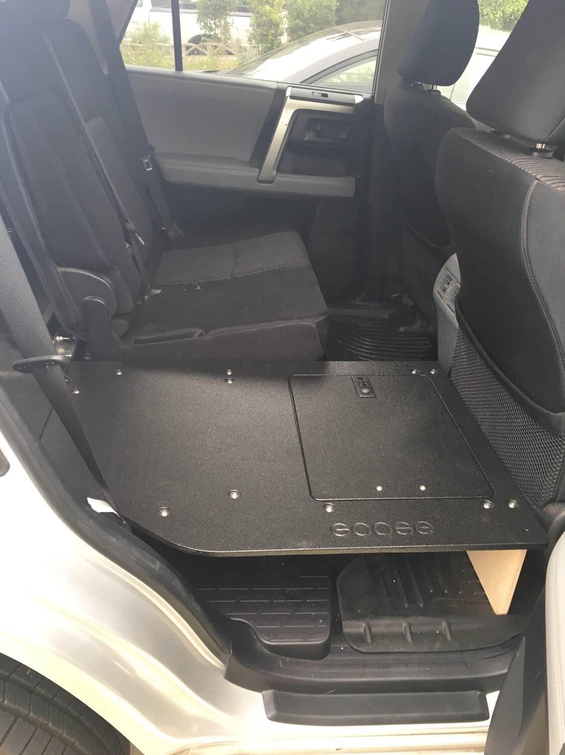

Updated pics: got the 40% (passenger side) installed. Will most likely make another panel to fill in the gap below the plate.
Pardon the dirt—hauled around a bunch of dive gear and tracked some back in...IMG_1094.JPGIMG_1096.JPG

I know it has been a log time since you originally posted this but am about to pull the trigger on the same plate you installed for the 3rd row delete. I wanted to know first though if the plate sat flat, without any downward slope from the front to back (closest to the rear)? Thanks for the pics and information. Gave me some confidence and direction for this project.

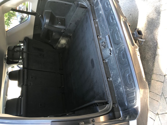

Hey guys, I know this is a old thread but I've been searching for info.
I finally completed the 3rd row seat delete on my 5th gen runner. I couldn't justify paying for the aftermarket kits. I used 1/2 plywood for the base. I painted it flat black but will probably cover it with automotive carpet or grip paint. The base plate ends up being 42''x42''. I added the sides to hide the openings left by the seat panels. In my opinion the 3rd row seat is only useful for young children. You gain loads more space with the delete. I also used foam tape on the underside of the panel where it meets high spots on the trucks floor.

If you are only doing the 3rd row delete my base plate perfectly flat. I trimmed the plastic retainer clips for a wiring harness and its perfectly level.
