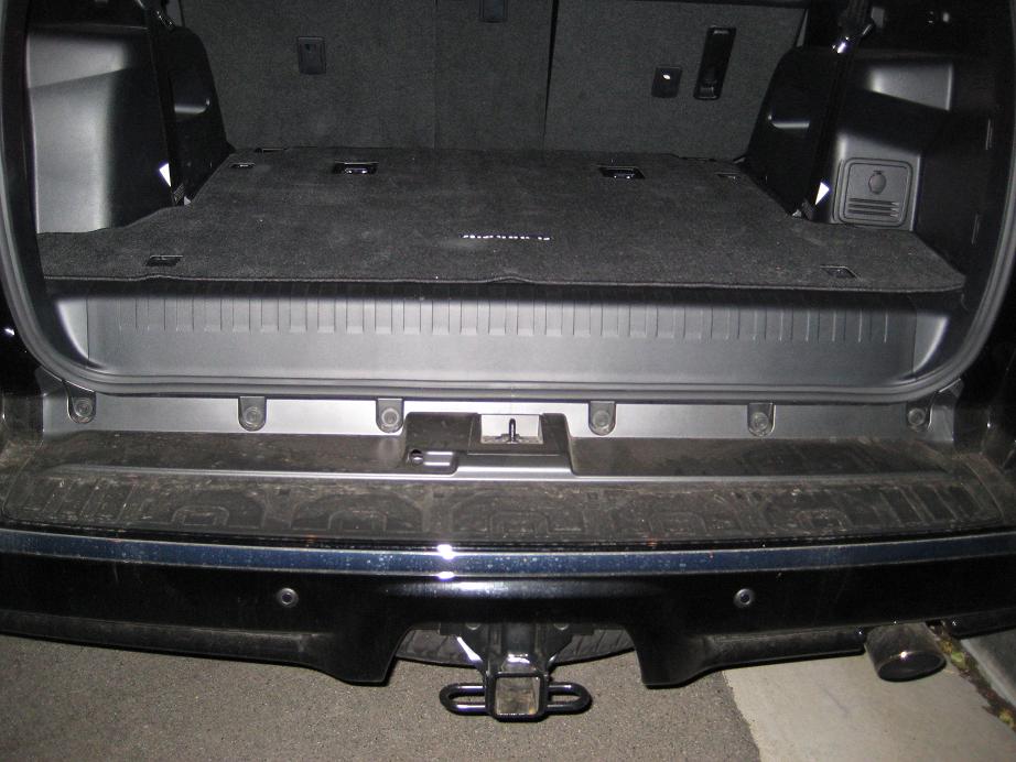

I have the 3rd row as well but do use it for my kids' friends now and then. I think removing them would be a pain in the a$$. For those who don't have them, the cargo floor is about 5 inches higher than the bumper. I looks integrated pretty good. The bummer thing too is the bottom of the 2nd row doesn't flip up, the back just fold down on them so it very shallow and ramps up a bit like Bigsp mentioned. Good luck, I am sure it can be done.

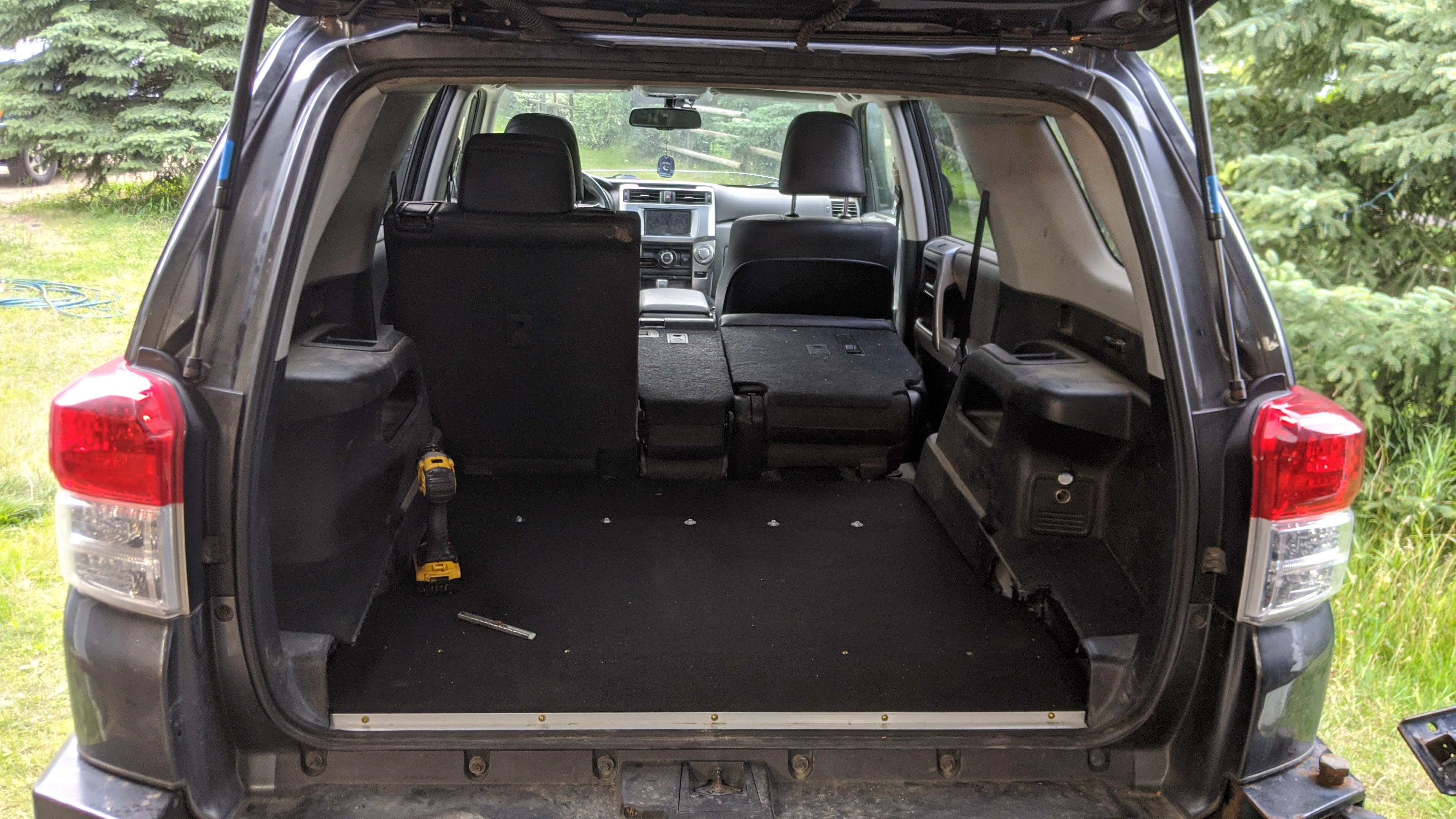

I left my stock 3rs row side panels in, you'd have to look pretty closely to notice the gaps, but my drawers occupy most of the space, and I did start from a flat, black platform.
Post platform, pre-drawer:
