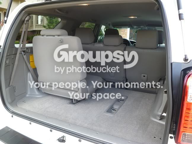

No, it's not hard to remove them at all. Just flip them forward and either fold them against the sides of the cargo area, or pop them out and store them.

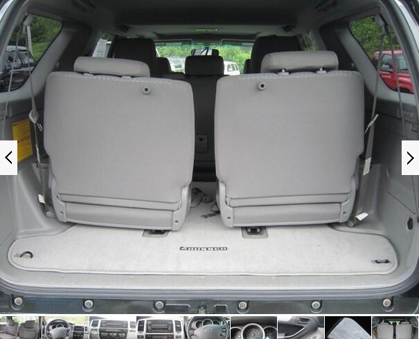

So what's happening here? Why is the left seat sitting on a funny angle?
I want to check out this vehicle that's for sale on the weekend, but this internet picture is bothering me. I'm wondering if something is broken or if it's just not fully in position or something??
They didn't take the two extra seconds to unfold the latch to the floor. The seats don't just fold down there is a mechanical connection to the floor as well.
