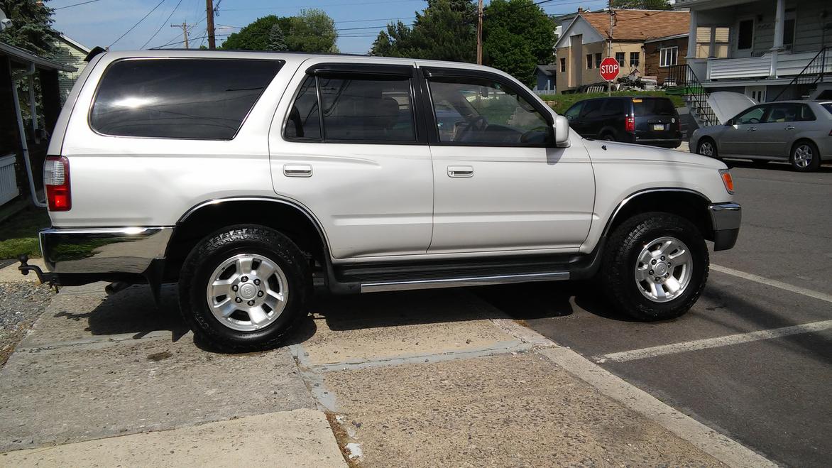

(The pic has rear on sidewalk may be slightly higher in pic, it surely sags now even empty)

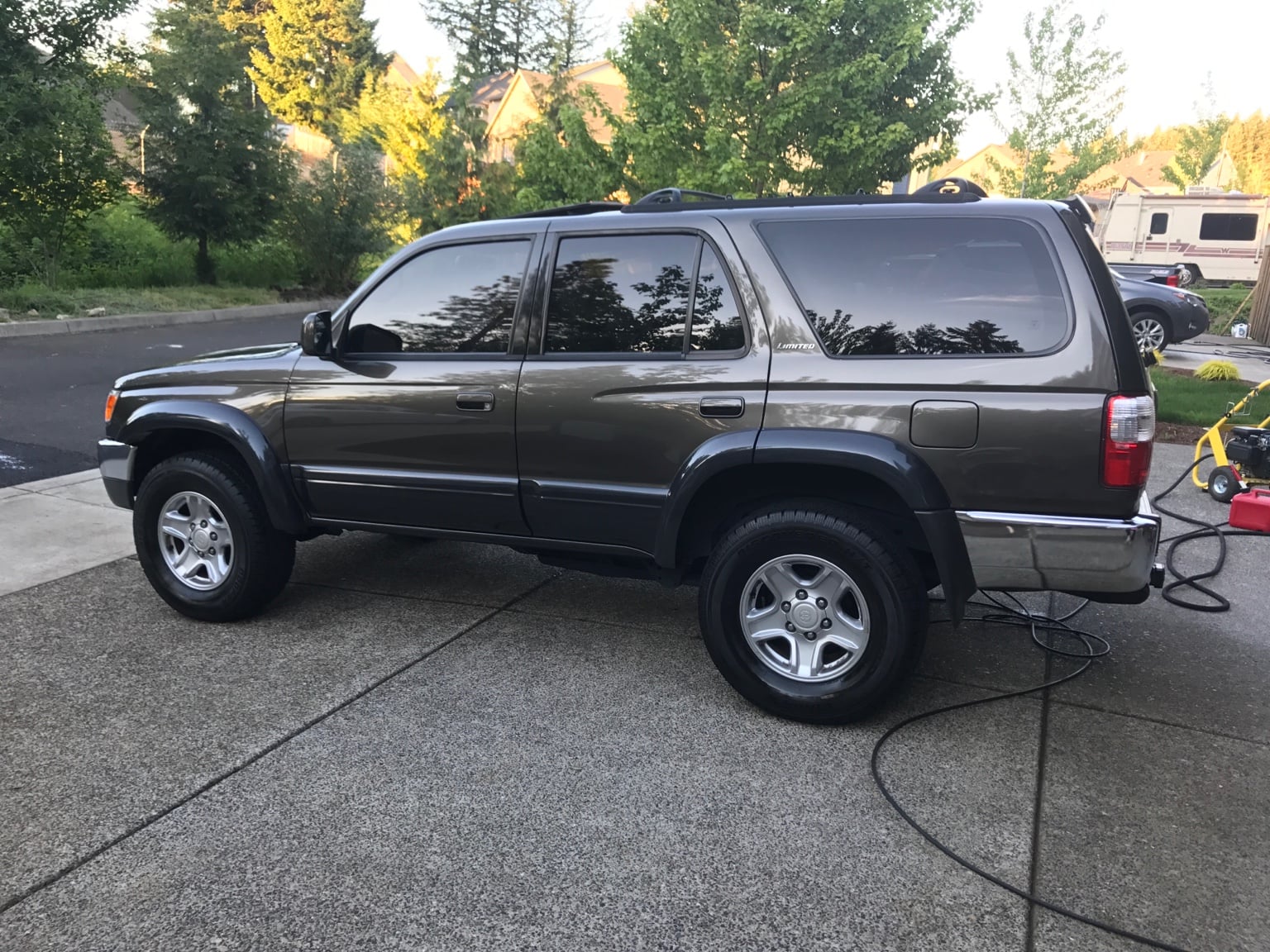

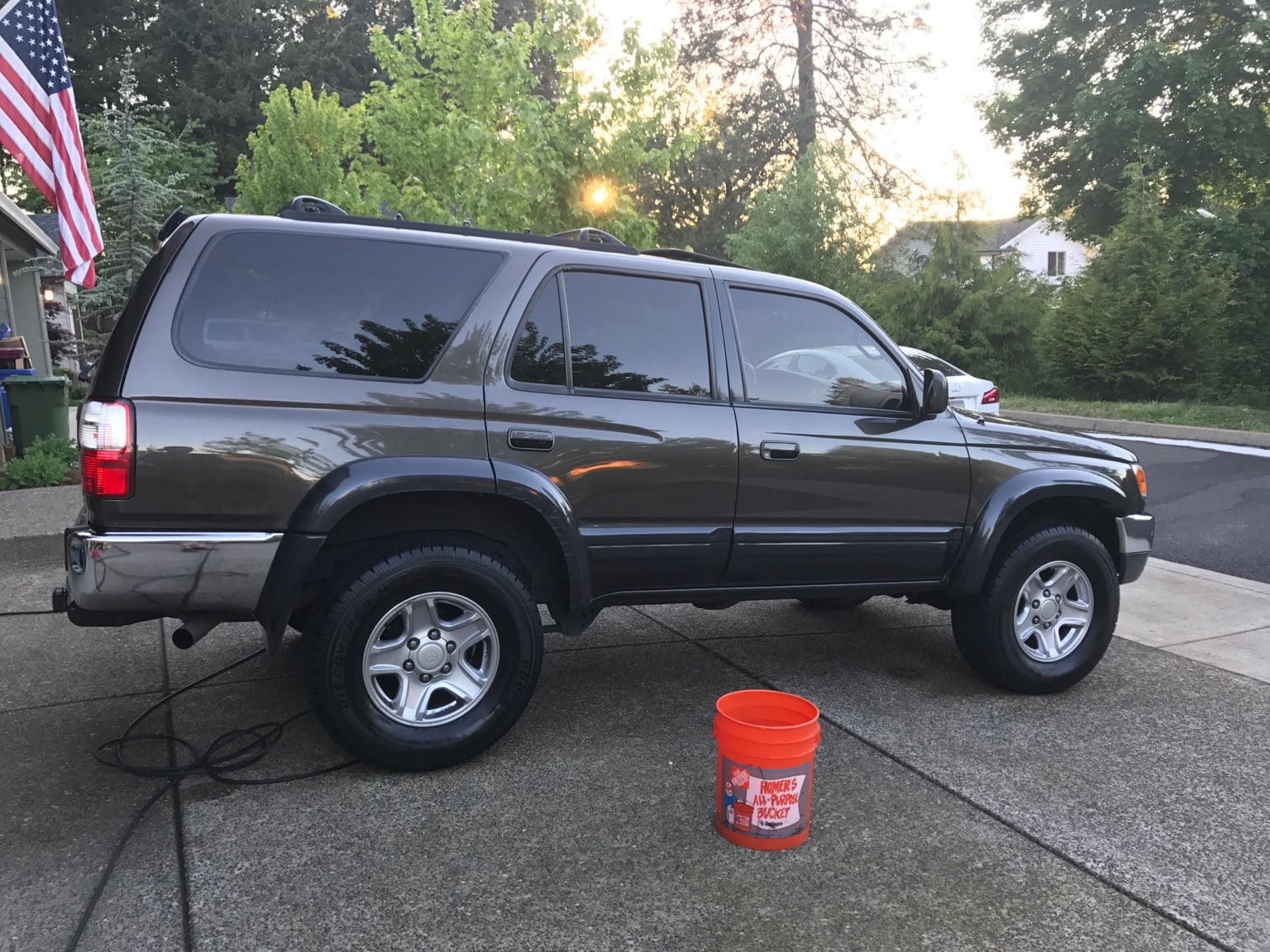

I love the 5th gen 4Runner rear coils for stock-height rigs. They are a higher spring rate, and provide a VERY nice ride and handle awesome. Paired with the OEM Tokico black, I couldn't be happier. The nice thing about them is that you can almost always find them cheap on your local Craigslist, and likely with real low miles.
Here's my '97 with 2014 SR5 rear coils and factory 222k mile 2001 front coils-

Sweet setup. Thanks for the reply.
More info on the rear shocks?
Thanks
Thanks, it really is the ticket.
I am running the stock Tokico black shocks from the 2001 I bought. Did I say I love the setup? [emoji23]
I honestly rally my rig hard(different than abusing it, and I also keep up with maintenance), and it handles REALLY well for what it is. I have the panhard bar raised up 2" on the axle-side, so that helps with lessening body roll as well.
A lady test drove it last night, and she wasn't very knowledgeable when it came to cars- at all. Even still, on the test drive, she mentioned how "it feels like it has a lot less sway than other 4Runners" she has test driven. That wasn't instigated by me whatsoever, so I thought that was pretty impressive.
