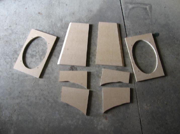

Here's the pieces I cut out of 1/2" MDF, after using cardboard to get the proper curves. Notice I bevel cut the bottom of the largest pieces, so they would sit a little more flush to the side of the wheel well (you'll see what I mean later)

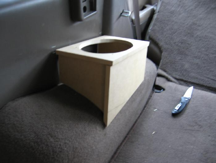

Here's a mock up of the box after I screwed it together. Remeber to counter-sink those screws, you're working with MDF!

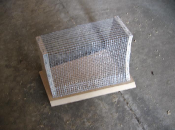

This is the box with some hardware cloth wrapped around the bottom and one side. This is for a base to build the fibreglass on. In retrospect, I would use a t-shirt instead, it would just be easier to work with, and it's stretchy.

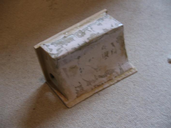

Here's the box after a couple of coats of glass. I know you guys that do body work are probably rolling on the ground, but the way I figured it, it didn't matter if it was smooth or looked good (or even if I sanded through the top coat in some areas), just as long as it was strong. It was. I just hate working with that sticky crap, so I was happy to leave the box as is at this stage.

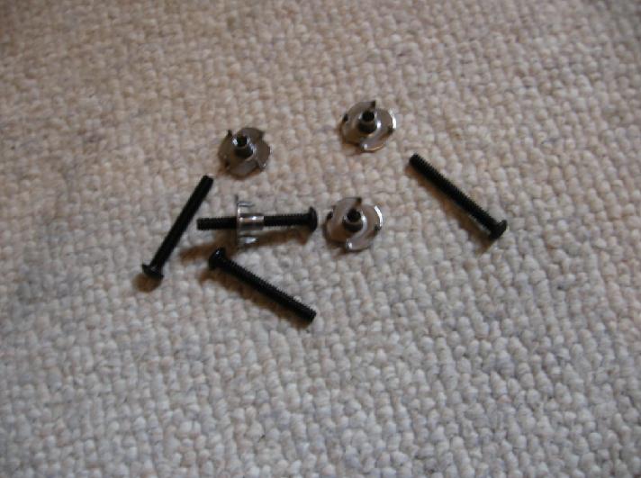

Just a note to those who have never used these fasteners. They're called t-nuts, and they're 100x better than regular screws. I used these to mount the speaker to the baffle. They're basically bolted in, you can't put them too tight (reasonably) and you never have to worry about stripping the MDF. They're great if you remove the speaker down the line and wanna reuse the holes.

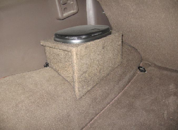

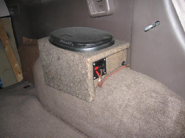

And here it is finished. After my last pics, I carpeted the whole box, and put in the speaker connectors. At first I tried using velcro on the bottom, the idea being that I could remove the boxes in a pinch. I also liked this idea, because I could put 40 extra feet of wire to each box, and when I'm camping, I could have just put the two boxes around the fire and have music. BUT, the velcro failed to hold onto the stock carpet. So instead I opted to cable tie the boxes to the carpet. This way, they're still relatively easy to remove, and I have no worries that they'll fall off.

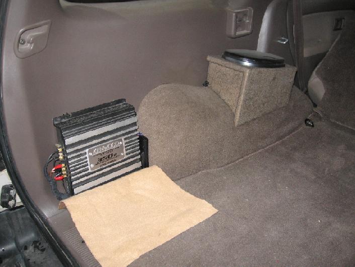

And here's the final pic of the amp and the left box. The amp is covered up w/ carpet, which velcros right onto the amp. This way I can access it whenever I please, but I'm also not advertising that I have an amp back there. Many people dont even notice it.
