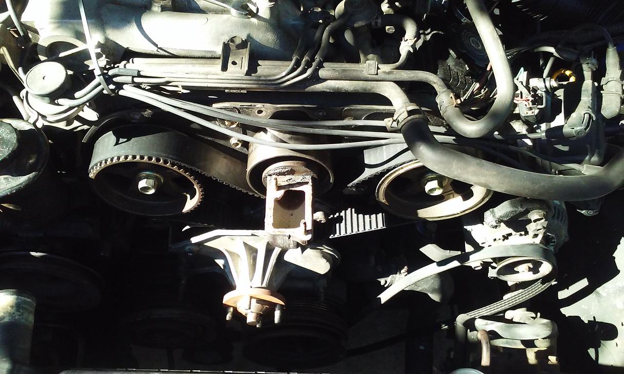

I got a 94 4 Runner V6 2 wheel drive. I change the water pump and the radiatorlast week and I can't get it running at least how it was before I started. when I pulled the water pump off of course the timing belt and the timing belt tensioner had to be tampered with so all and all after putting it back together 3x I'm at this bAugie hesitation nonsense. I have already changed plugs wires cap and rotormass air flowand one of the sensors on the right. most of my vacuum linesmy oil and tranny gasket. it was running better before I fudged with it. I'll keep up with the tread. Good luck guys n gals
