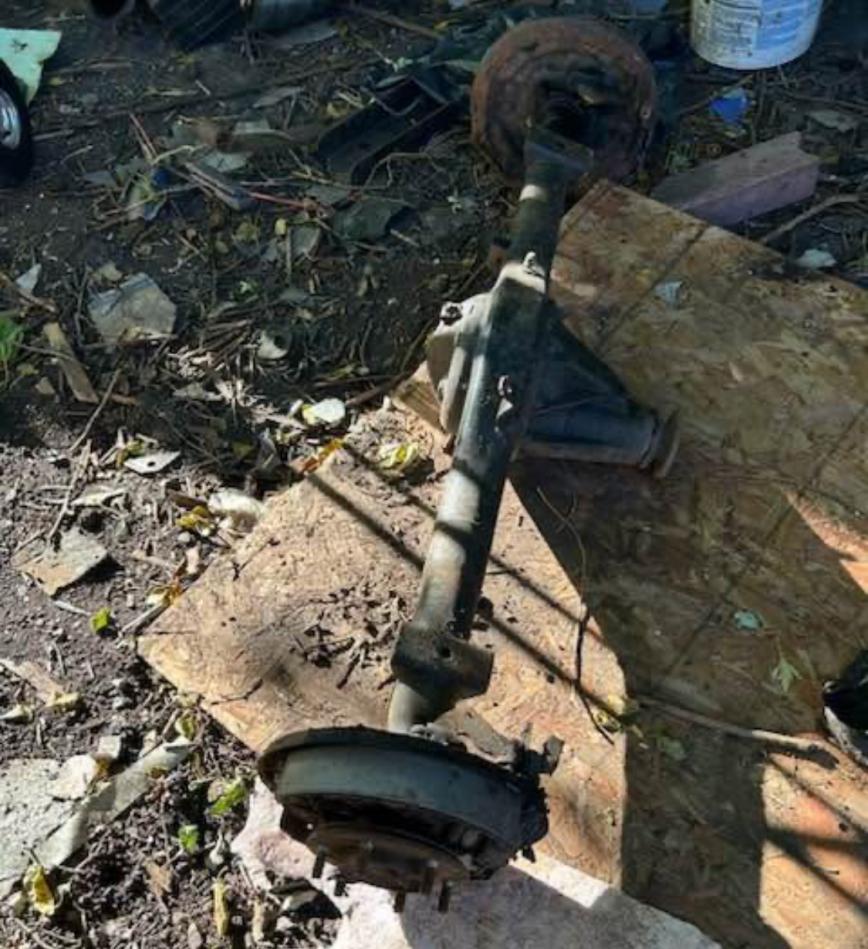

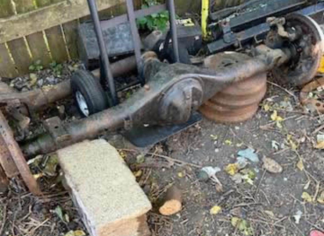

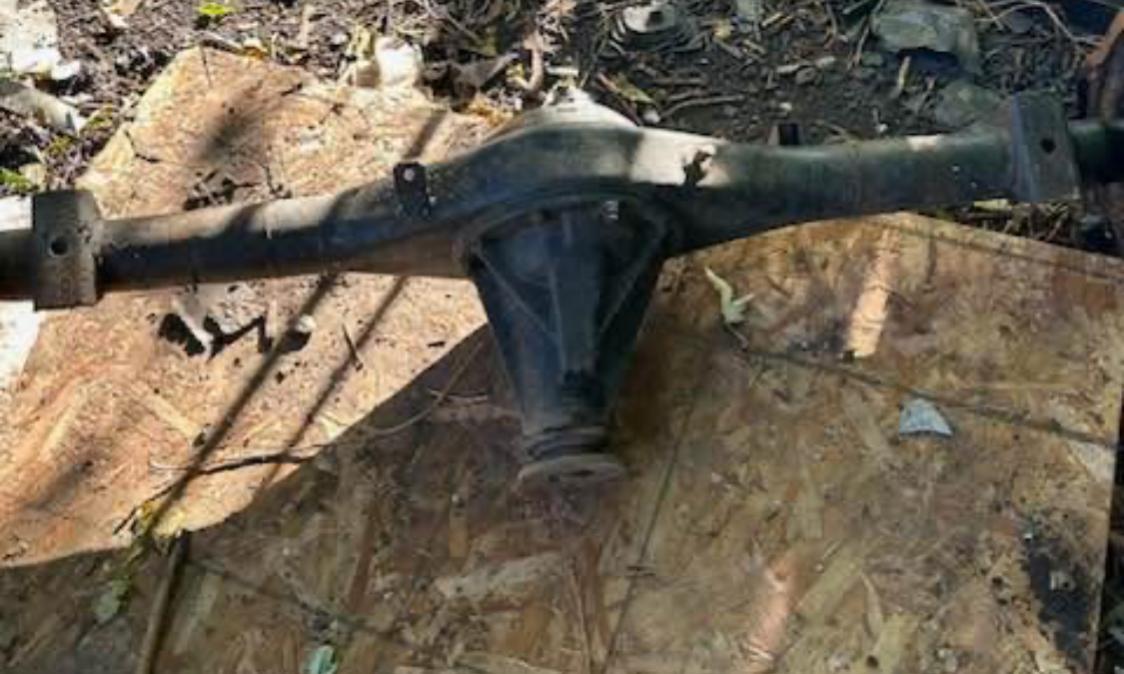

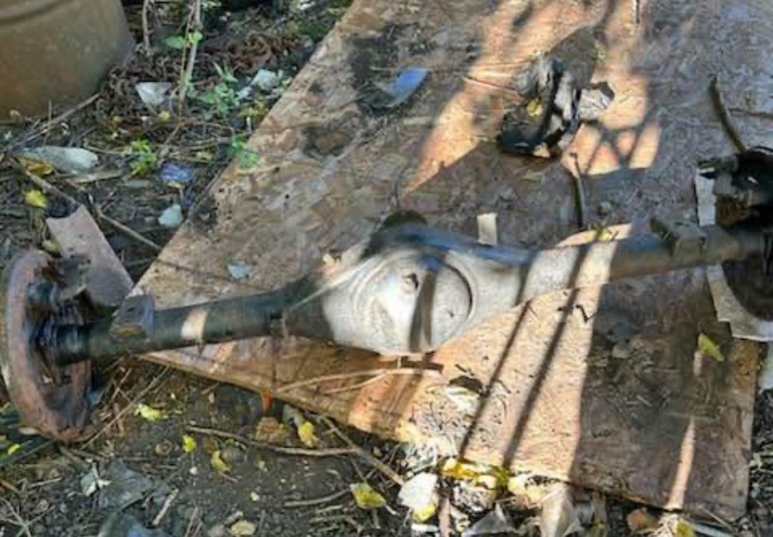

Found this setup. Guy says it’s “It’s an 8” IFS Toyota from truck or 4 runner 1986 to ? (Not sure).
Can you guys tell from images if that diff will fit into a 99 rear? It looks like the axle isn’t the same.
