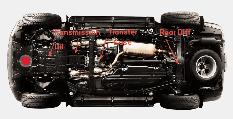

1. Can you access the pan drain without a jack or ramps...just crawling under?
2. How do I differentiate between transmission and oil drain plugs...read where some people have mixed them up and want to make sure.

Anyway, going back to OP's original questions, I was able to reach the drain bolt without jacking up the truck or removing the skid plate, but it's not exactly comfortable. I think the oil filter would make a mess on the skid plate, so it's probably easier to remove it. The bolts that hold it on are self tapping and easily stripped. Some people recommend replacing them with regular bolts (Home Depot has them) and adding some grease to the threads. I did that, and it helps a bit, but they can still be a bit difficult sometimes.
The oil pan is under the engine, and the transmission pan is under the transmission. That's not really helpful, but it's hard to explain how to identify each one. Pictures would probably help. Attached is a map of a Land Cruiser. Ours looks a little different, but the placement is similar. Hopefully I got the labels right.
