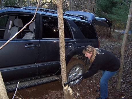

Here is an example of when to use 4low. this was my 3rda and final run up the hill. Once all the grass stuff got chruned up it was pure greese. Slid into the tree and had to cut it down to get out. Stuck the limbs under the rig for more traction. Running boards came off the next weekend. A good reason to carry recovery gear.

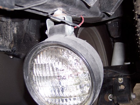

OK another flat lander! Check out this rear bumper light. I also have 2 facing to the side.
