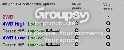

All years the same. Maybe this will be useful.

n00b question on an old thread but looking for a pretty specific answer would be great.
Looking at 4th Gen 4runner, 2006-2008 is in my price range.
I understand the Limited and the V8's have full time 4wheel drive at any speed.
I know the V6 Sport and SR5 have a switch for 4WD and you shouldn't ever switch that at speeds over 55mph
But I want to know 2 things...
-Can you make that switch at speed or do I have to stop to switch to 4wd?
-Can this be run on asphalt or does it have to be on dirt?
Basically I want something that is going to keep me going on mountain roads that are ice covered in some area's and asphalt in others without stressing my transfer case with torque buildup at speeds under 55mph
So can you run the SR5 V6 full-time at speeds under 55mph with no potential damage at all?
Thanks!
You can shift from 2H to 4H at any speed under 62mph (100km/h). Once in 4H there are no restrictions to how fast you can go. You can shift from 4H to 2H at any speed.
When the center diff is unlocked, you can run it on any surface. With the center diff locked, then it's like a part-time 4WD system and it'll be better if you're on a low traction surface to allow the wheels to slip during turns.

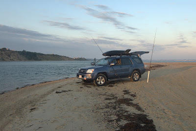

Ever since I bought my '03 new, I've spent two weeks each year on the sand at the beach. I air down to 15 psi and have never even come close to getting stuck. I lock the center diff before heading out onto the beach. I've done it in 4WD hi and 4WD low. I don't see the problem:

Yes. I drive my 4Runner with a locked center diff each time I drive out on the beach. Can't say as I see the need for a locking front or rear diff on sand, other than to just dig yourself in deeper.
I'm not talking about wet, compact beach sand though.
Not everywhere on the beach is wet and compact like the sand seen in that picture. Plenty of it is soft and dry.
