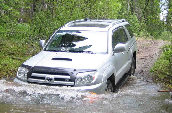

I appologize for being such a geek. But I chose 6000K Pilot brand HID Hi and Low beam bulb replacements (9005, & 9006) for my '04 V8 sport.
Fog light bulb replacement and Vision-X 6500 55W Euro pattern HID bracket mounted lights are next. I'm told by the manufacturer that these won't be available until May or so, 2008.
