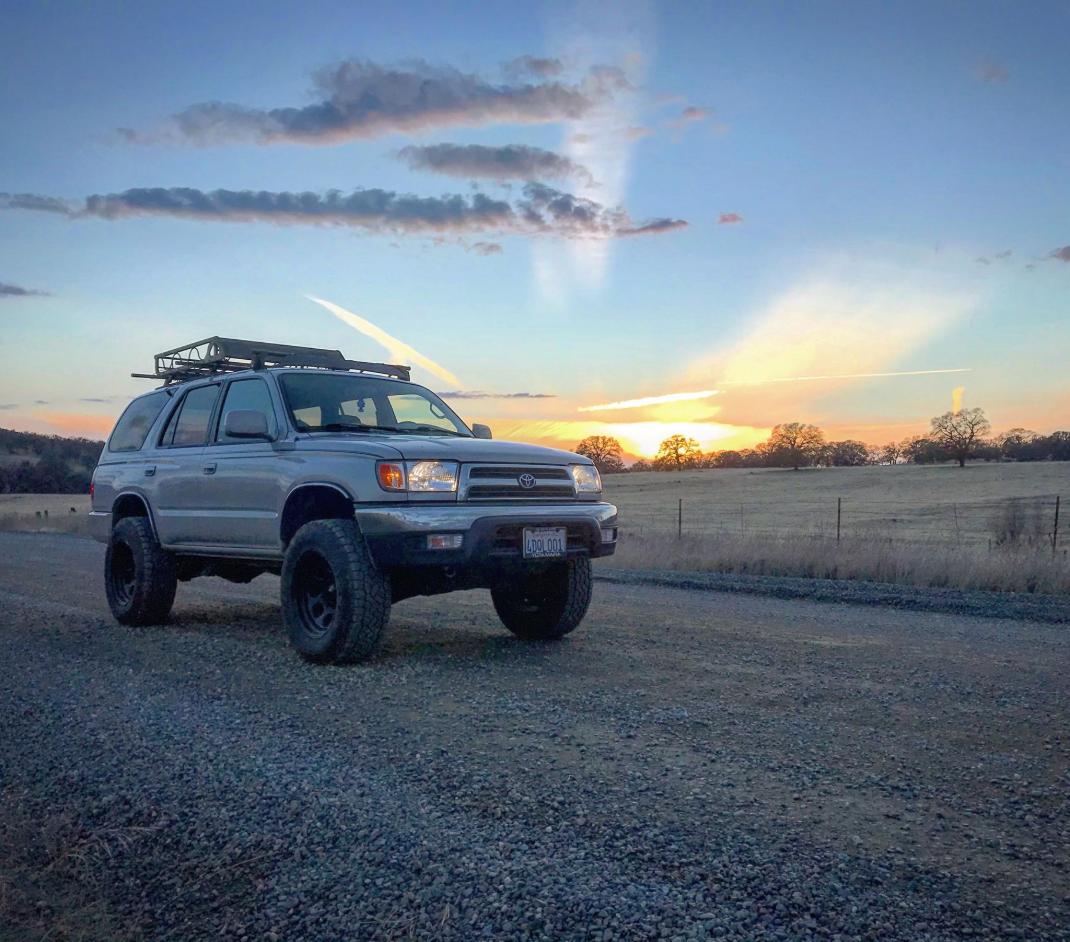

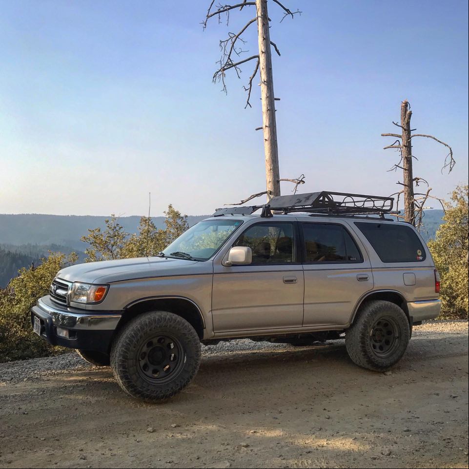

My main goals with this truck are a reliable but capable daily driver. Strong offroad capability without sacrificing too much comfort or drive-ability. Mild lift, rear locker, bumpers, sliders to begin.
The day I bought it. Last pic is after its first offroad trip:

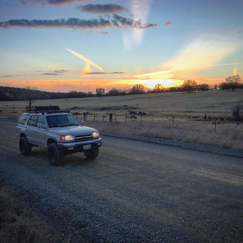

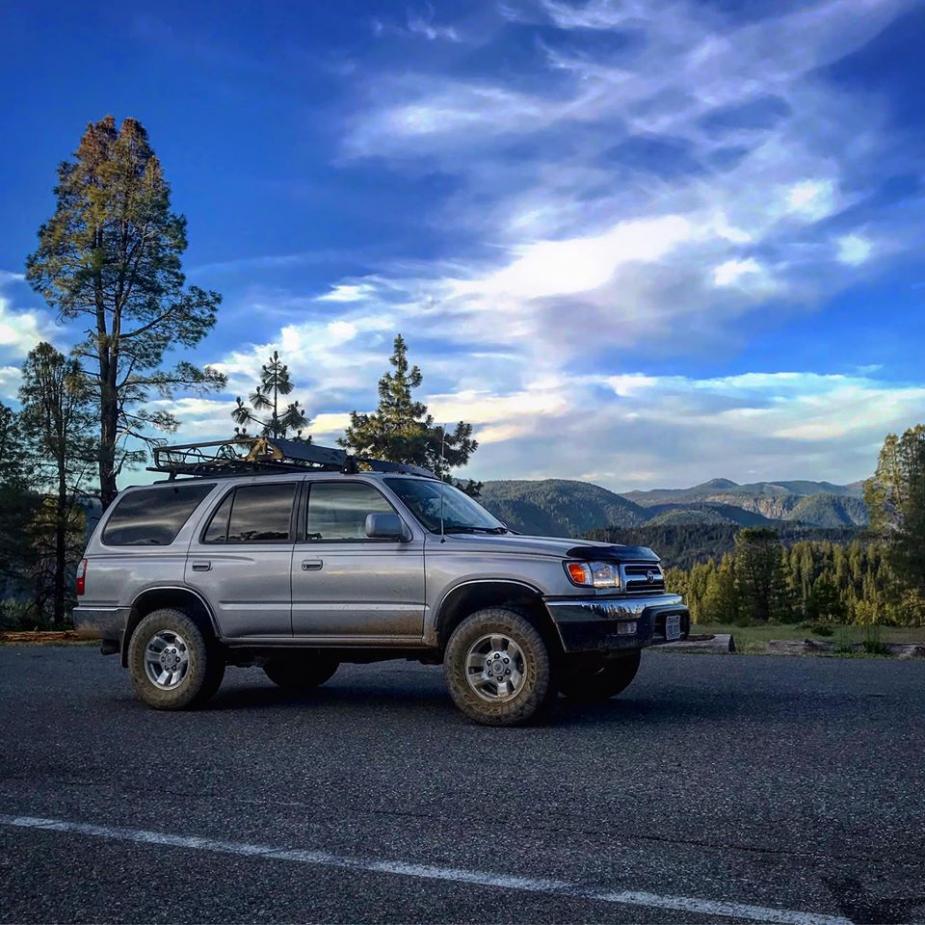

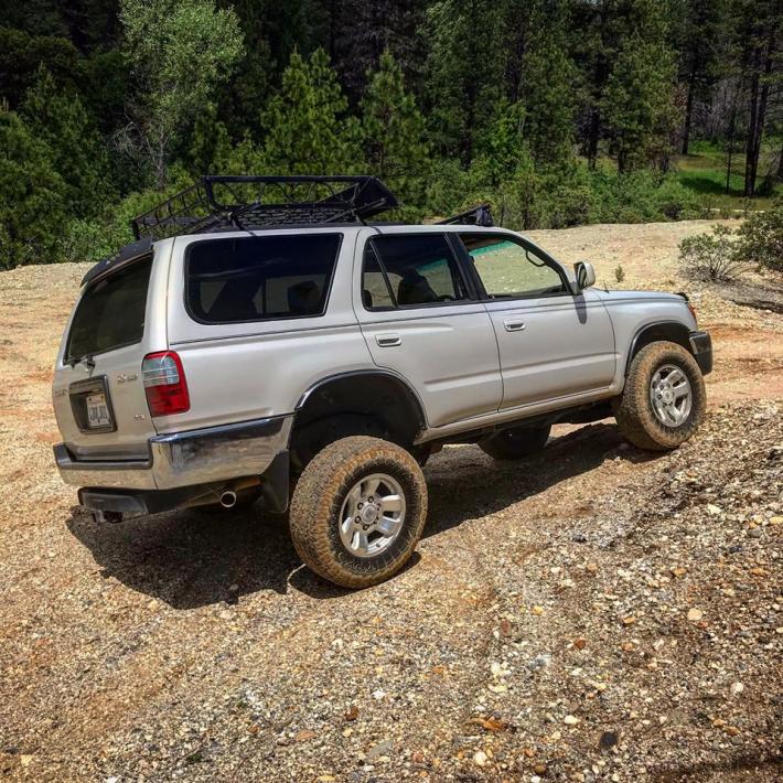

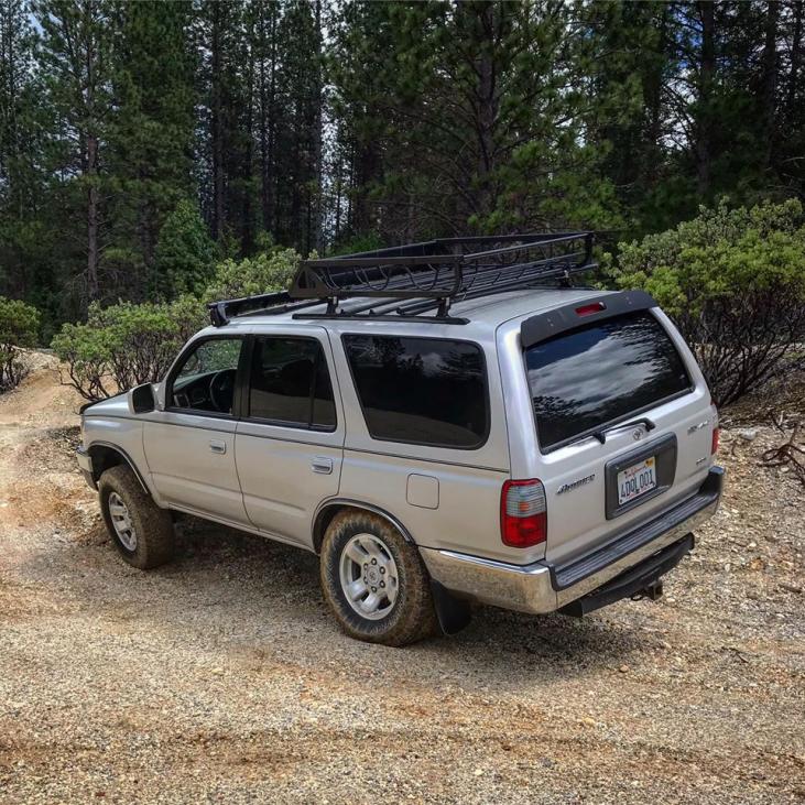

After the initial run of new parts and maintenance, I just drove it for a while. Enjoyed some mild off roading. After driving cars the last decade or so I was impressed with how good this thing does stock without a locker. I have a 87 Audi 5000 AWD and ran Bridgestone Blizzaks on my Crown Vics to deal with snow. So maybe I got used to having to work hard to get around in winter? :suspicious:
Either way the move from cars to 4runner was a pleasant change. It hasn't gotten me stuck yet.
The 265x70x16 Toyo Open Country AT 2s had some decent tread but were pretty old so I started planning a new direction for the tires and wheels.

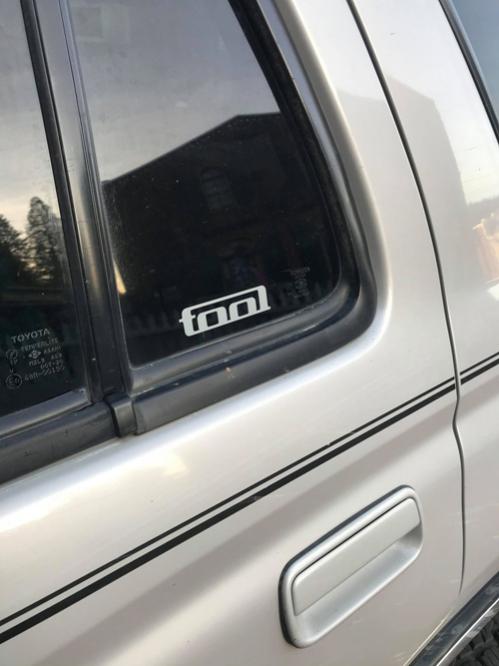

I’m assuming you’re a big Tool fan?
Yes I'm a Tool nerd haha. I was stoked earlier this year because I was finally able to go see them live again after 6 years and scored tickets to one of their shows. Then the pandemic happened. :crybaby:
This is one of the only non-parts related stickers on my truck

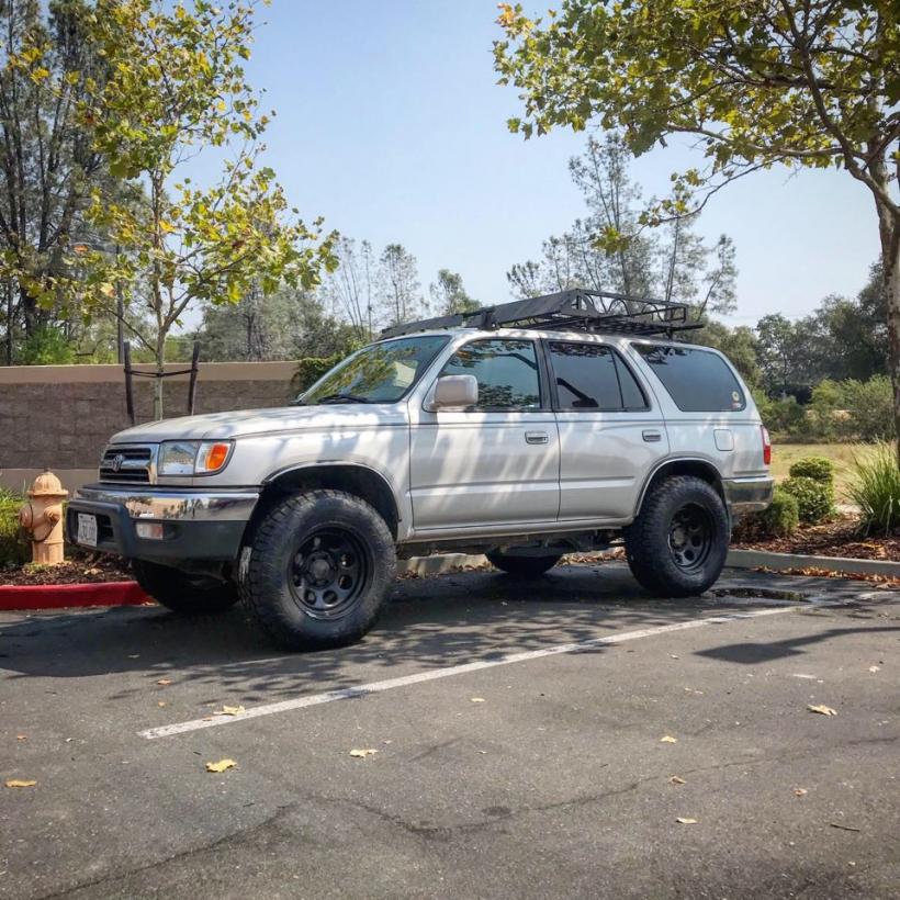

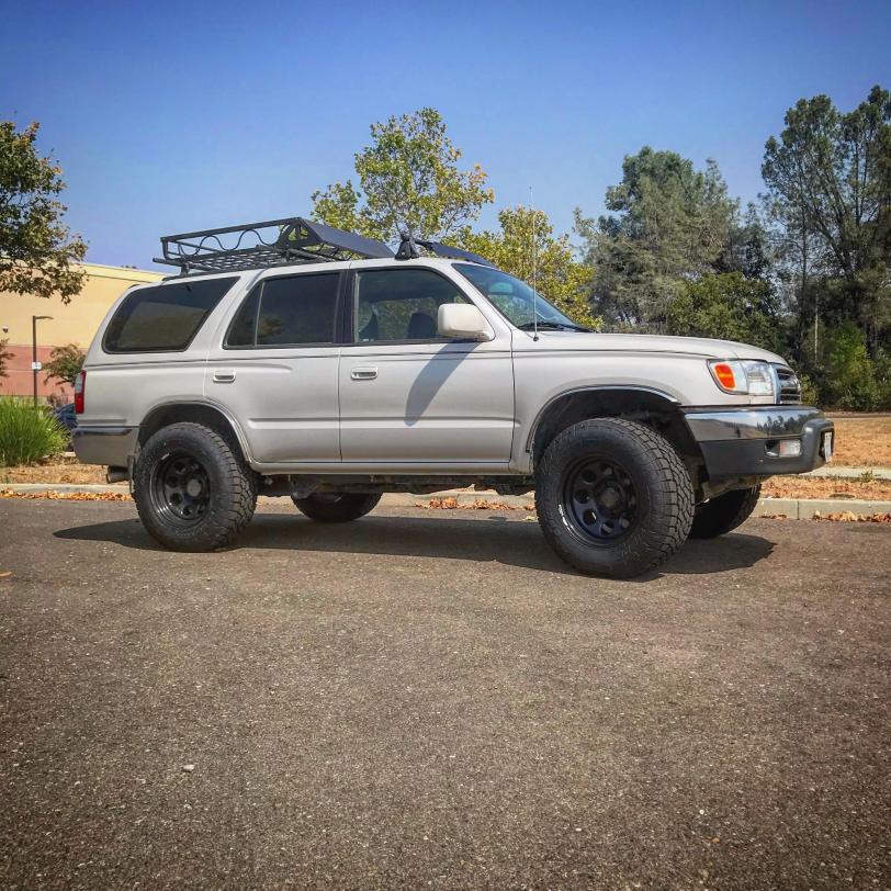

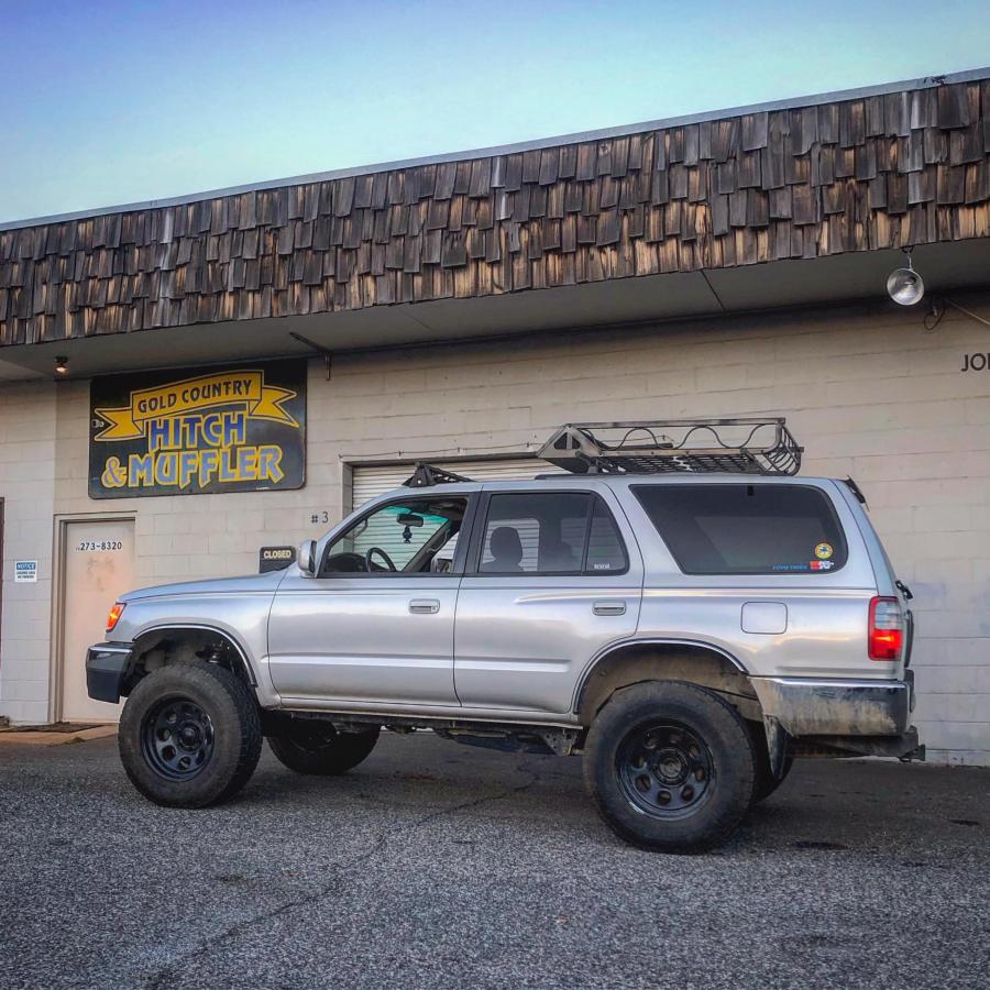

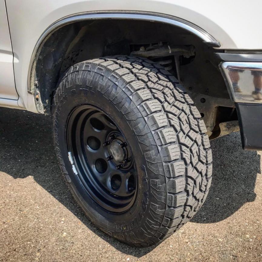

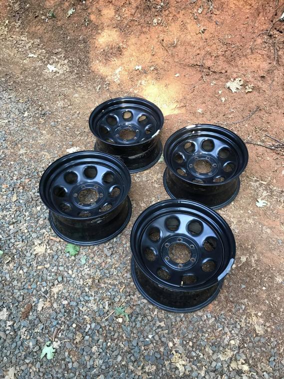

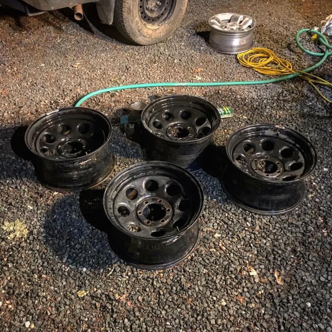

I spent a while trolling classifieds for a simple set of 16" black steel wheels with no luck. None of the local tire shops could get the ones I wanted. I eventually bought a set of Pacer 17x9s from a buddy who got them in a trade. Couldn't beat $50 for 4 wheels in good shape. They were dirty but cleaned up nice! I gave up on 16s at that point.
So I bought a new set of tires to match the larger wheels. I liked the Toyo Open Country IIs it came with, so I bought a new set of 265/70/17 Toyo Open Country III All Terrains. So far really liking these tires. Road manners are quiet and smooth and offroad they have gripped great.
I was worried the 17s would look too big or goofy but it turned out awesome.
Couple more pics. I wasn't a huge fan of the dealer installed bug guard, so I removed it.

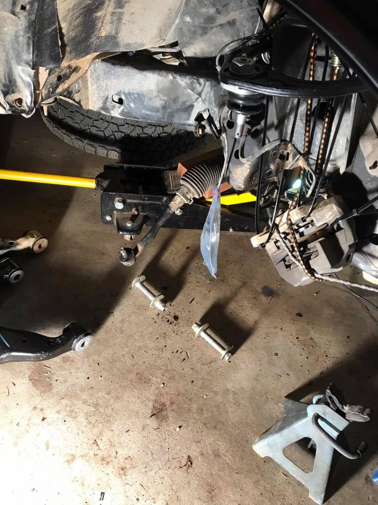

Up next was UBJ & LBJ. I started planning what else I was going to do when I did ball joints. I knew the front end needed a lot. Before I could get it all together though, I broke a passenger ball joint. :wow:
I checked the play on the BJs about 2 months prior. They seemed fine. However, the roads I drive regularly are pretty shitty. A couple days before the accident, I started to hear random intermittent creaks but couldn't quite tell where it was coming from. I now know that was the LBJ.
All things considered, I was pretty damn lucky. I was only traveling about 5-7 mph when it happened. The passenger side LBJ basically popped off the ball when I hit a deep hole in the road. It took the CV axle and a tie rod with it. Fender was damaged too, but not terribly. I was grateful that the accident didn't happen 20 or 30 minutes later, on the highway.
I was pretty far from any roadside services when it broke. Had to wait 6 hours for my buddy to drive up with a trailer to get me.
Since the truck was down hard for a minute I decided to go all out on the front & rear end.

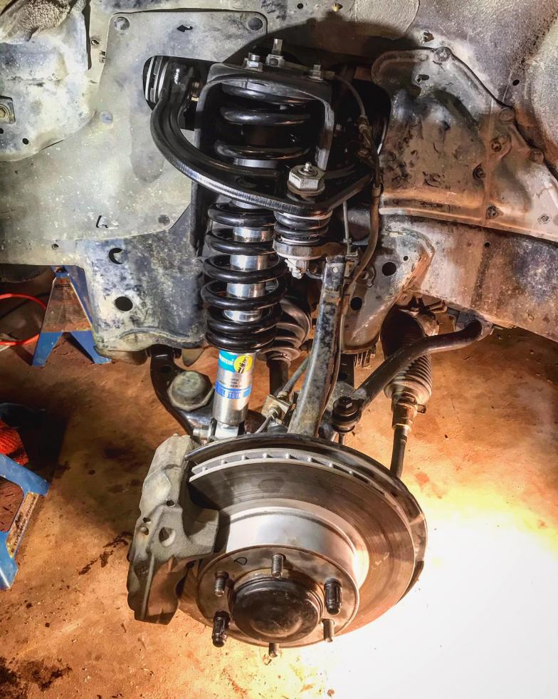

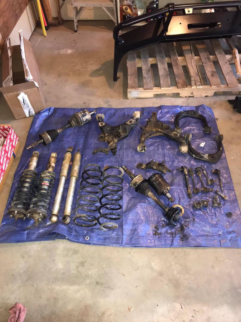

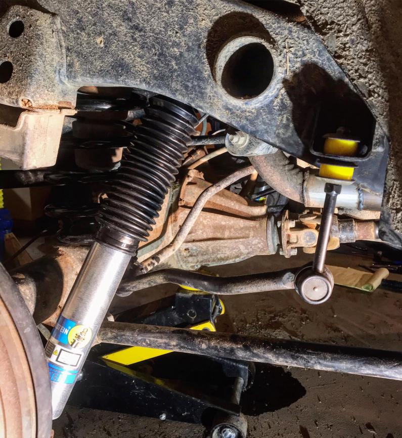

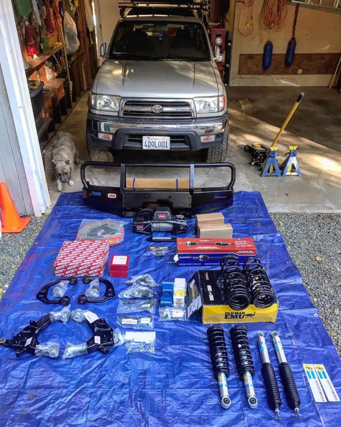

Stage 1 Build

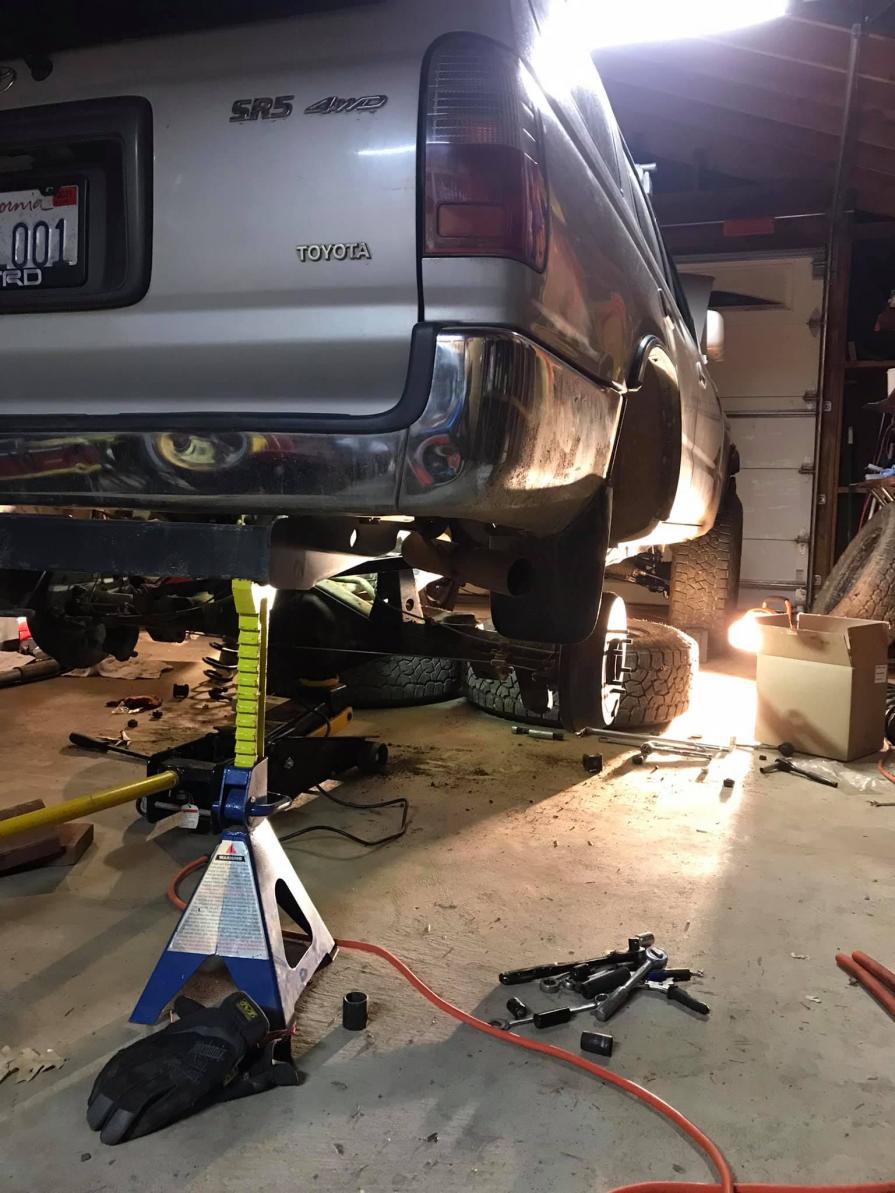

Since I was going to be tearing the front end all apart anyway, I decided it was time to go all out on the whole suspension. I had already been buying parts before the LBJ failure. But it took a while to get all the additional stuff I needed after the accident due to COVID.
After weeks of searching out and waiting for parts to arrive, I finally have everything needed to begin my "Stage 1" 4Runner build.
The basic goal is to overhaul the front and rear end, lift it and add a ARB bumper with a Warn 10,000 lb winch. I daily drive this truck, but also have to deal with some moderate offroad conditions and lots of snow in the winter. I wanted to keep it comfortable but capable. I plan to add a E locker down the road, but this is where I am starting with my 99.
Stage 1:
SPC upper control arms/bushings
SPC upper ball joints
Toyota OEM lower control arms
Toyota OEM control arm bushings
Toyota OEM lower ball joints
Bilstein 5100 shocks
Old Man Emu 883 front coils
Old man emu 890 rear coils
(2) Napa lifetime warranty CV axles
New dif seals
New outer tie rods
New sway bar links f&r
New sway bar bushings f&r
ARB bumper
Warn EVO 10 10,000 lb winch
Master pull synthetic winch line
Poison Spyder aluminum fairlead
(4) Hella 500 Offroad lights (not pictured)

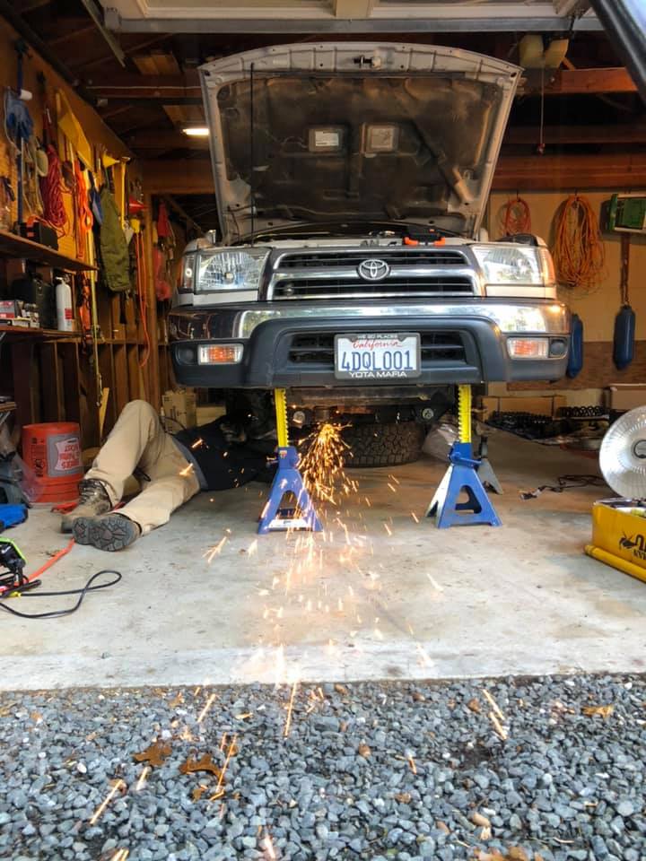

Ran into a few snags that held me up. Fed Ex lost my emergency last minute parts packages twice. Toyota sold me two left tie rods and I didn't notice until I was putting them on at 6 pm on a Saturday. There was a nut on the passenger side lower steering rack that was supposed to be welded to the frame, but wasn't. So when I tried to loosen the nut on the other side to slide out the cam bolts, it just spun. There was no way to secure it because it was tucked up inside the subframe. The nut I could access had green loctite on it and was a bear to get off even after I could secure the backside. I ended up having to cut a small hole to get a box end on it so I could get the other loctited nut off.
It felt like someone had issues here and did a "won't have to deal with this for a long time" kinda fix on it.
It took longer than expected but I finally got it done. Fixed the minor body damage from the ball joint accident as well.
As soon as my friend that welds is free we are going to install the ARB and Warn 10k winch. Weld the broken weld nut, and reweld the small hole I cut to get the wrench in.
Overall it was quite an extensive project but I learned a lot about third gens. Thankfully my awesome girlfriend was able to lend a hand and drive me around while I had this thing torn apart.
It definitely sits a bit higher now! But the ride is so smooth and nice. A thousand times better than it was before. My old suspension/steering was definitely tired. Got her aligned no issue. And now have put over 1,000 miles on the new suspension. Definitely recommend the OME and Bilstein 5100 combo. Do all your sway bar links and bushings too while you're at it. Mine were all toast.

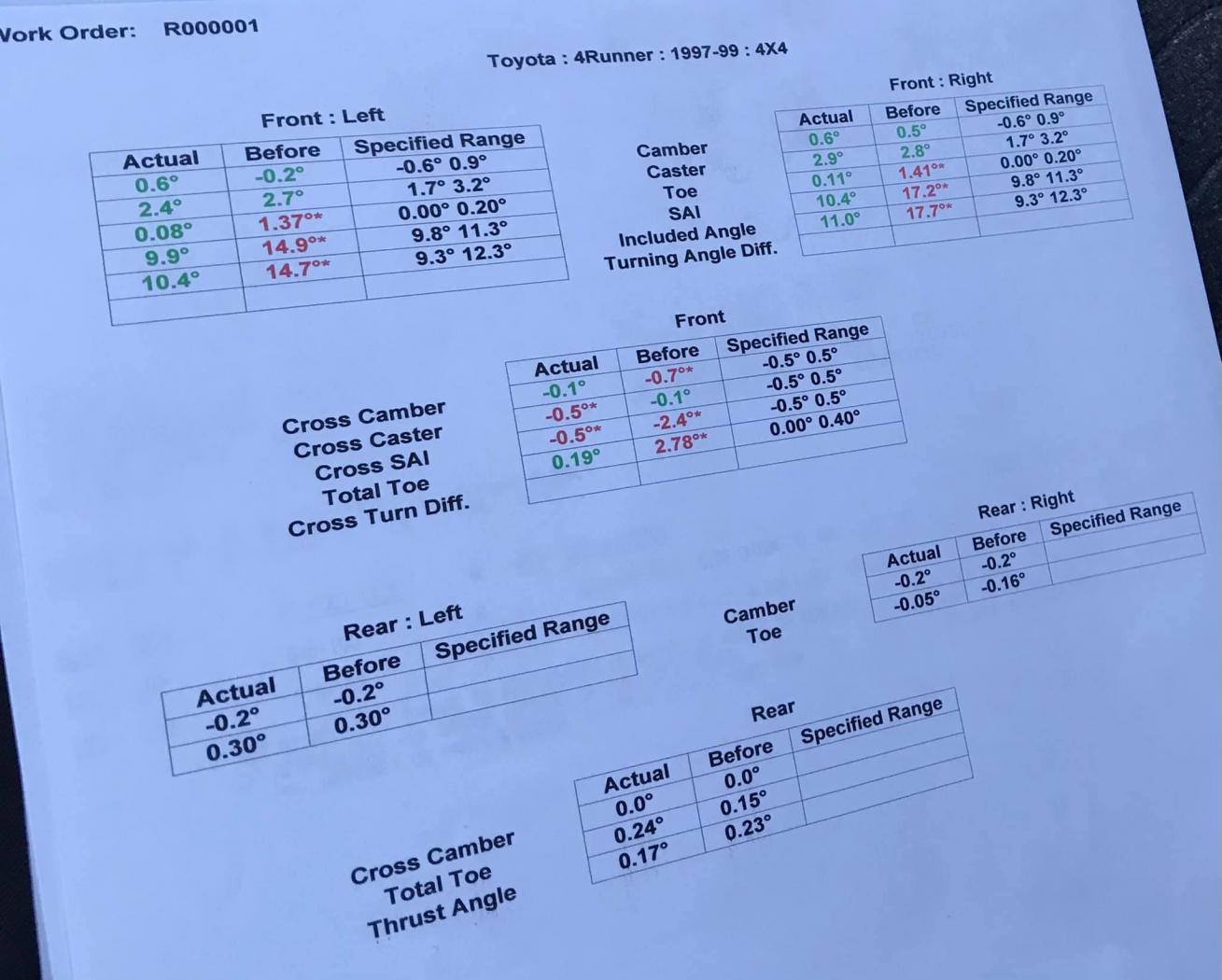

Fresh out of alignment!
