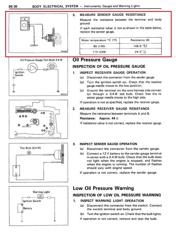

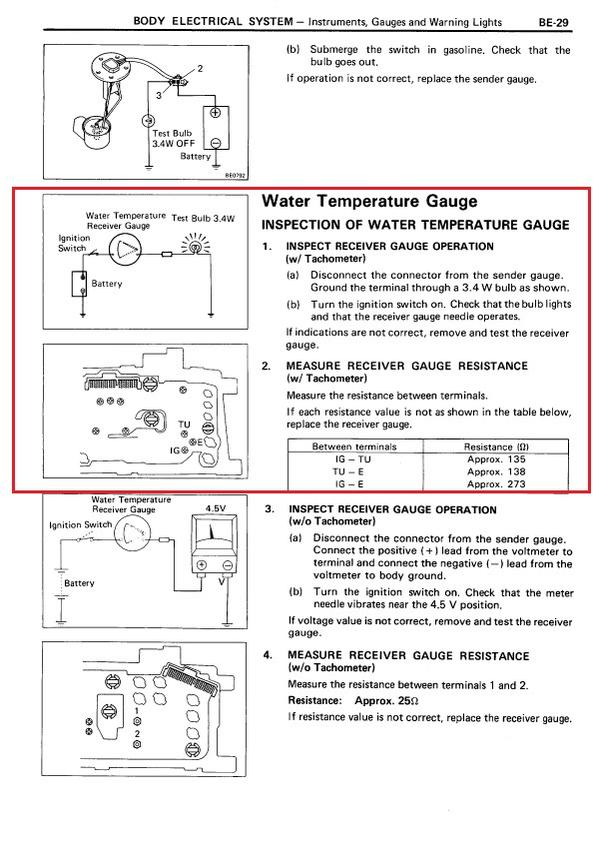

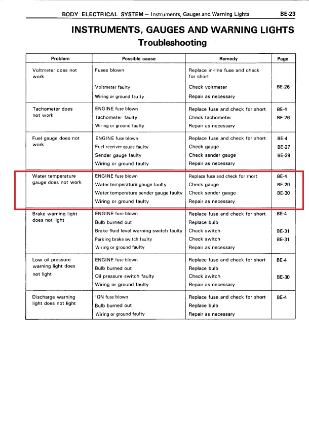

The temp gauge of my Toyota 4Runner first gen (1988 SR5 22RE, no airco, manual trans) doesn't work.
I'd like to check the temp gauge sender, the problem is, and this is the shame part, I don't know where it is.

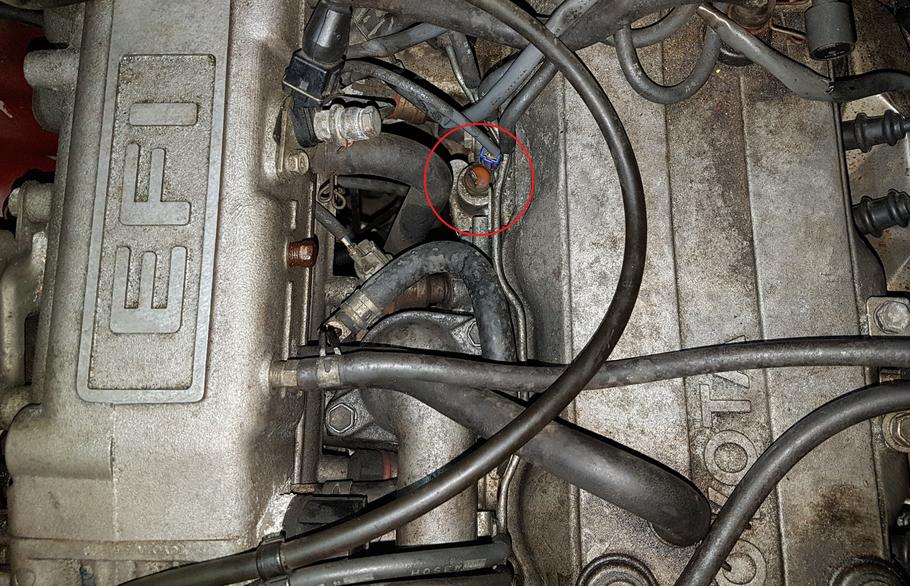

but it's not in my 4R. I think, in my case, it's the one inside the red circle (please see pic), is that correct?

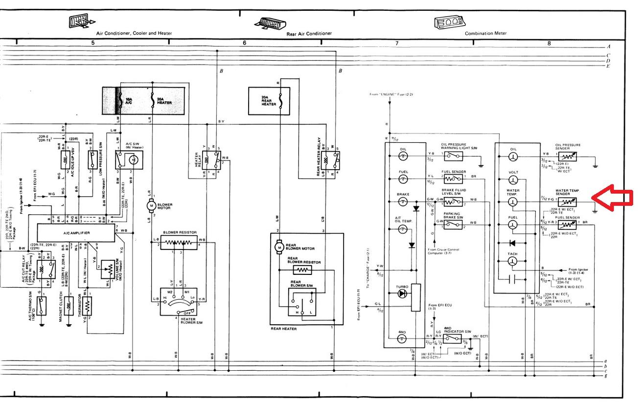

The pigtail's blue and the wire's yellow with green stripes, like the one the temp gauge receives based on the FSM electric schematic.
