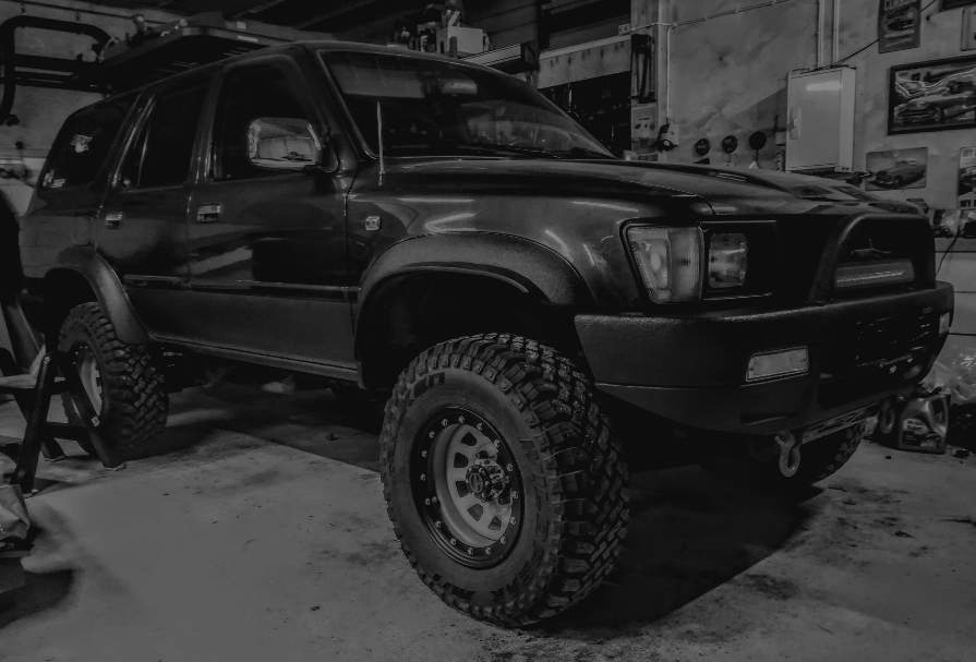

4R from North, *Accessories build time.
Some more pics.

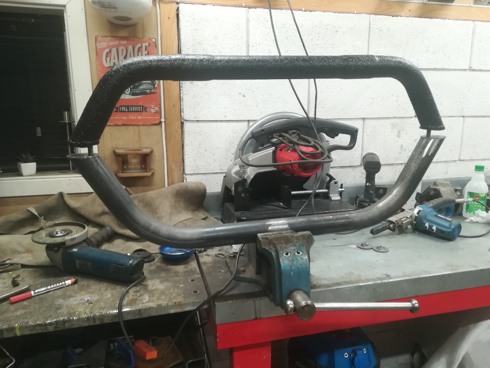

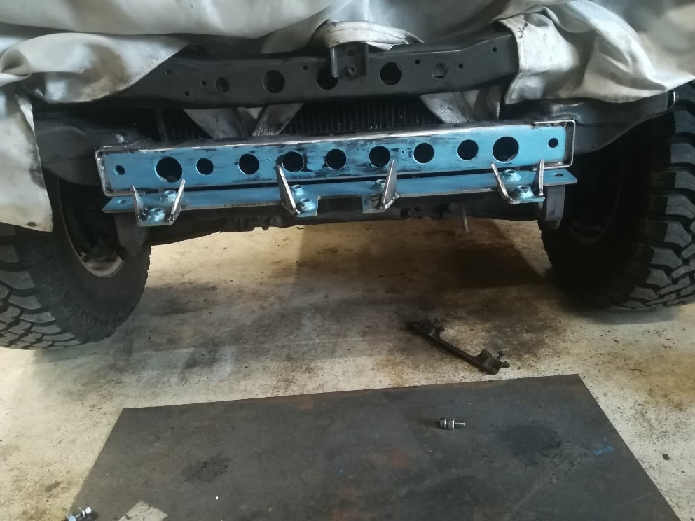

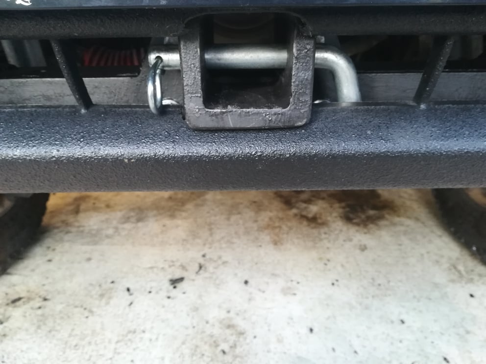

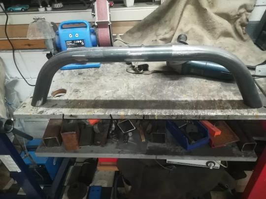

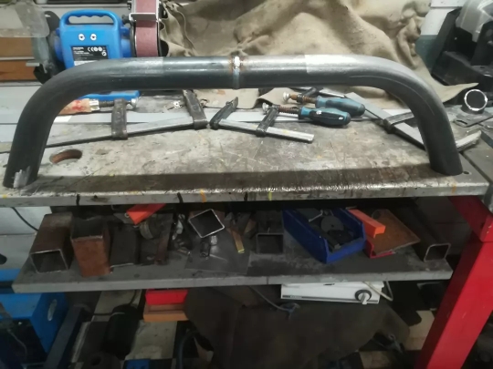

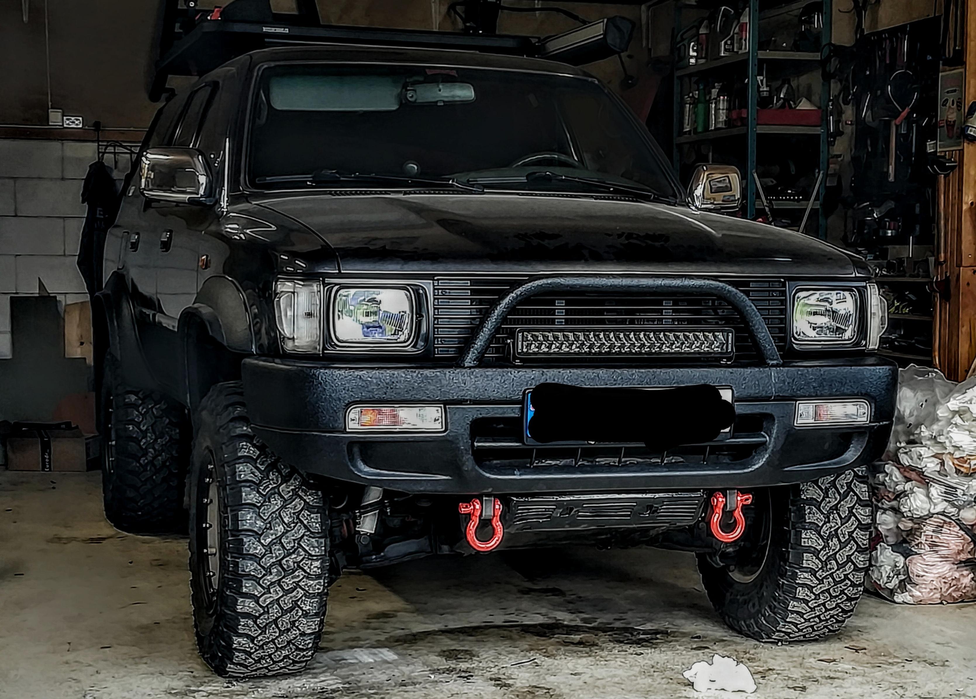

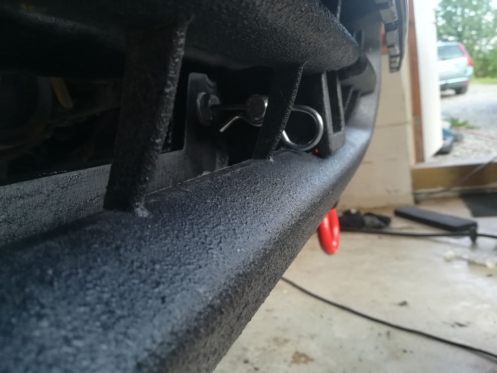

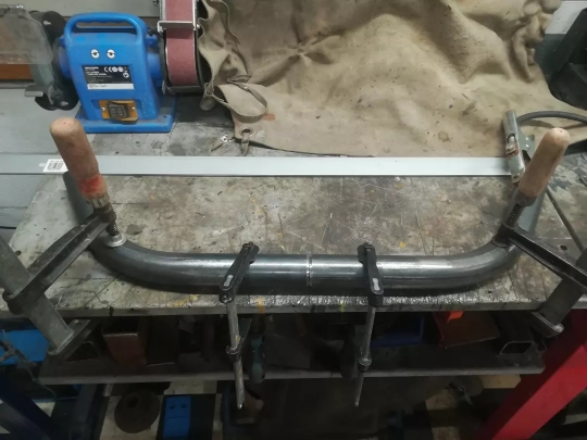

Decide to remake the small front bumper bar, that "protecting" the ledbar and grill. this time i copy the old one but made it more higher so it hide the top of the grill line more...im thinking to make a custom look on this car later and replace the headlight and grill with something else to get a more aggressive look or so.. will see.

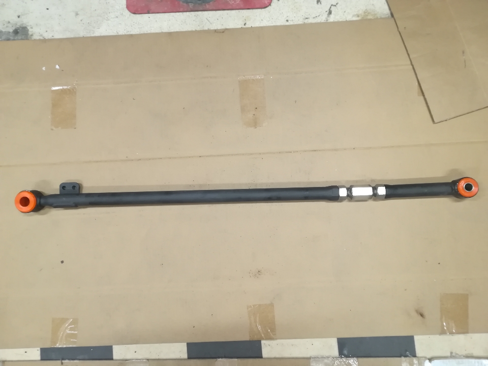

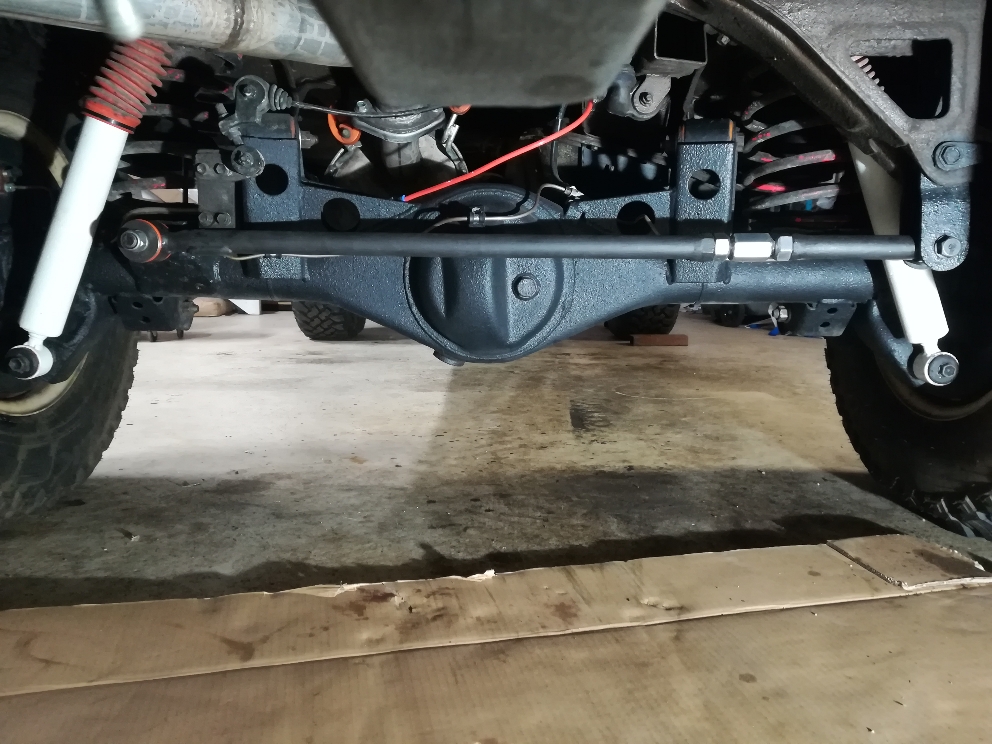

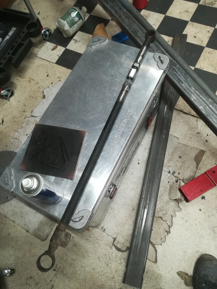

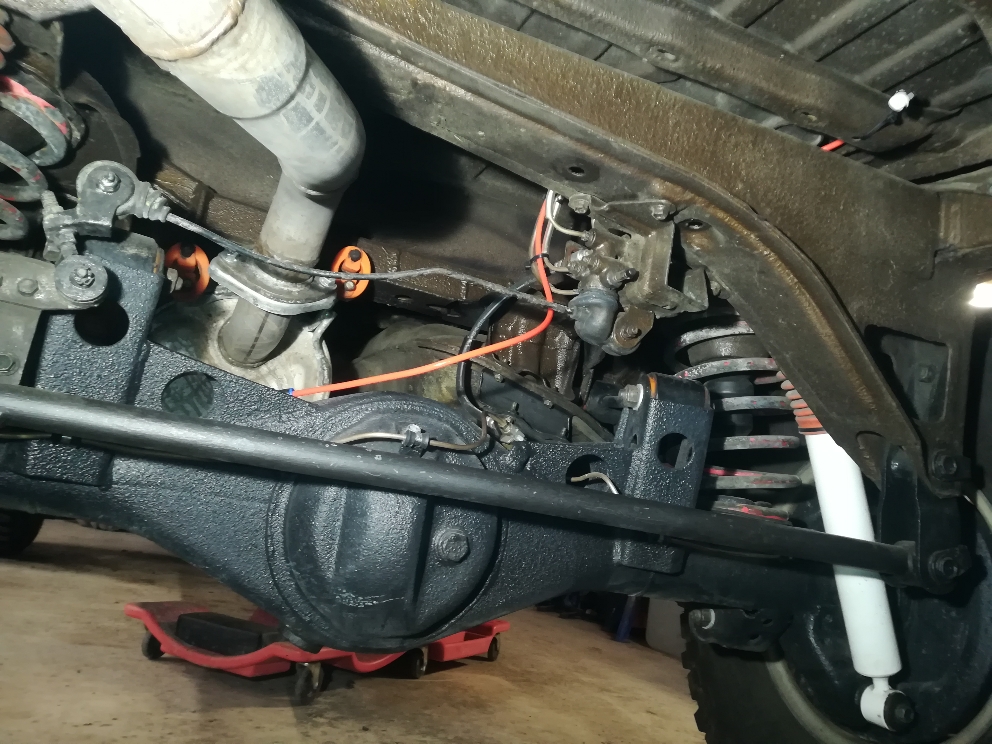

2 weeks ago i installed the new panhard bar to move the axle about 11mm to the passenger side.

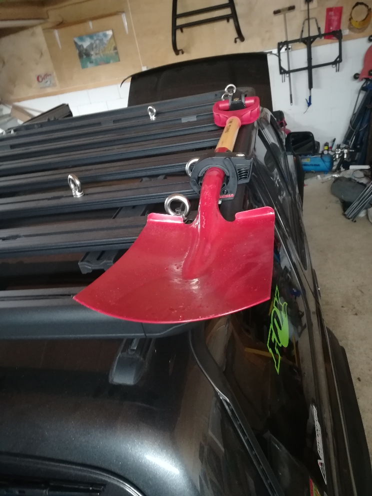

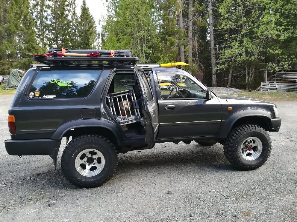

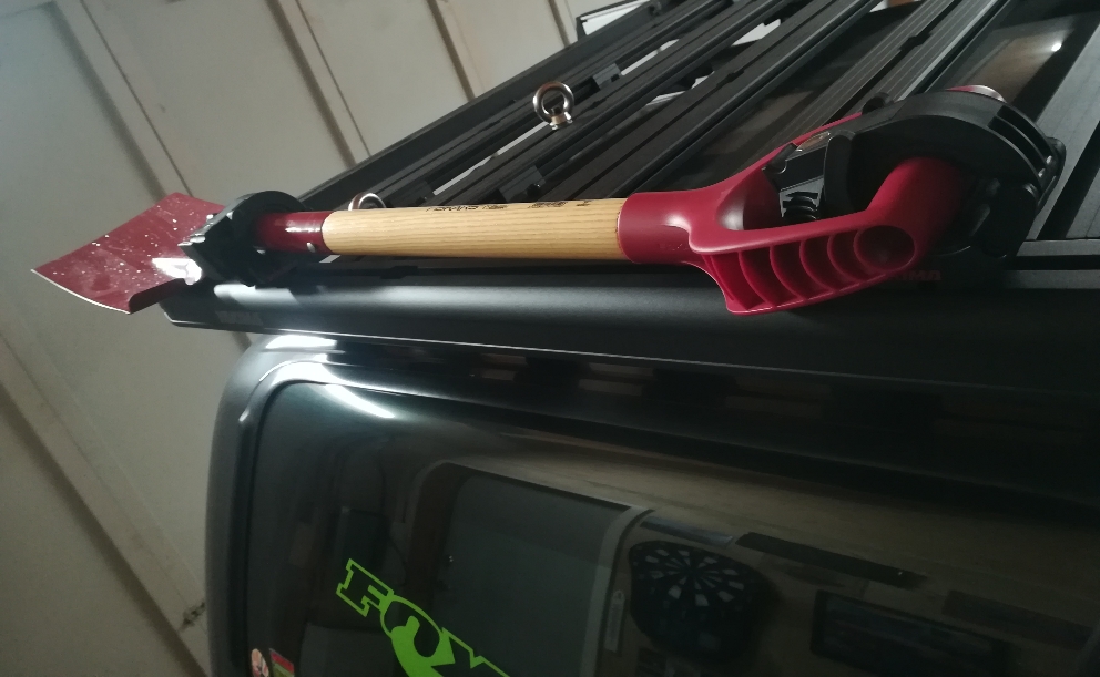

Also add some more stuff on the rack.

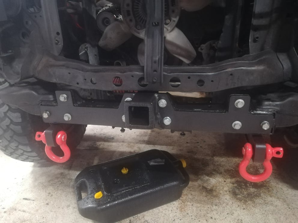

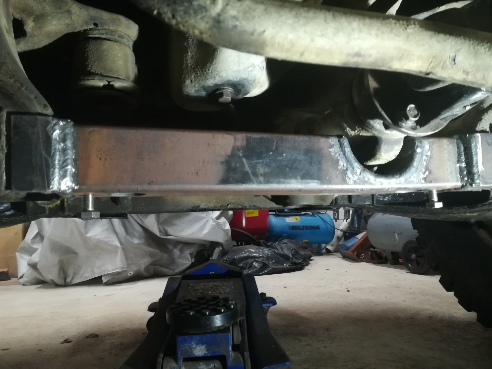

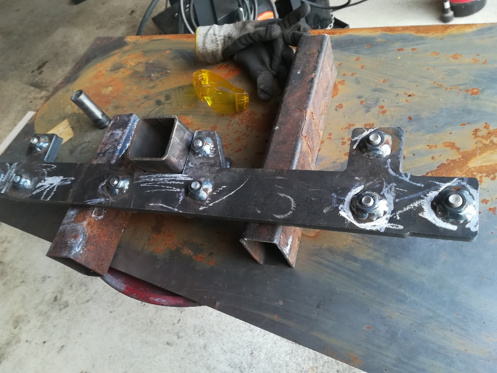

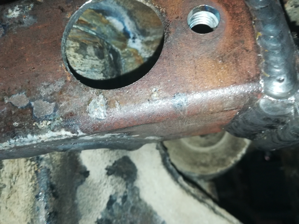

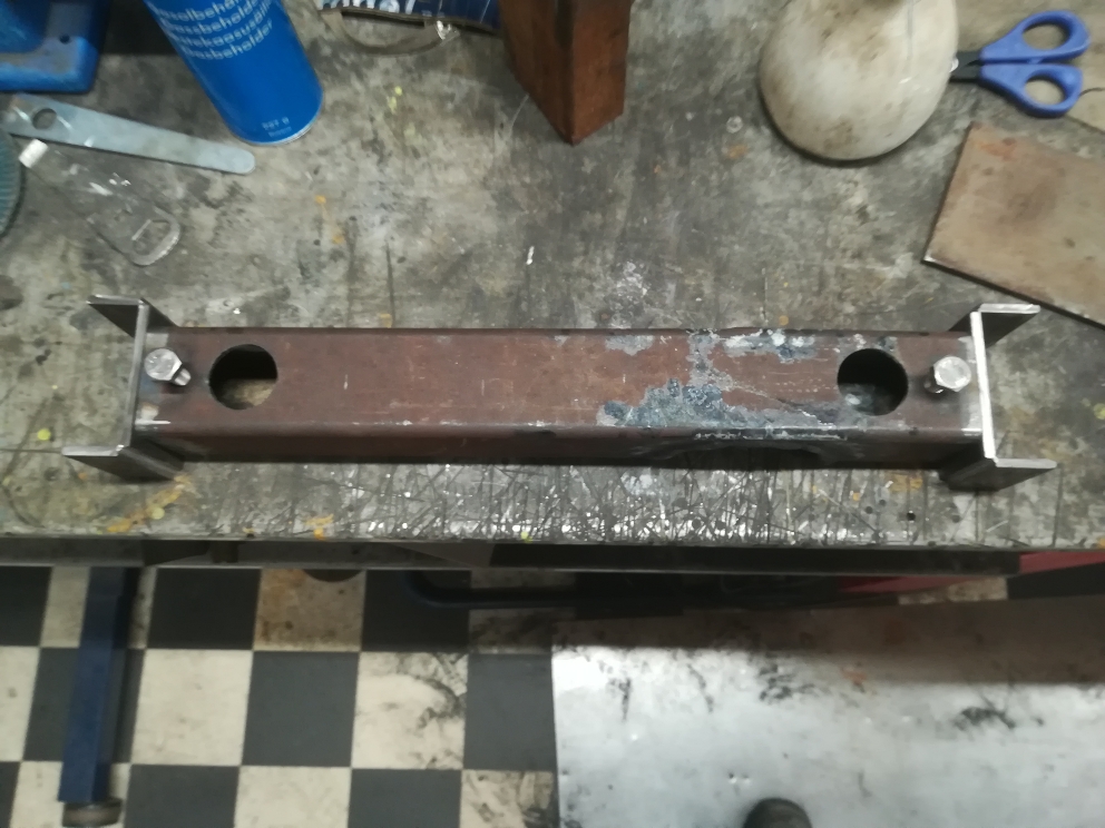

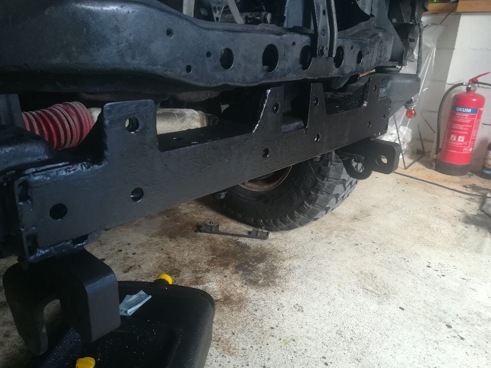

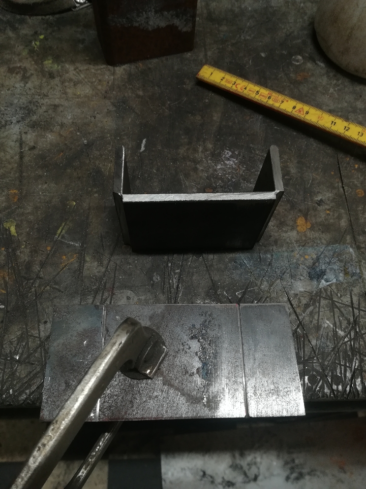

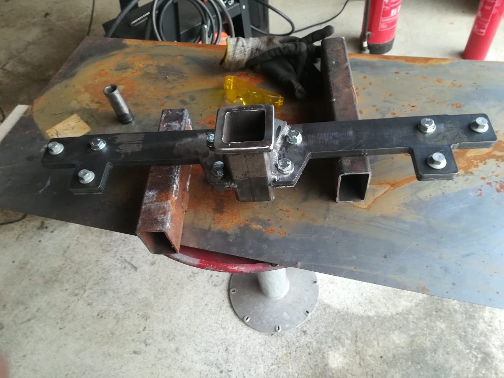

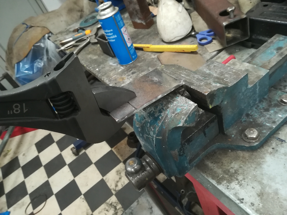

Having a plan to install the winchplate on the frame very soon,hopefully now in April. So i welded in the nuts for the bolts this sunday.

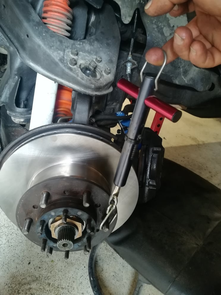

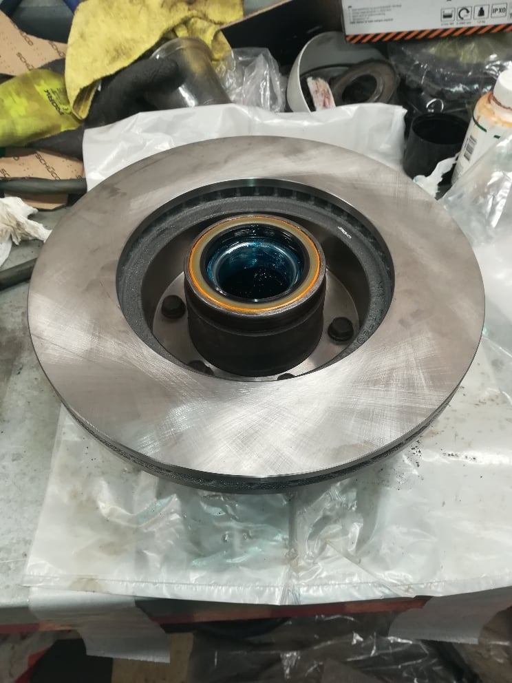

Other than that, the 4runner is pretty ready for the traveling season, but i will replace the steeringfluid first,maybe the frontdisks also and regrease the bearings and brassbushings.

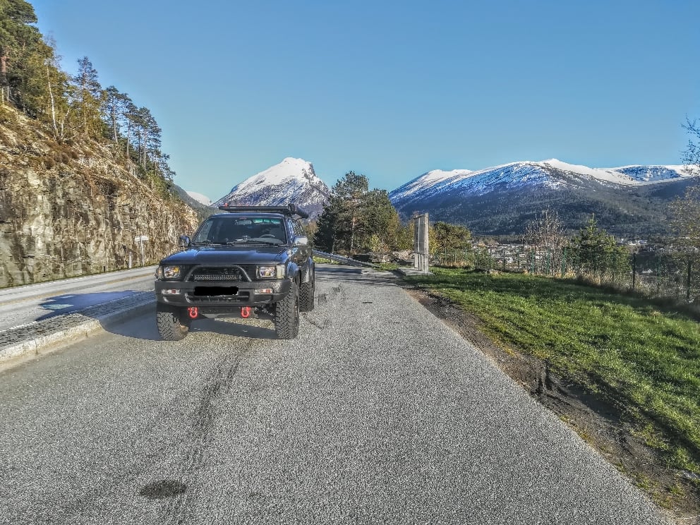

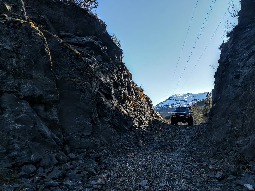

Took it out last weekend for a little ride.

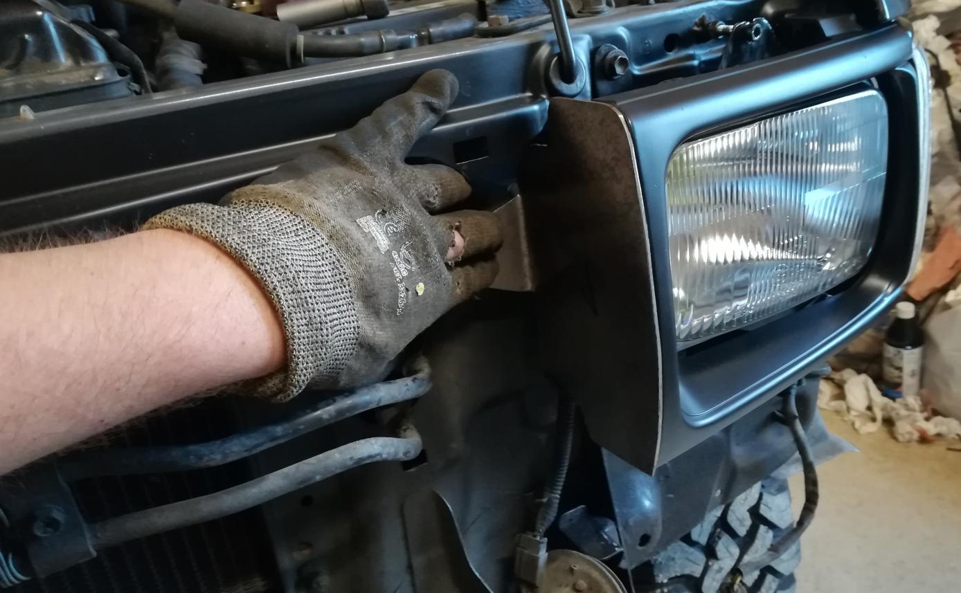

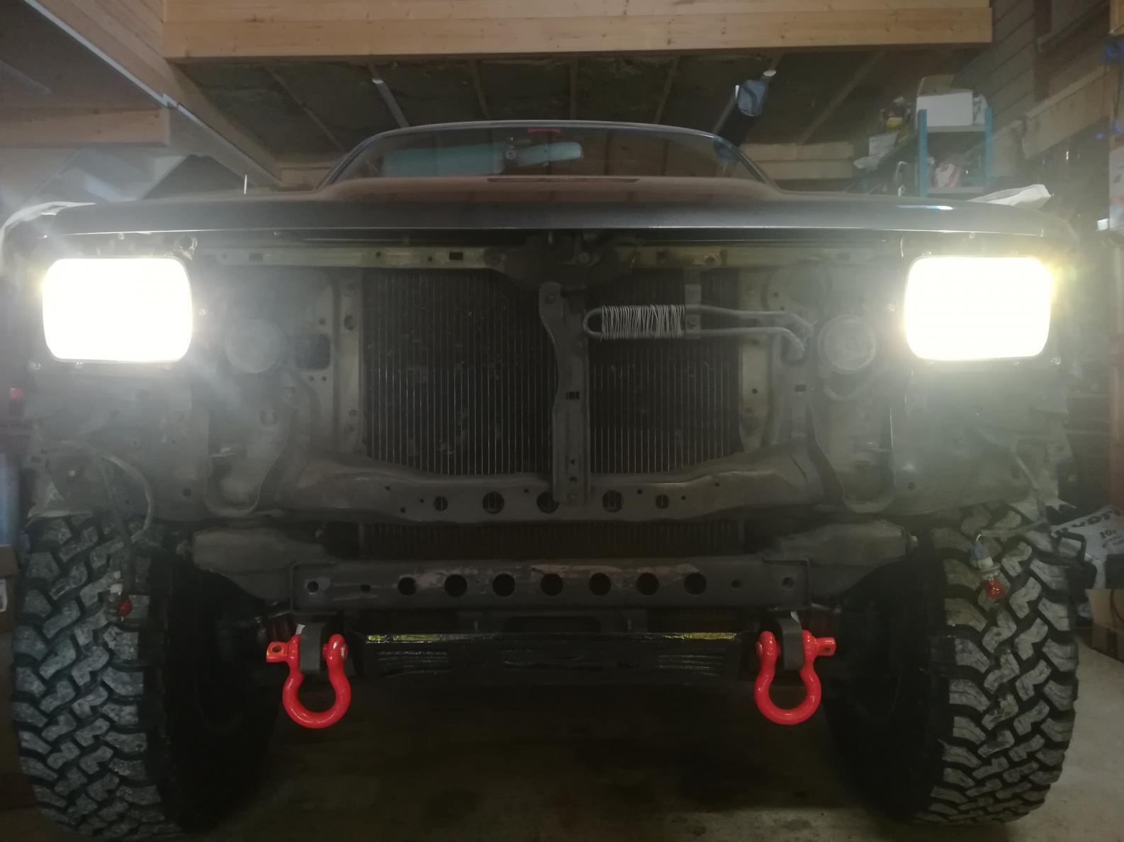

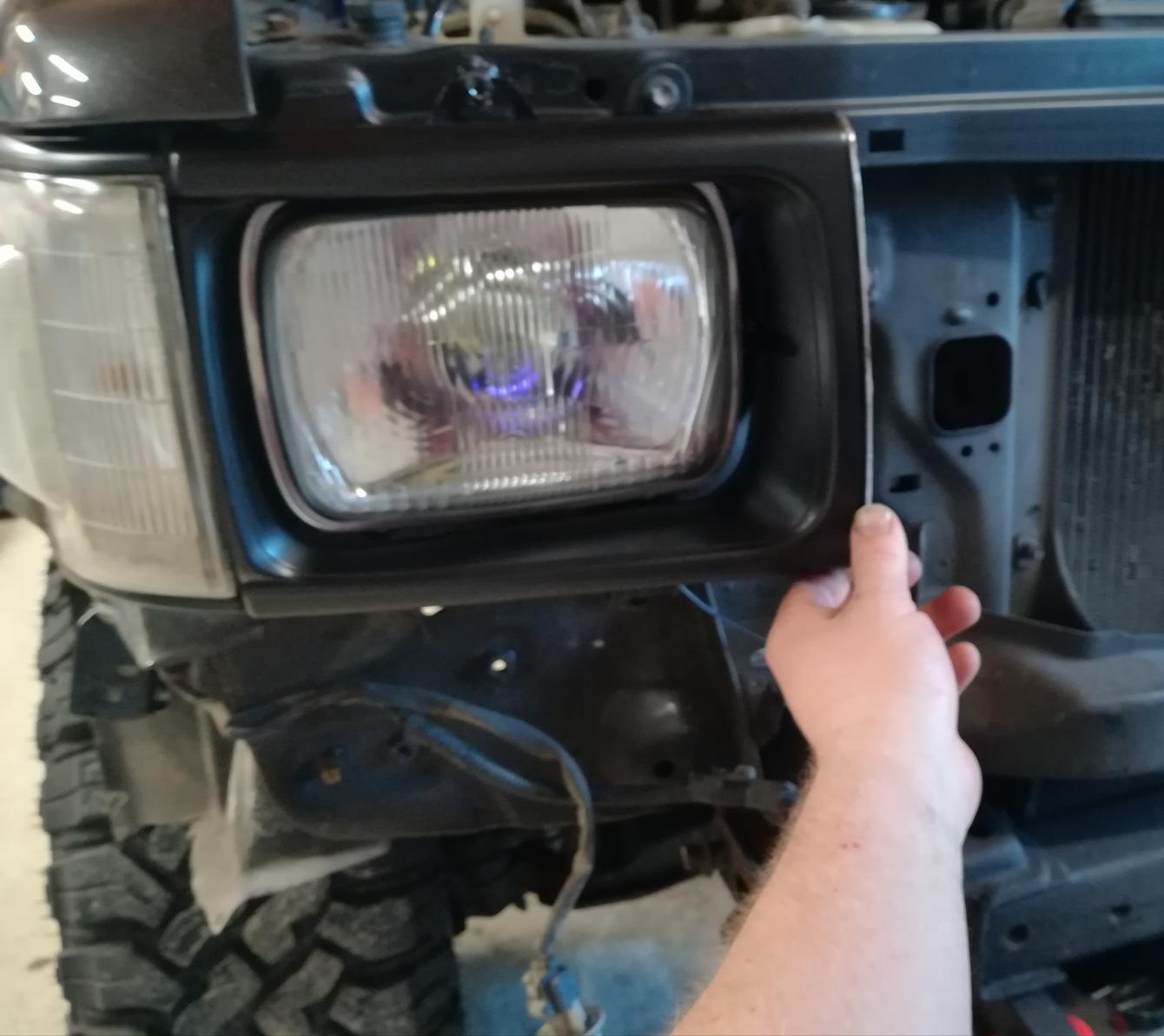

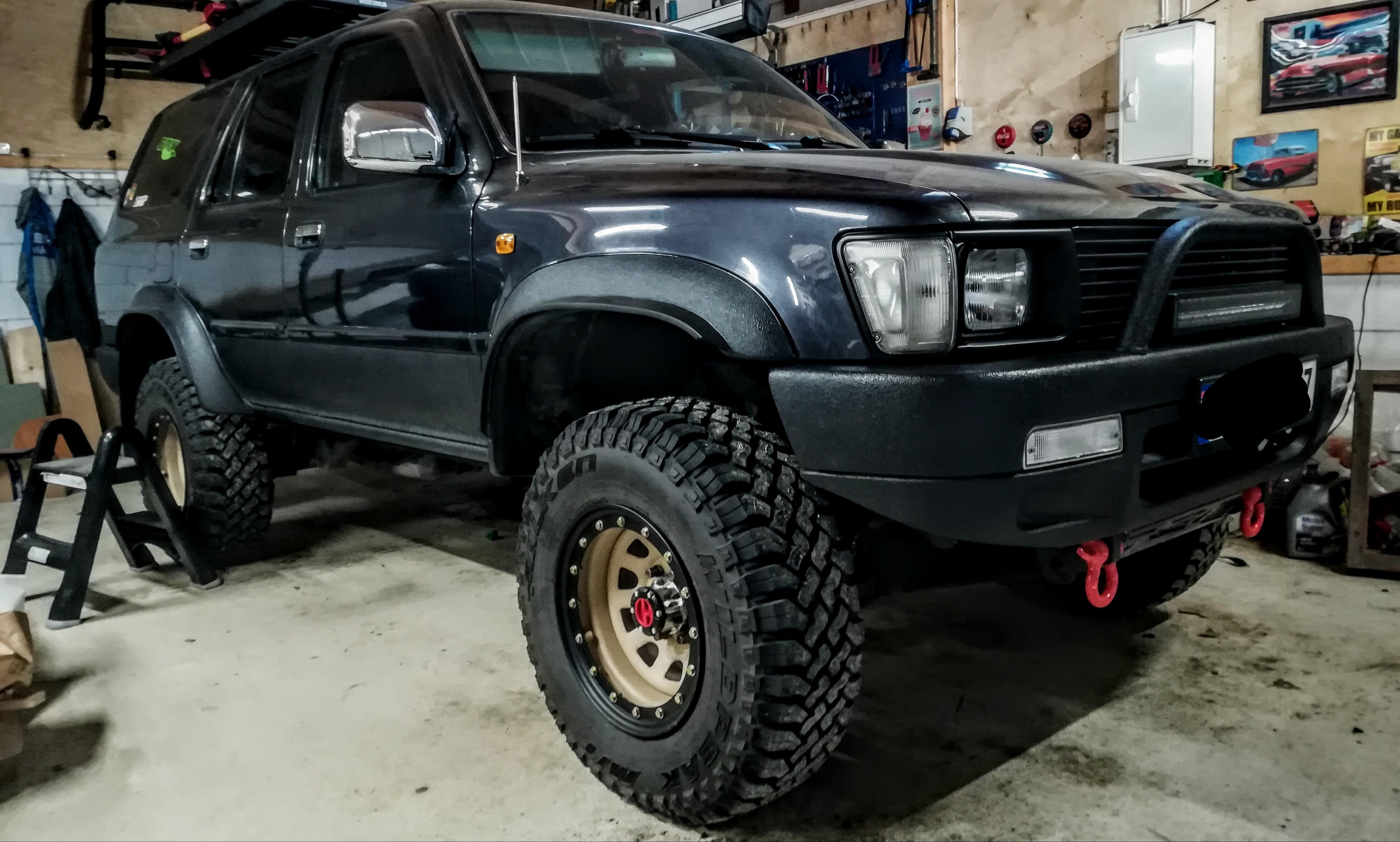

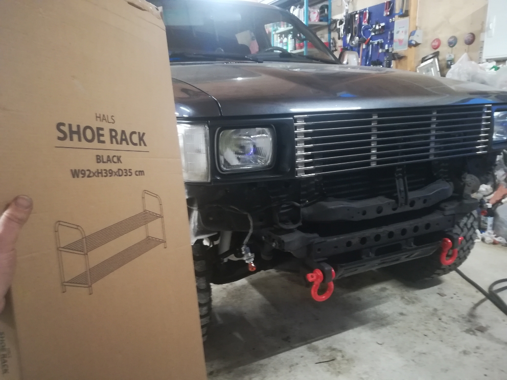

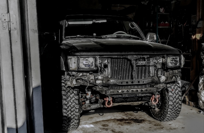

Anyway im changing my frontend at the moment. headlamps and brackets are done and adjusted, everything fits great, soon custom grill are gonna be made.

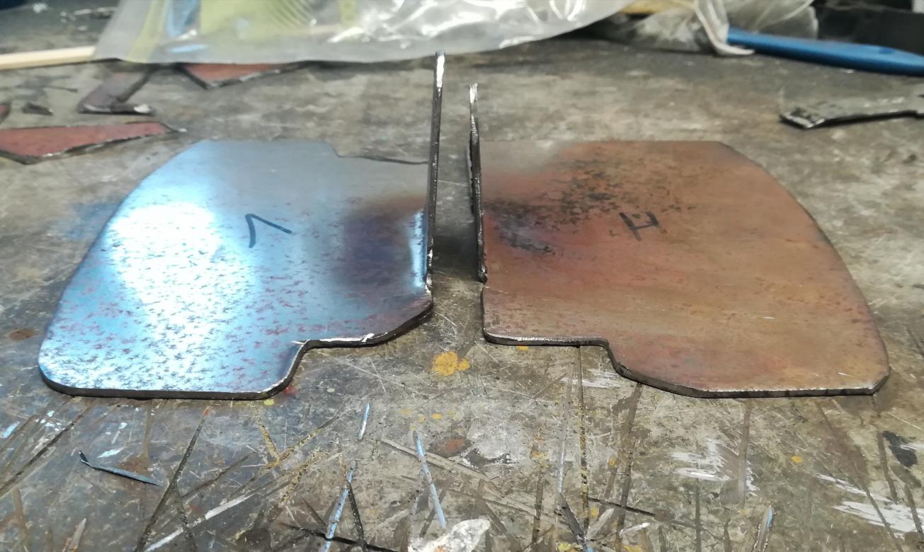

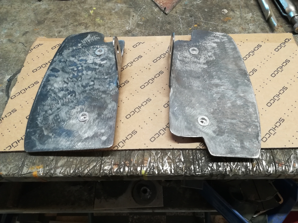

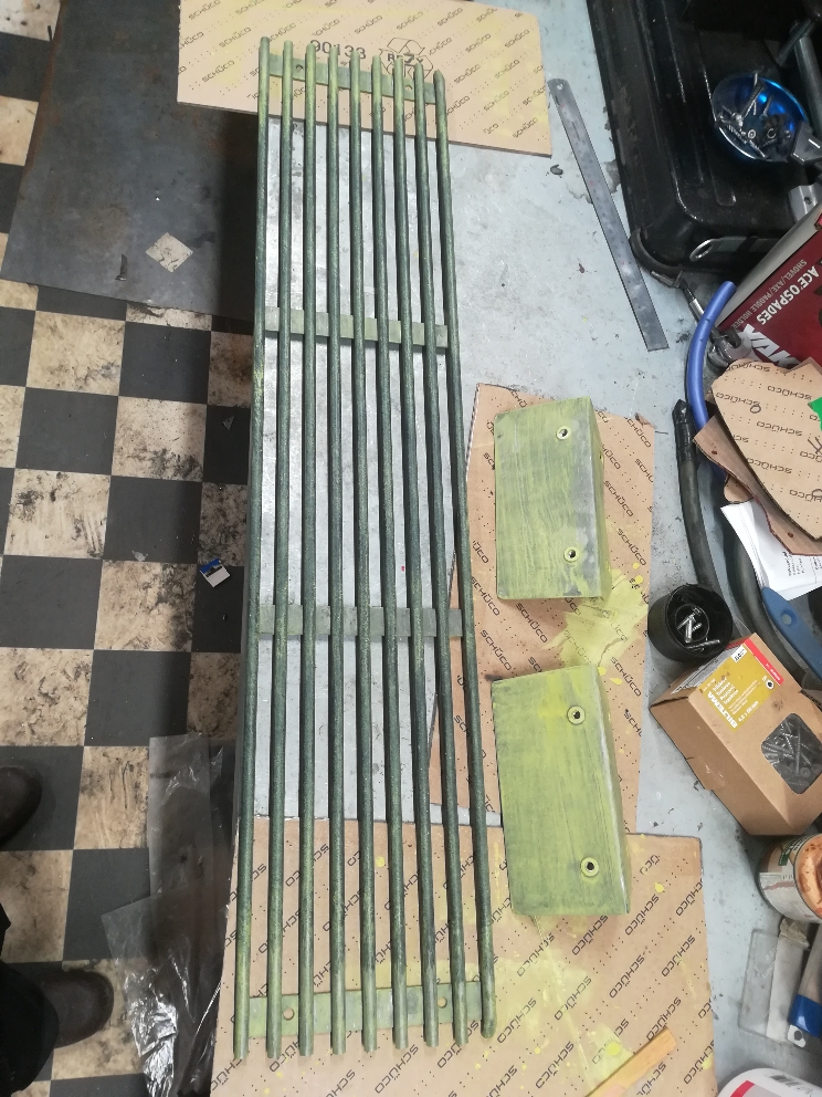

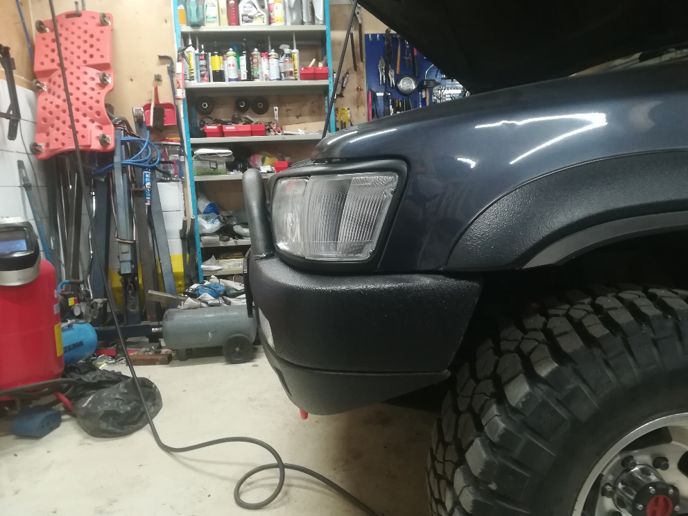

Brackets painted and installed, headlamps etc installed, time to make the grill... begun on some brackets today..

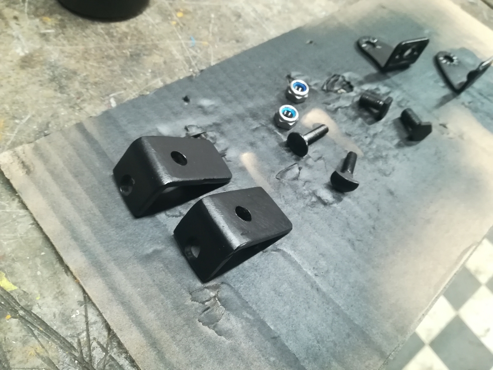

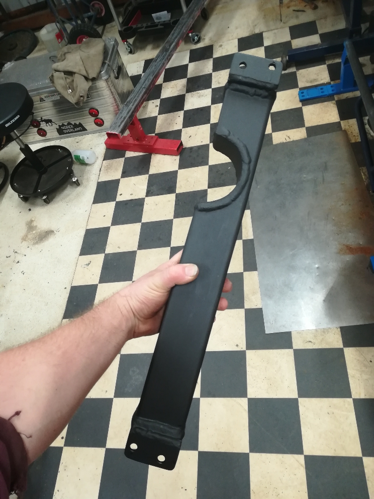

Some work on the brackets today, ready adjusted and to mount M6 bolts. the new grill will possible come tomorrow.

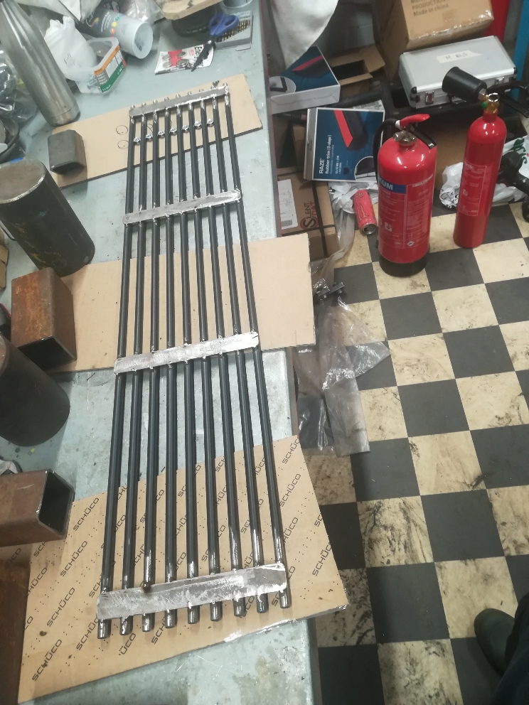

All the brackets and grill are almost done painted black. need more paint first.. installed and adjust med the bumper meanwhile..

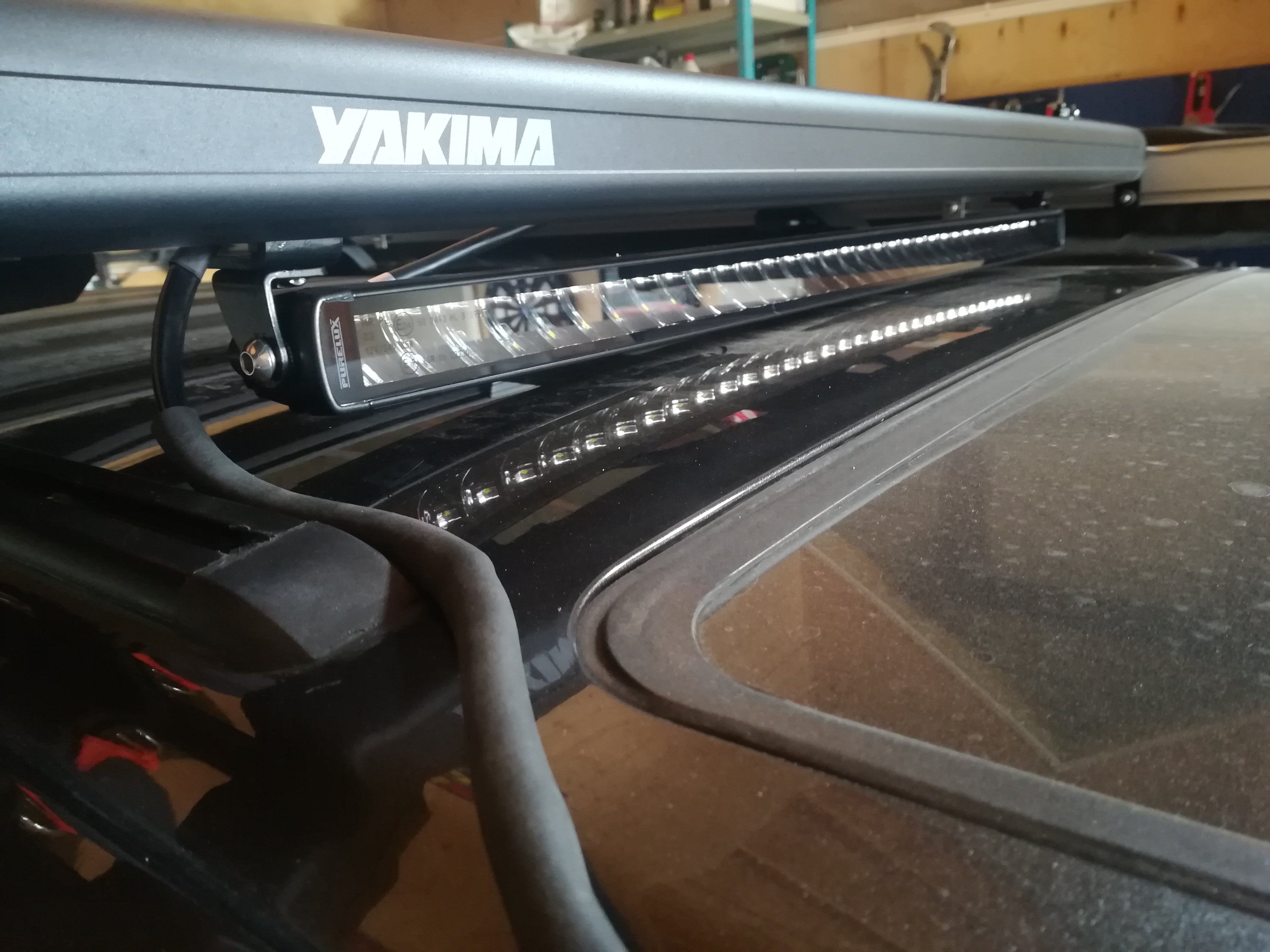

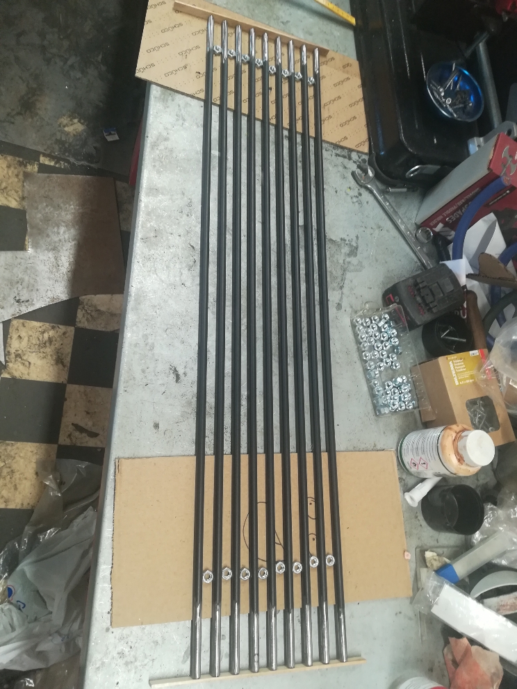

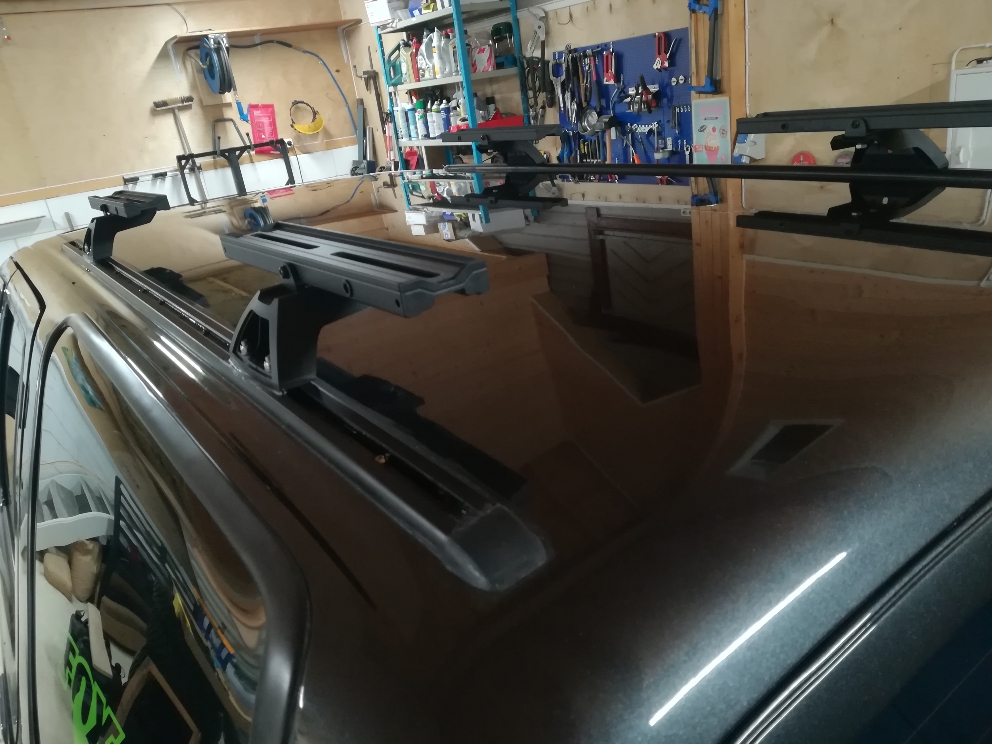

Making brackets for the roofrack ledbar. 800mm, also another pic ready assembled. So 2 ledbars will do the stuff when going downsize in main headlights.

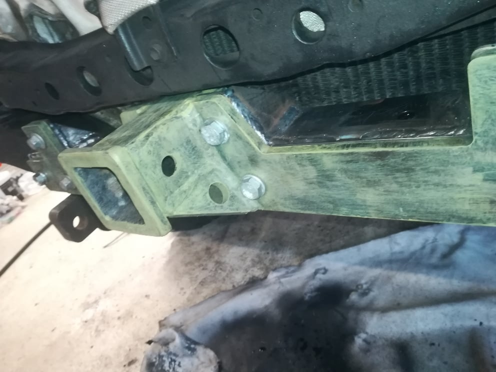

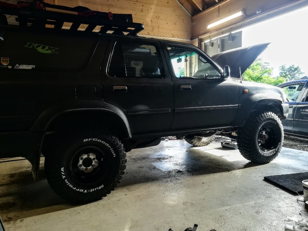

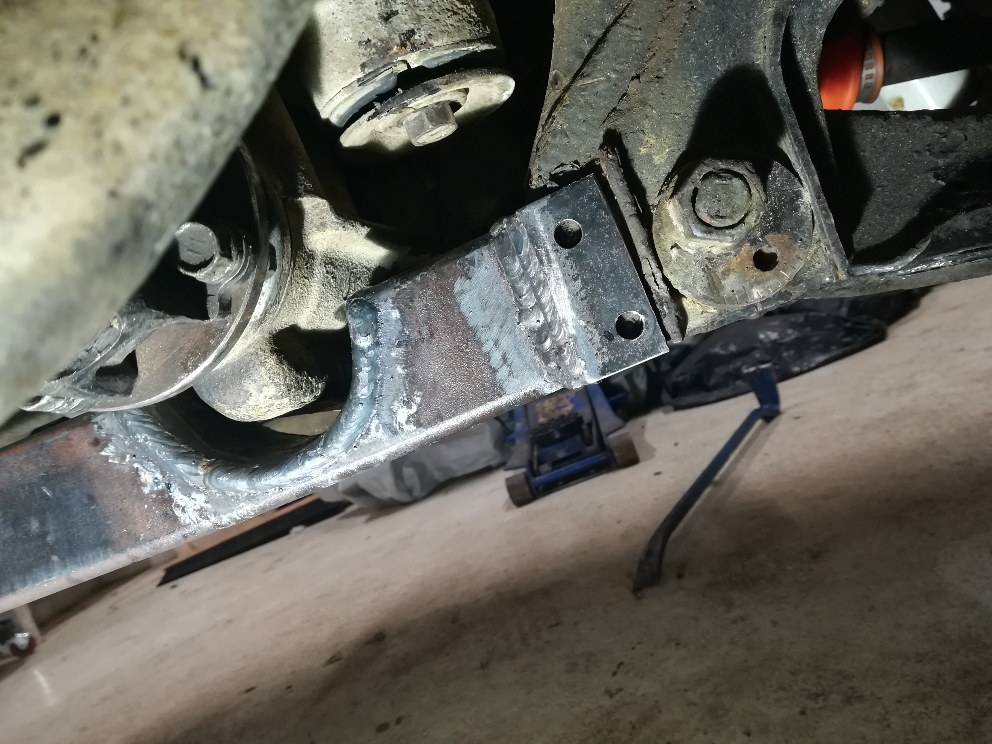

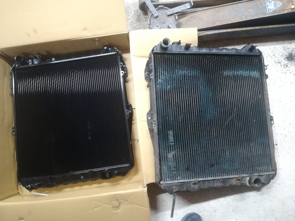

Winch mount installed, new oem radiator and new waterpump added with oem red cooling fluid,huge upgrade different for the cooling system.
now i replace the lower controllarms with new bushings and bolts. old bolds was so rusted and making cracking noises.
