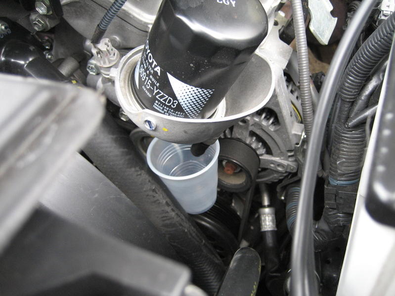

If your 4th gen. is a V6, one little trick, when you loosing the oil filter, loosen it a bit, then remove the black nipple that is under the metal oil catch pan and with one hand put a 12 ounce plastic cup under the hole and with the other hand unscrew the filter. The oil in the filter will run out of the filter and the plastic cup should catch the oil. If you don't do that little trick, it can be a bit of a mess.

This is more of what I had in mine.
