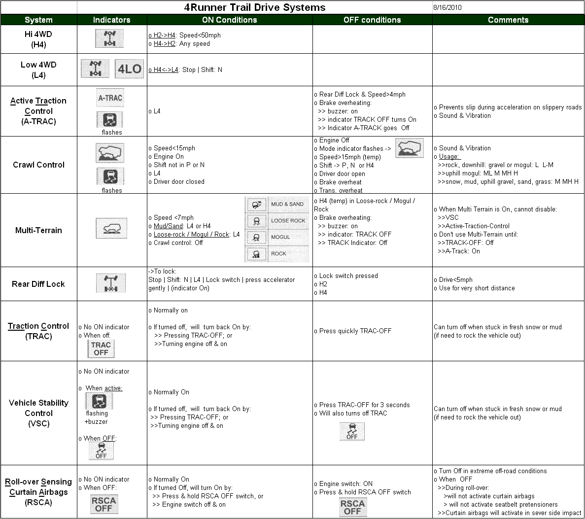

I created & attached a 'cheat sheet' showing operation conditions for drive system on the 4Runner Trail. This may save drivers flipping through the manual.
The information was compiled according my understanding of the manual description. If anyone see an error or improvement, please let me know.
8/28/10 See update on the enclosed link:

I think some of the people on here might be a little confused about what trac is. It is basically a brake system that gives you LSD front and rear when in 4wd with no throttle control (2wd is a different story). So when youre in mud or any other type of trail where you want traction, but a locker is not needed, trac is great. For example, your in 4hi and instead of stoping to put it in 4lo and in atrac, you can just continue into the loose mud, once your tires slip trac will activate and brake the slipping wheels (LSD effect) sending power to the wheels with traction. Its the same concept as atrac but just allows a bit more wheel spin (which may actually help in mud). By turning it off your turning your 4runner into a open diff 2wd (one wheel up front and one in the rear), trac has gotten me through alot and hopefully you can change that in the graph so its not depicted as a hindrance.

Thanks for the clarifications.
(The chart information is taken directly from the user manual of the 4Runner trail without interpretations, so Toyota claims that disconnecting TRAC can help rocking the car back & forth in mud or snow based on their experience.)
We can also create user tips thread based on owners real trail experience.

I have the document in PDF but it's bigger then the allowed 137k size for attachments. If you have any trick to do it please let me know.

Toyota is correct. In mud or sand or deep snbow, you want to use the locker, NOT TRAC. Although in concept it is correct, in real world TRAC will tend to bog you down (aka lose momentum) because TRAC always lags behind actual traction condition. In addition, TRAC may de-throttle the engine when slippage is sensed...thus, further killing momentum.
For me, this is how i would use the system. TRAC is for on-road all-weather use. I would not rely on it off-road. Off-road, you use A-TRAC and/or rear locker. Terrain Response or Crawl Control is good when you're in 4-HI. When you need 4-LO (aka severe terrain), i would just rely on A-TRAC and rear locker and shut everything else off. If you're not sure of yourself in terms of speed, then use CC in addition to A-TRAC and locker.
TRAC only interrupts the throttle in 2wd. If you are in 4hi, when ATRAC and locker are not available, TRAC works great and should be left on.
Hmm, did that change for the 5th gen? For 3rd and 4th gen 4runners, TRAC does de-throttle you whether you're in 4wd or 2wd. A-TRAC does not, but that is available on in 4-LO. This is why i recommend using the Terrain response (+/- CC) in 4-HI...it is better than relying on TRAC.
Im not sure, but if we're talking about trail only 4runners then yeah just use the terrain select but for sr5's, TRAC should be a good lsd front and rear when in 4hi. Of course you have ATRAC in 4lo, but there are times when 4lo just isnt needed. Someone should just head out, test, and report. Keep in mind you have to let TRAC activate, it takes some gas but you'll see the light come on and hear it.
