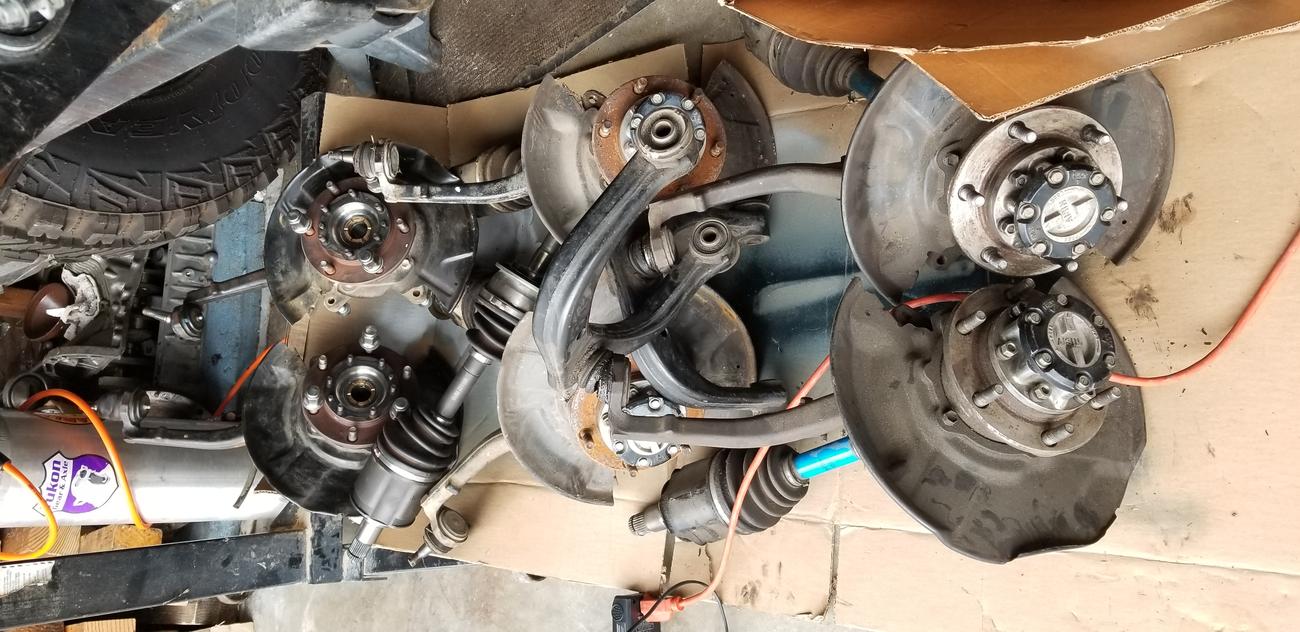

Taco hubs dont require you to change out your add differential tube, unless you want to get rid of all the electronics system. Just replace the wheel bearing and add the hubs on. Benefits is 2wd low range, and like everyone else said you can replace your broken cv or blow diff somewhere more comfortable if you have too. My collection of Tacoma hubs!��

dude stop hording all the Aisin FHT-019 hubs.
