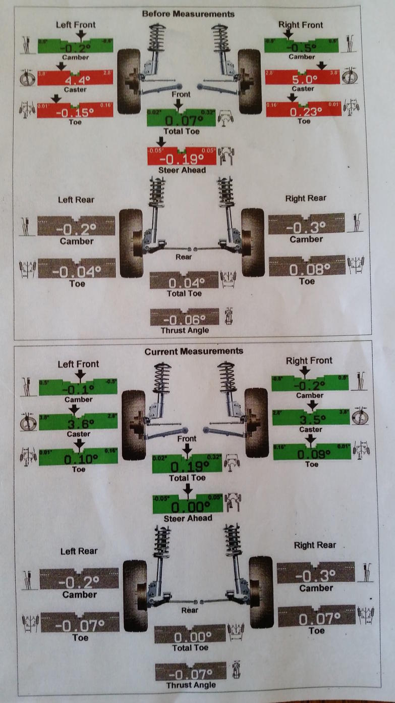

Ok, I have the 6112 shocks on the 4th clip and 265 Nittos and just installed the Dirt King UCAs (Bushing Style Upper Control Arms) ... i took my 4Runner to Firestone to get aligned and they put it on their machine and said its maxed out and its off.
Where is there a GOOD alignment place in West Valley/Phoenix?
Ok, I have the 6112 shocks on the 4th clip and 265 Nittos and just installed the Dirt King UCAs (Bushing Style Upper Control Arms) ... i took my 4Runner to Firestone to get aligned and they put it on their machine and said its maxed out and its off. I am driving over there to get it but shouldnt upper control arms fix the issue to bring the alignment back in line to get it straight?

I have total chaos UCAs and 6112s set at the very top 5th clip up. My alignment wasn't too far off from stock to begin with after the lift. I would definitely consider taking it to somewhere else to get it aligned. The new UCAs should help you get more caster as well.

Update:
Made a Saturday morning appointment at Camelback Toyota and let me tell you they have their STUFF TOGETHER THERE! Service was the best I have experienced at any dealer of any make.
I was out in just under 2 hours with my regular scheduled service plus alignment and Robert Gonzalez who helped me was very helpful and confident about the service tech Tom's ability to get my alignment nailed.
Oh and they really liked my Dirt King Fabrication Upper Control Arms.
Here is the result of my alignment.... before was from Firestone and (another Toyota dealer) and they said I was maxed out... and after is what Tom at Camelback Toyota got it to.
So the lesson learned for me is that find a location that has someone that truly knows what they are doing. Just because they have the tools doesnt mean they know how to use them.
