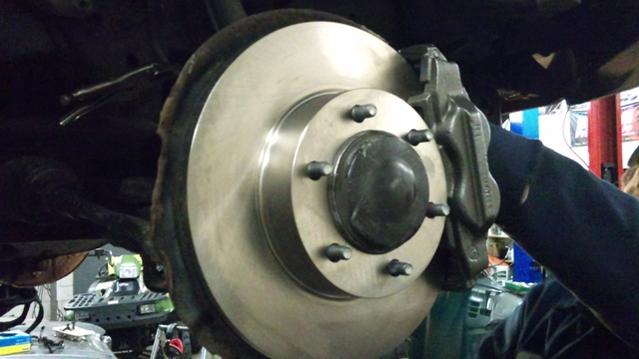

The Tundra kit is wider. The rotors are thicker and of course the calipers are wider to fit the rotors. They don;t warp like the tiny 4Runner brakes do.
well the stock 4runner brakes are marginal at best, by upgrading to the tundra braking system(fronts only) you get thicker rotors that can handle and dissipate heat better for increased braking power/performance. there are two different calipers available for the tundras, one is a 199mm and the other is a 231mm. to run the larger caliper you might need a wheel spacer or different wheels. but the 199s should be fine with any stock 4runner wheel(excluding the 15" wheels). if you do not tow of haul heavy loads with your 4runner the 199s will be just fine.
