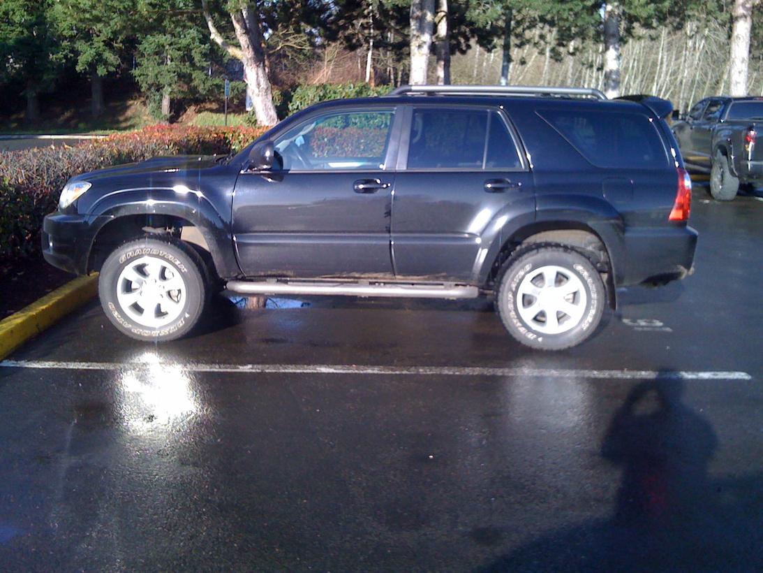

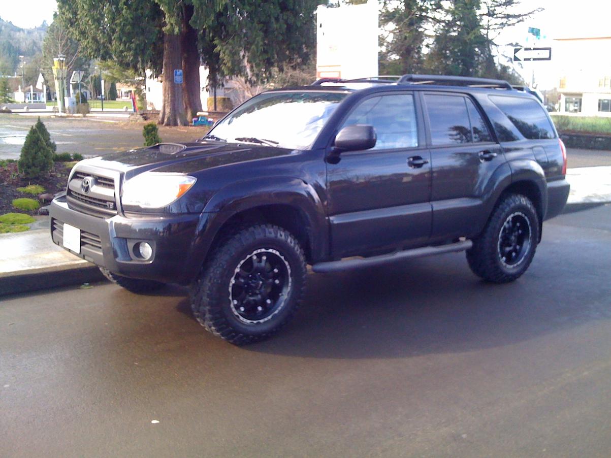

Saturday was a good day. :)
After doing my research I decided on some 275-65-18 Duratracs. I had to get some wheels so I ended up going with the Ballistic Hostel 18-9. It's amazing how some tires and wheels completely transform a vehicle, here are some before and after shots. The after shots have the stock wheels and tires in the back, normally it sits perfectly level.

so is that stock suspension ?
It has a Truxxx 3" front 1.5" rear with the stock xreas. The fender liners are moved forward and front mudflaps are removed. No rubbing issues so far.
Transformed?..... absolutely. In a good way?.... well that's a matter of taste. Its not mine (just being honest) but if that look makes you happy then CONGRATS and it is well worth the time, money, and effort.

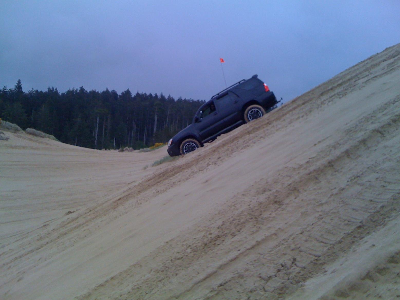

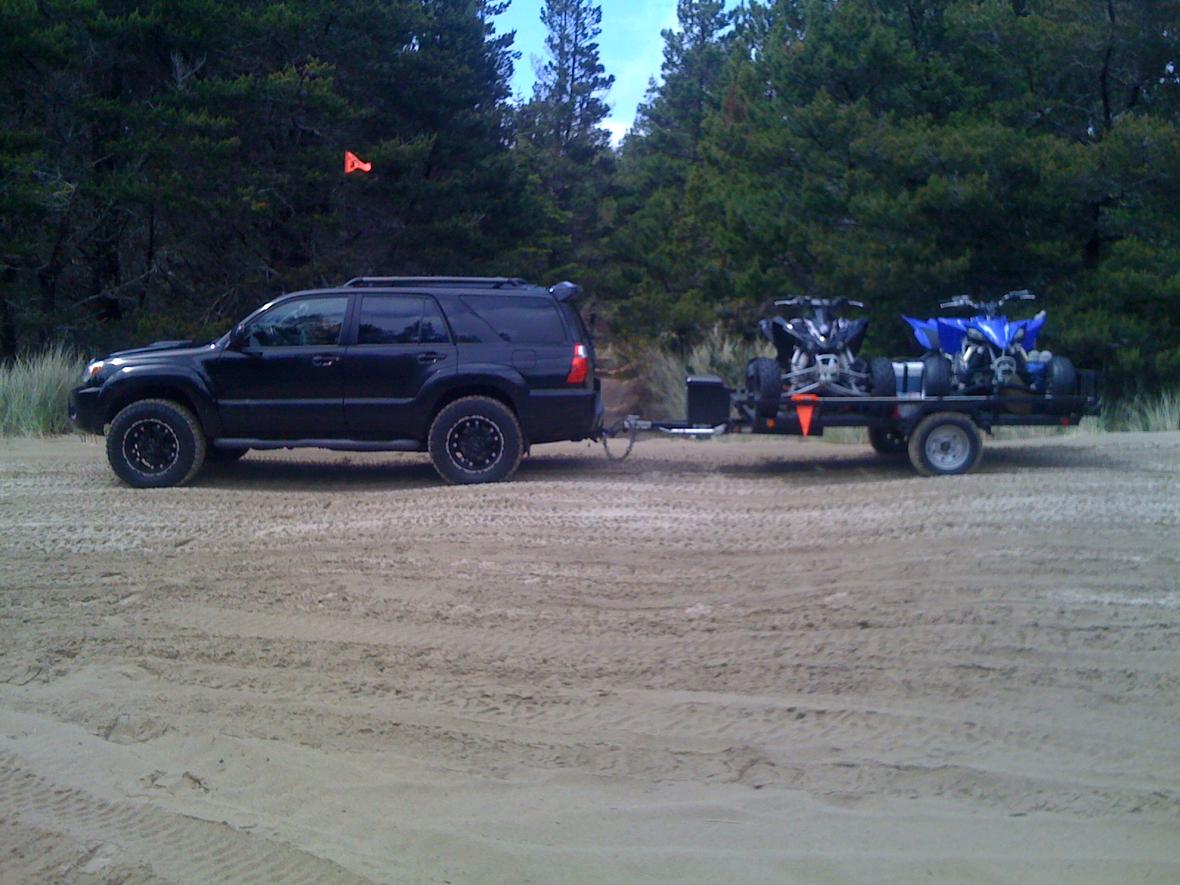

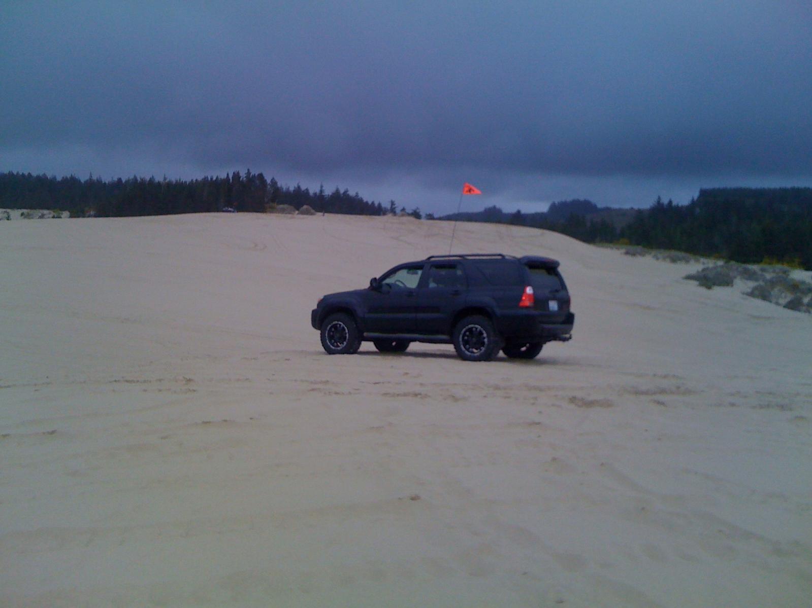

Took a few pics of the 4Runner on our trip to the Oregon dunes over memorial weekend.
The duratracs are like glue in the sand. We only aired down to 20 psi and it went anywhere I pointed it with the quad trailer in tow.
