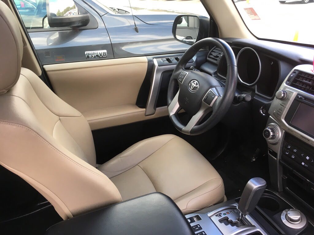

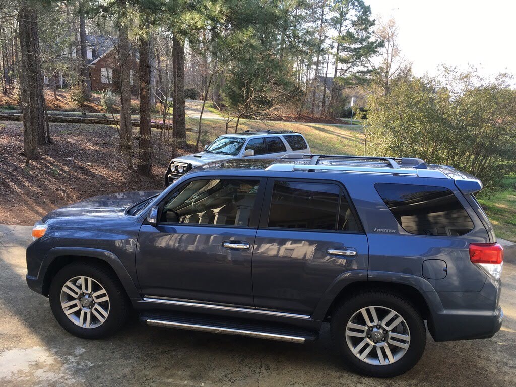

ETA: I’m not much on big white vehicles, maybe my age showing... I searched for blue with tan interior but to each his own.
My beloved 2000 Sport going ‘wtf man?’
