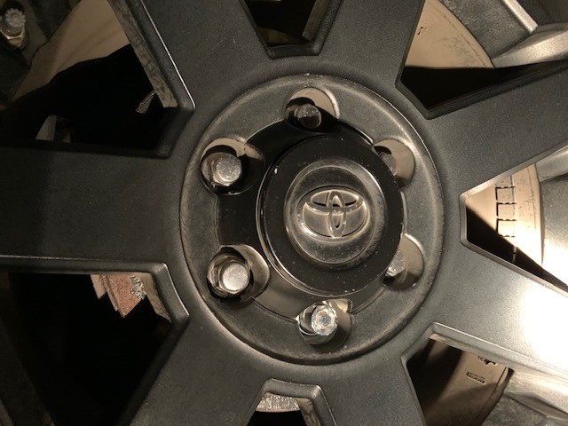

I have a 4Runner Off Road Rim and one of the chrome trim rings fell off the center cap. Anyone know where I can source one for it?

Post a picture of what you are missing- If it's what I am thinking it is, I have one I can send you for free.

This is the ring. It is normally chrome but I painted them black.

I think mine are more like brushed aluminum, not chrome, but if it works for you PM me your address and I will mail it out.

I also painted my rings black. To take them off you bend the tiny soft retainer tabs on the back straight. When you reinstall them you bend the tabs back 90 degrees. A few of the tabs broke off some of the rings and the rings were loose and rattled. So I put a dab of glue at each broken tab.
If you broke any tabs you might have the same issue. Check your other rings.
When I bought my new '20 ORP (2 miles on odo), I noticed that all of those little aluminum rings were dented and rattling, like someone used their fist to pound the center caps onto the wheels. We walked the lot and found another new ORP that had center caps with no dings and the rings were tight. Swapped them, but now that I know how cheap and flimsy they are, I remove them before and reinstall them myself after I let anyone do tire work.

The PN is 4260B-35100
Toyota calls it a Center Cap. The whole cover, not just the ring.
Online Toyota parts dealers will charge about $60 for one.
Ebay about $20.
Deuxdiesel. I got the Center Ring and it was perfect. I can't thank you enough.

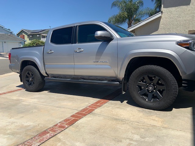

With one missing and some minor OCD I had to close my eyes when I walked by the wheel. Needless to say I'm still pretty bruised from running into my truck. :)
Thank you again.
