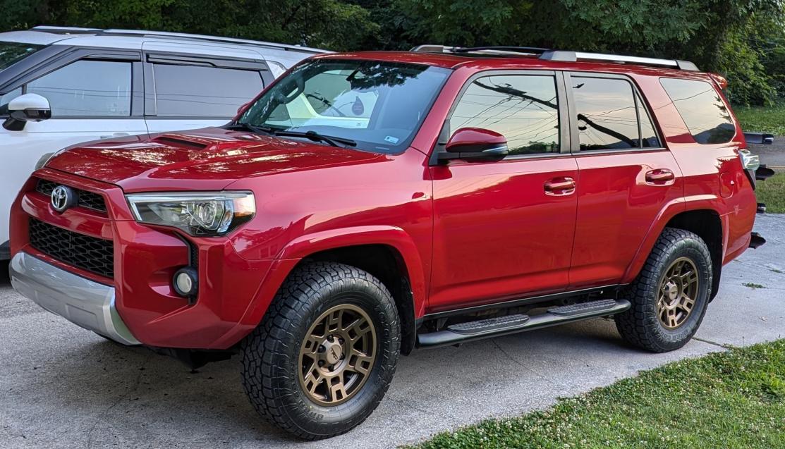

Would getting TRD Pro 17 inch Bronze wheels be a better idea?
I'm not going to try and put on the newer rims after reading the advice on this thread. The bronze TRD Pro rims I've always thought as pretty nice as well, so that's why I'm asking. Included a picture.
