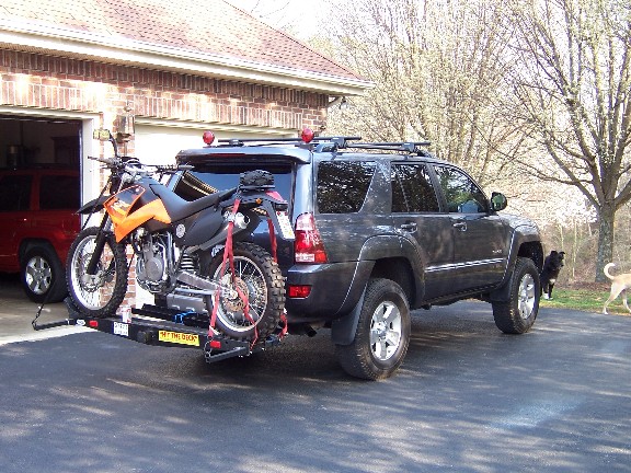

I feel ya - I went from a Ranger 4x4 xcab with a topper to my 4th gen runner. I like how I can get all the way to the back from the cab. I run it with the seat down all the time like a flat bed - don't need to carry 4 peeps. I fit a ton of stuff in the back like a couch, bicycle, 4x8 ply - I have a hitch to support the back 2 feet. Now for the bike I use a versa hauler - hard to fit in a PU anyway if you have a topper. For me it works and is the best of both worlds. Comfort and lux of a Yota and 4x4 and hauling stuff is secure.
