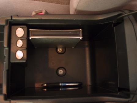

Here's how the CDRW/DVD drive looks installed in the center console armrest.
I deleted the pictures of the enclosure and drive uninstalled to save space on the forum servers. You can find pics of them at Newegg. The drive is the Panasonic CW-8123. The enclosure is the Mapower KC51SU2.

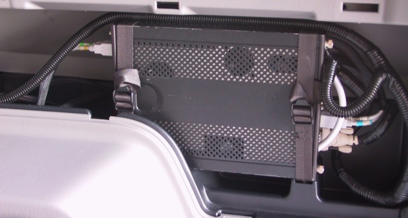

Latest picture of install with PSU integrated into case and cleaned up wiring.

- I have been considering your new PSU. It seems like a lot of people are swearing by the OPUS 150w. What are your thoughts on the difference (since you've had both). I like the idea of integrating into the case.
- Have you measured the heat dissipation from your unit? I would think it would not get enough airflow in that compartment.
No, I don't have the tools needed to do this right. I can tell you that the previous setup (with the Opus) got wicked hot, especially last summer, but that never caused even a hickup. I just ran the new setup for 2hrs tonight and it was fairly warm but not as hot as before. Then again, it was probably 40 degrees cooler outside today than last summer.
Your observation is right though. A sealed compartment isn't the best for airflow. It would be hard to build a system that ran any cooler than mine however. The VIA boards, by design, generate very little heat. My laptop drive will run cool all day long. The hottest thing in my system is the RAM -- it runs very hot. The fans in there probably don't do much more than swirl the hot air around. There isn't much room inside the C134 for airflow anyhow.
I'll wait until something burns up before I consider making any serious cooling modifications to the storage cubby. One of my design goals was to do minimal modification to any interior panels. So far, that's been achieved.
