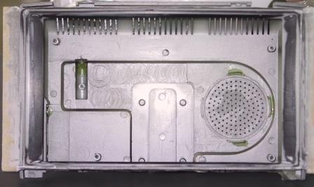

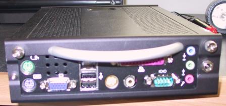

Here is the back of the case.

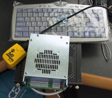

The top of the case with the DC-DC power supply, GPS, and Zippy keyboard.

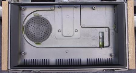

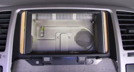

Modified LCD Case. I had to chop the front top, notch the back top, chop the bottom front, and chop and notch the bottom back.
Strips of MDF are glued to the side to fill out the dash opening. Bondo and paint will be applied to give a smooth finish.

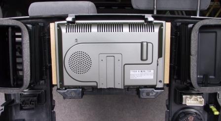

How it fits (backside). Only tiny modifications were required to the backside center console itself.

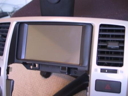

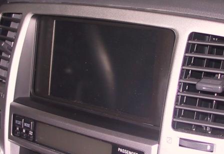

Second coat of Bondo plus sanding. 7 Coats of black trim spray paint with #0000 steel wool between coats. LCD installed to test fit.

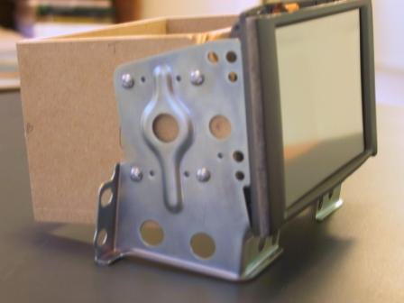

Here is the custom mounting I made for the LCD. It's exactly the same size as the factory radio and uses the factory radio brackets. It fits perfect now!
OK, I finished up some electrical modifications to the LCD circuitry and got it mounted last night. There is still some clean-up to do but everything works! :)

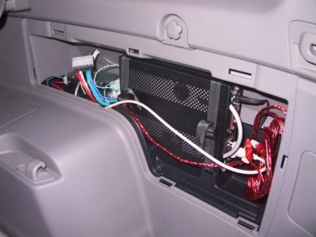

Here is the computer installed in the rear cubby. You can see I still have a bit of clean up to do on the wiring.

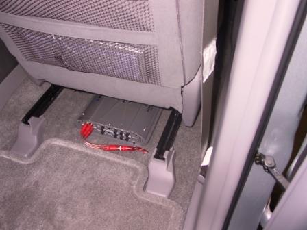

The amp under the passenger seat. This makes it fairly easy to adjust its settings by simply moving the seat all the way forward. When the seat is the normal position, you can't even see it. The only problem is that it sits on top of the vent under the seat.

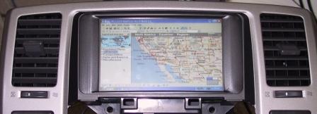

This is the screen mounted into the dash. It's nearly a perfect OEM look. I might take it out and see if I can clean the bezel up a bit. There are few sanding marks that still show through the paint. :(

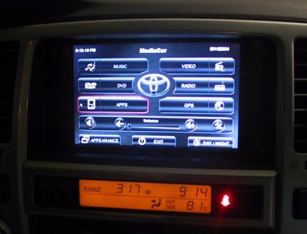

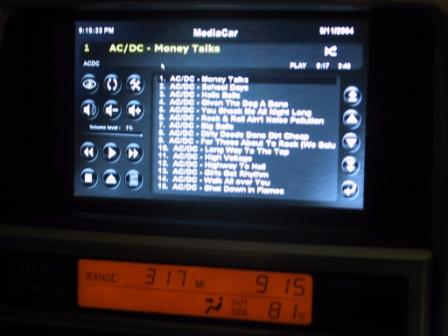

The computer boots into Windows XP. For now, I manually launch a front-end called MediaCar. It looks blue in the picture but it's actually a brushed silver color. Eventually, I will set it up to load the front-end directly so that I will never see the Windows Explorer desktop.
Notice the cool Toyota logo!

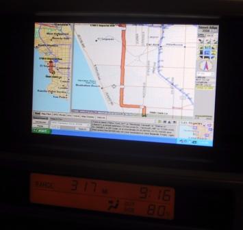

This is navigation via Street Atlas 2004. This doesn't integrate quite right with MediaCar. I still need to work out these issue. This does voice navigation and also voice recognition. Unfortunately, I don't have a Mic installed (yet).
