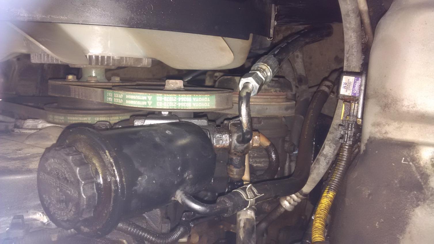

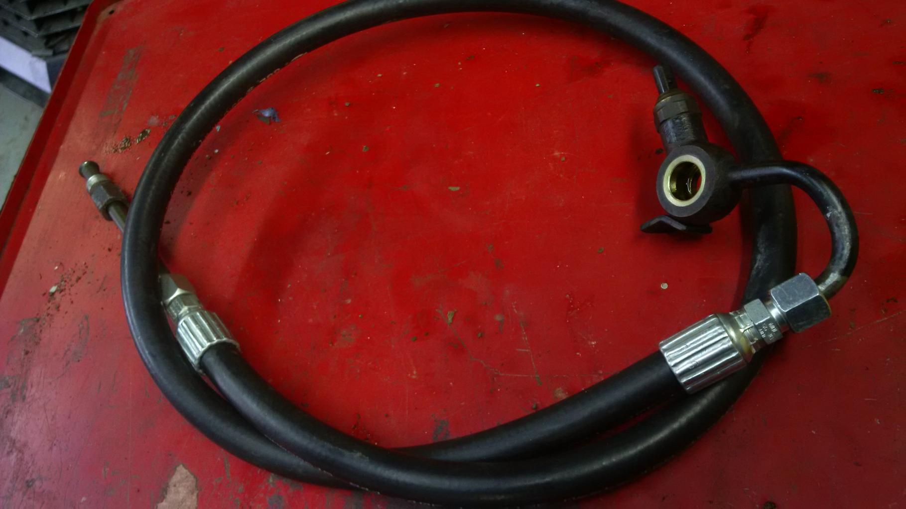

Had to change the rack on my 2002 4Runner and the fittings where rusted and couldn't be freed up even after heating, I actually had to drill them out to be able to reuse the fitting. A replacement line wasn't available and the cost of such was out of this world. I ended up resorting to making one and it worked like a charm. Just thought I'd post pictures incase someone finds themselves in the same situation. I have $50.00 in this line.
You'll want to make sure the hose is support so the vibration doesn't fatigue the steel line.
