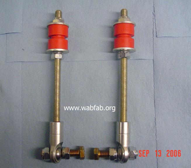

WabFab Off-Road makes these. They are longer than OEM. I have them but have not installed them yet. Actually these wouldn't be to hard to make yourself. The rod end part is made by Aurora, model# CW-M12 (female). It has a M12x1.75 threaded rod. I don't know the size of the bushings, I'd have to measure them. If you made them yourself you might save $50 to $70. I paid $135+$15 S&H. I know it is not necessary but I was really bored one day so I modified mine a bit. I added high misalignment spacers to the uniballs and made some 6061 aluminum tubing to go over the threading. I'm not trying to bash WabFab because these are better and stronger than the OEM ones, but for a $150, wow! But hey, I guess they do what they were meant to do, lol. When making them longer make sure they are not so long that they hit your trailing arms when your suspension is compressed.
http://www.wabfab.org/03074Runner/03074Runnerrearendlinks.htm
