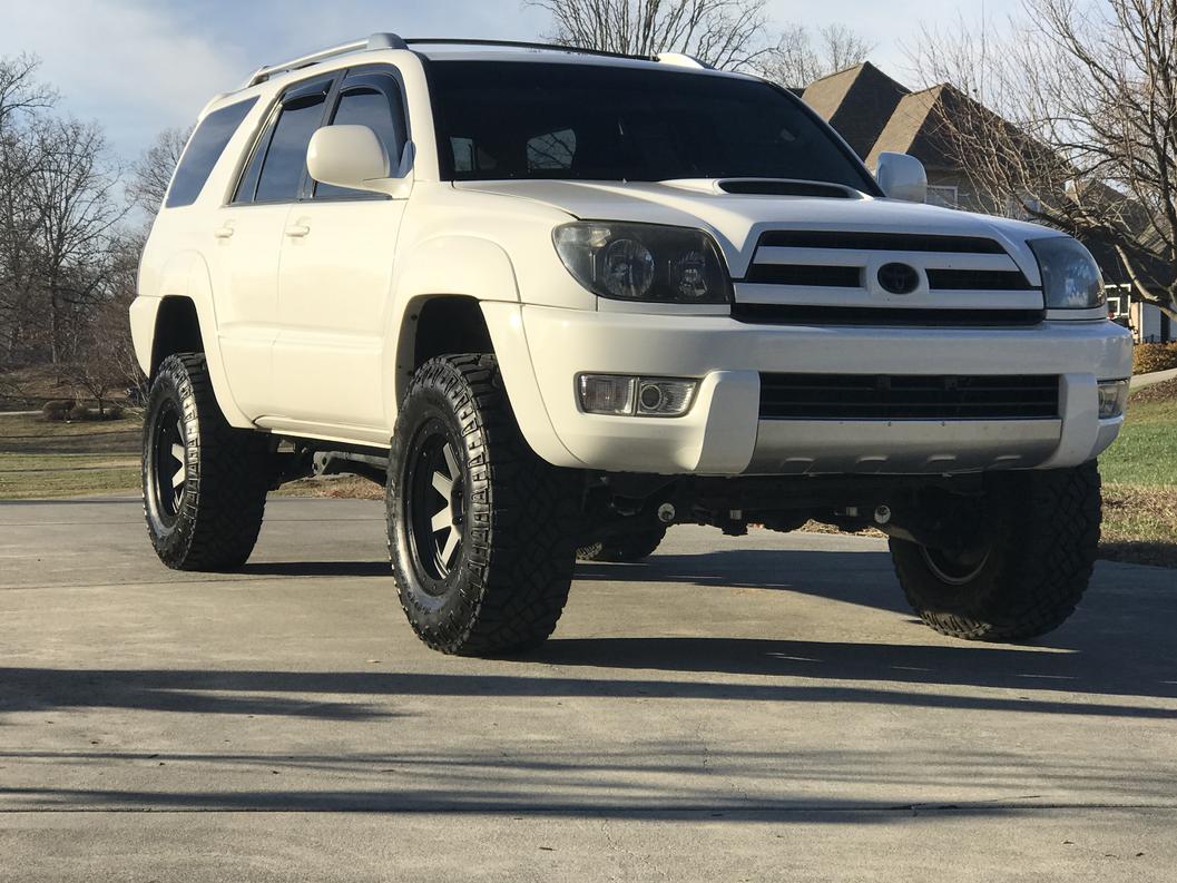

They don't make a 1" I cut my 1.5" down to a 1". I like a little rake. I wouldn't call it stock rake my any means

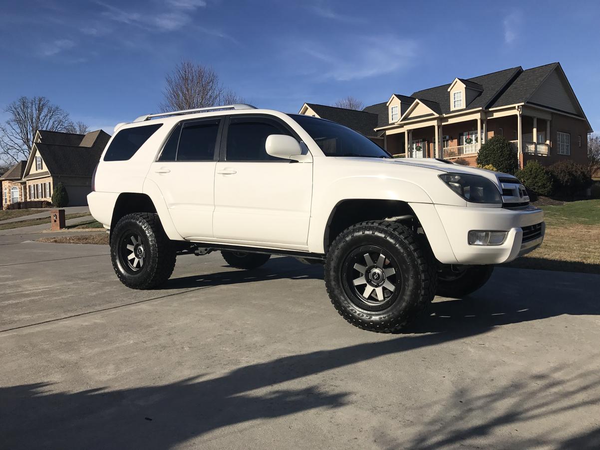

Another angle, since this pic I have painted the fake bead lock bolts same color as the inner wheel.
Used a table saw, with the saw blade spinning in reverse. Set the guide to .5" and slowly ran the spacer through, you have to pull it out some and move back due to plastic build up. Stood the spacer on it side. Hope that all makes sense.
