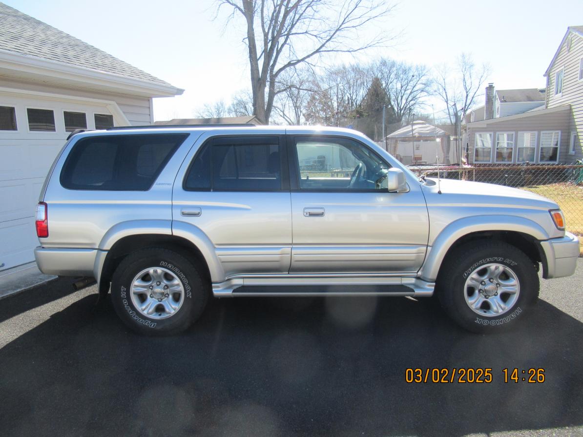

I have a 2002 4runner limited with the original suspension and 265/70R16.
BTW I have already did many searches on this site.
I am ready to install 4runner Bilstein 5100 and like to know what actual lift you are getting from 2nd, 3rd and 4 clip.
I know that direction shows:
1st clip is stock height
2nd clip is .85 inch
3rd clip is 1.75 inch
4th clip is 2.25 inch
But like to see actual photos or measurements from center of the hub to the bottom of the wheel wells. I might also be either replacing the rear spring or adding a spacer
Currently I am at 19.5 up front and 19.75 in the rear.
Thank you in advance!

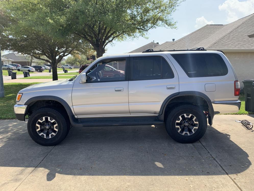

Those stats sound about right. I put on 5100s and set them to max height for the heck of it and went with FJ springs in the rear. From center-hub to bottom fender I get approx 21.75" fronts and 22.5"rears.
