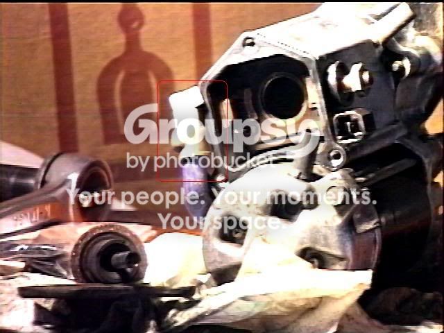

Checked the voltage to the starter, but how do I check voltage out of the starter?
On the post under the rubber cap that is marked.
22REstartersolenoid.jpg~original
I would be really surprised if it wasn't the contacts.
Parts needed for starter solenoid rebuild.....
Plunger magnet switch 28235-54380
Kit starter repair 28226-54340 (contact, bolt, o-ring, paper and plastic pieces) larger bolt/contact
Starter kit 28226-72010 (contact, bolt, o-ring paper and plastic pieces) smaller bolt/contact

I did the solenoid rebuild wasa pain in the butt to get the starter out but the rebuild took 10 minutes and now is working like a champ. I have 191k on mine and was told by more then a couple toyota specialists " hey if you want to waste money I will replace the starter I could use a spare. Just do the rebuild the starter never fails"

I just did the rebuild on my on sunday and replaced the contacts, and boy were they worn, I'll try to post pictures tonight of how bad they were, it was only that battery side contact that was really bad. All in all I'm very glad that I didi this instead of putting in a new starter

Thanks for the parts numbers. Mines went out last week an was able to start intermittently. I just went ahead and ordered the repair kit and did this myself. Some of the bolts are kind of difficult to get to but do-able. I used one of those swivel heads to get my socket in there. She started right up...so beautiful
