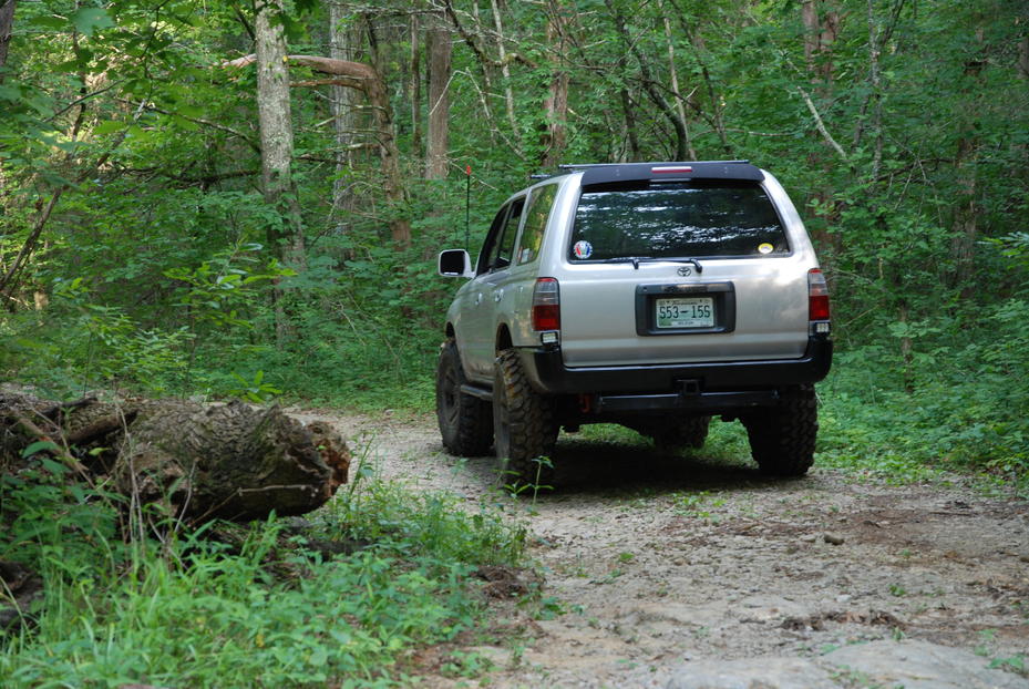

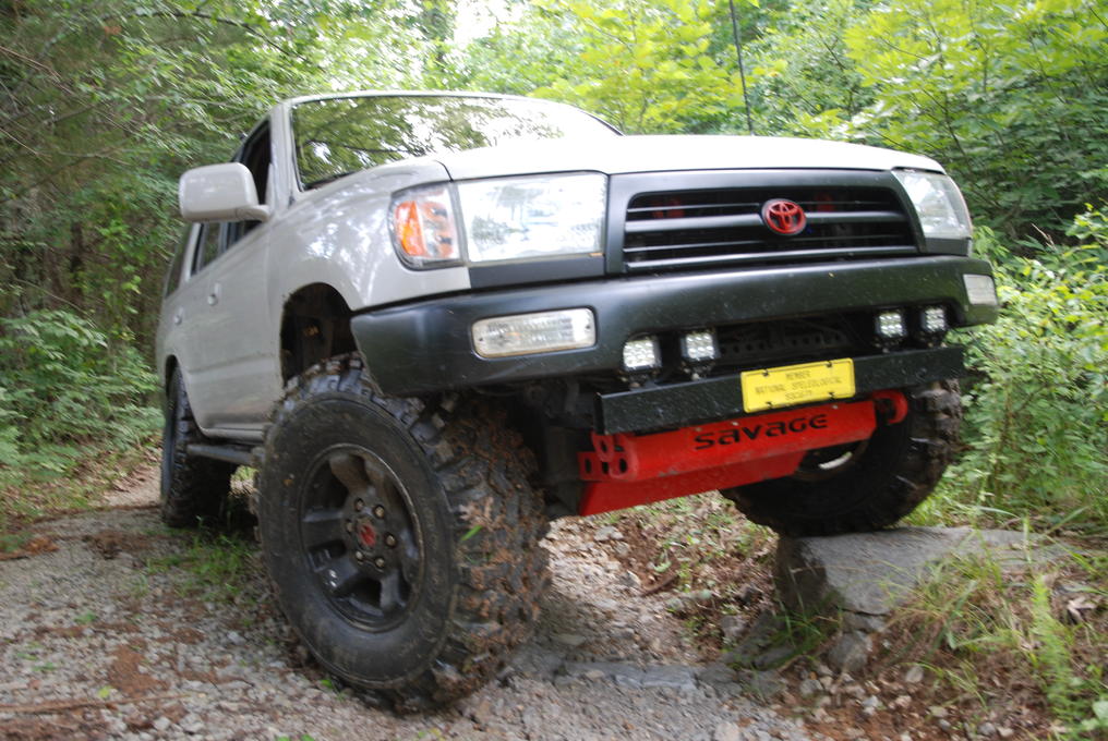

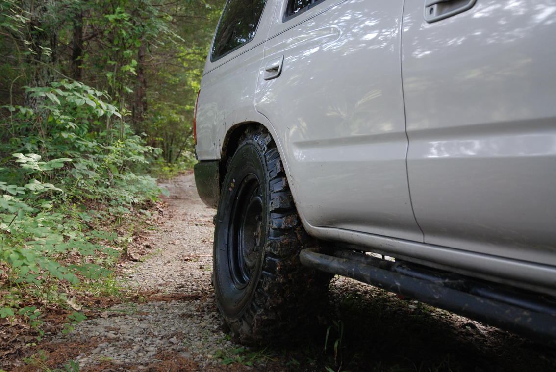

I have the 34x10.50-16LT Super Swamper LTBs on mine. 99 Coils with a daystar 1.5" spacer in the rear. Trimmed pinch weld and trimmed rear bumper equals no rubbing at full bump (stock bump stops)

There's one for 35s, so why not have ons for 34s!
