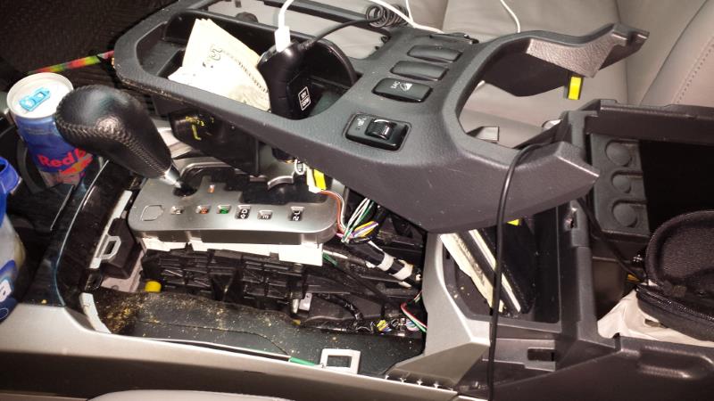

2. Remove center console plastic. Using your hands, slowly pull up on the silver center portion of the console. It will have several clips that pop in so just work it up carefully. Once removed, slip the plastic over the shifter and out of the way.
3. Remove the rear a/c vent plastic. Using your hands, grab the top of the on the a/c vent plastic (rear of the center console) and pull backwards slowly. This piece also has several clips, but it comes out easily.

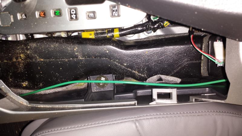

4. Attach 12 ga. positive wire to fishtape (or coat hanger) and push it through the center console starting from the shifter area going to the rear a/c vents. Detach the wire and feed it up the bracket for the center console armrest.
5. Take other end of the wire and feed it towards the dash hugging the driver-side of the center console. I then fed it along the inside of the lower dash panel until it reached the fuse panel.
6. Take the 12 ga. negative wire and feed one end starting from the rear a/c vents down towards the floor board along the driver-side.
7. Remove plastic cover hiding driver seat floorboard mount. It just snaps in place.
8. Take other end of negative wire and feed it up the bracket for the center console armrest. Now you’re done running wires!

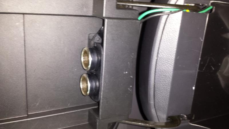

11. Remove the Kleenex plastic holder from under the armrest. It’s held in by clips that pop out easily. Take dremel and remove a small (1/4” by 1/4” piece) from the bottom side of the holder so you can feed the wires through it once re-installed.
12. Take your auxiliary outlet and cut any connectors that may have been installed on the ends of the wires. Strip the wires. Using a blue butt connector, take both positive wires and crimp them together. Repeat this for the negative wires.
13. Feed wires through the Kleenex holder and re-install into the armrest. Push the auxiliary outlet into the Kleenex holder. **This is where I added a piece of double sided 3m tape to help keep the outlet from moving inside the Kleenex holder.
14. Zip tie both wires to the armrest hinge.
