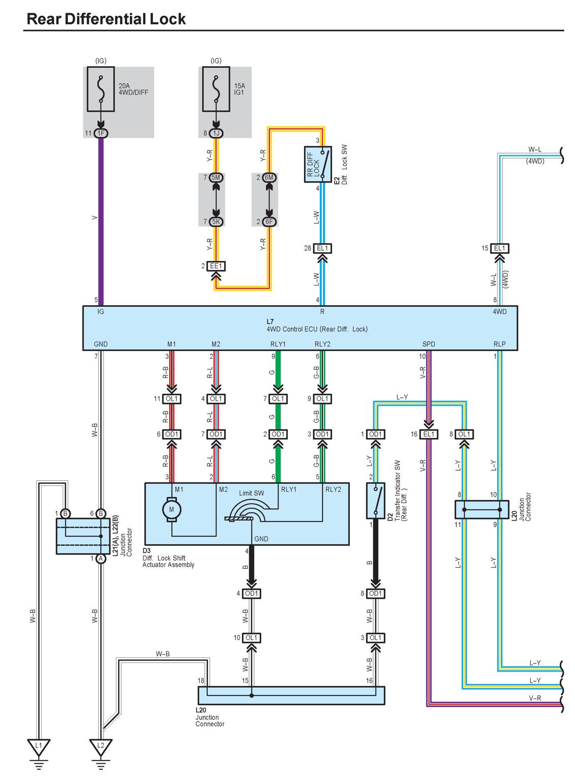

Not sure if this has been done before, but i was wondering if anybody has thrown a e-locker from a fj (2007 and up) into a 2wd 4th gen 4runner (mine is a 2003 2wd sr5). i found a page where someone did a swap in a 2007 4runner http://www.rocksolidtoys.com/forum/showthread.php?t=323
he shows how to install it into the diff housing, but i was wondering if anybody knows if i can run a switch to the motor/acuator instead of installing all the wiring, computer, ect.
here is the wiring diagram for the actuator, and i was thinking about bypassing the computer. the only thing that i was wondering about was the limit sw. what is the purpose of this, and can i run the actuator and not the limit switch.

Also check on rocksolidtoys.com Wyatt and the folks over there are a BIG help and patient ! except for Dick Foster :madgrin:
