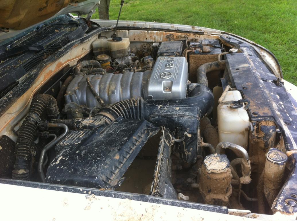

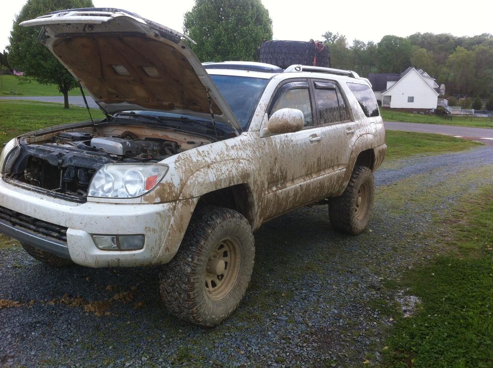

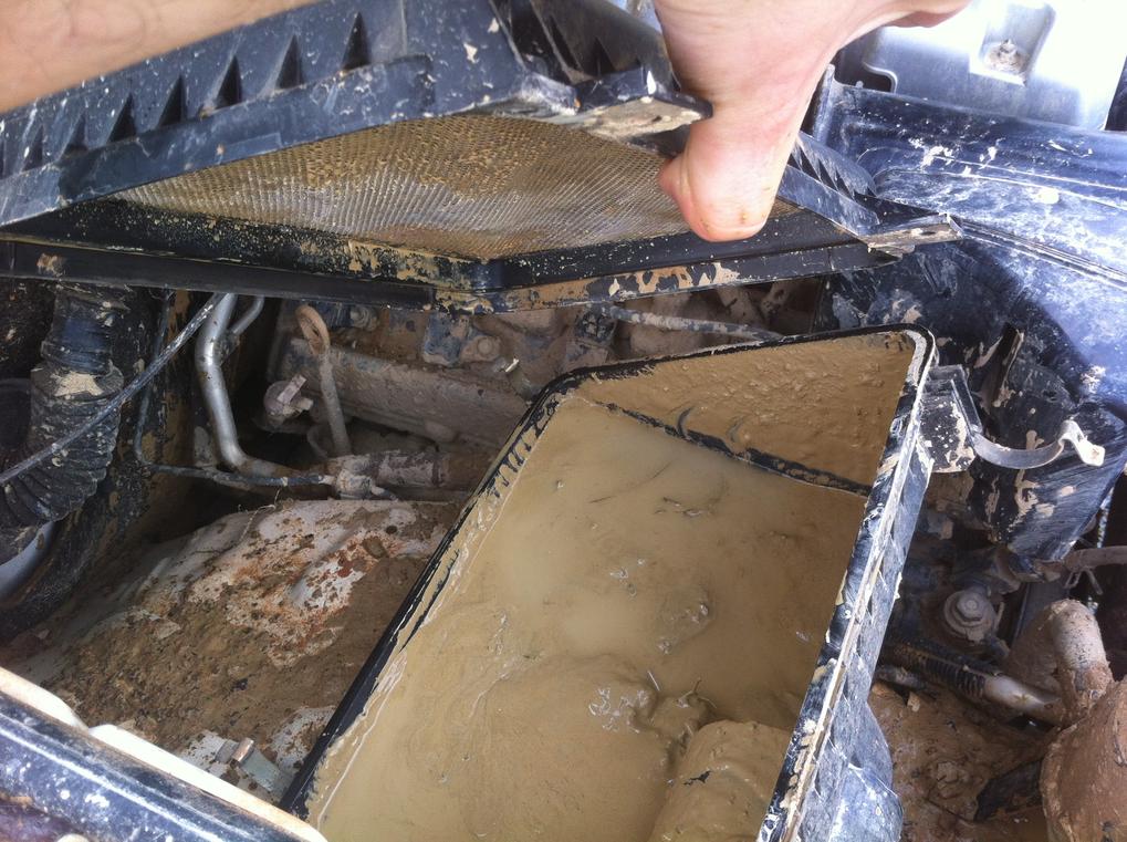

haha all the pics/ videos are on facebook ill get my buddy to send me the the video file later and post it up. He're pics from the day after. or you can seach for my facebook page names austin hargett from north carolina

These trucks are def sealed up pretty tight theres really no harm in a little mud slinging just try to keep the top of the fender above the muck I'm pretty sure you can run these things through water up to there hood line with no issues but i will def. be adding a snorkel lol. I've been through countless muddy water holes with no problems this was the first "sticky ass mud" situation I've really delt with.
