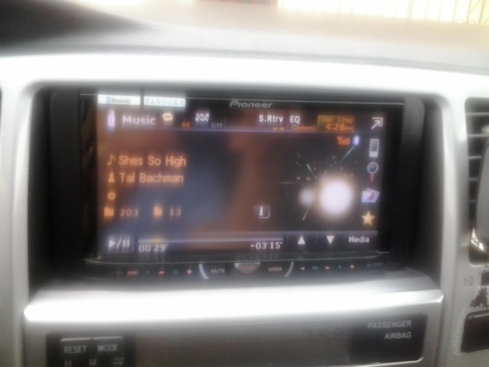

nope got a pro to do it..the costs is above..with all the kits..i blv its a plug and play...will upload pics of the finished installation 2moro

THE Installation costs isnt fixed in stone, i was charged $350 in july 2012 for my 4runner...while i was given a $450 quote last month..for an 04 rav4.....if you are tech savvy and know the kits to buy...its a 2 - 3hr job about $100 max in parts
sry the pic is crappy cellphone pics

you need to focus more on picture taking, my eyes hurt LoL
