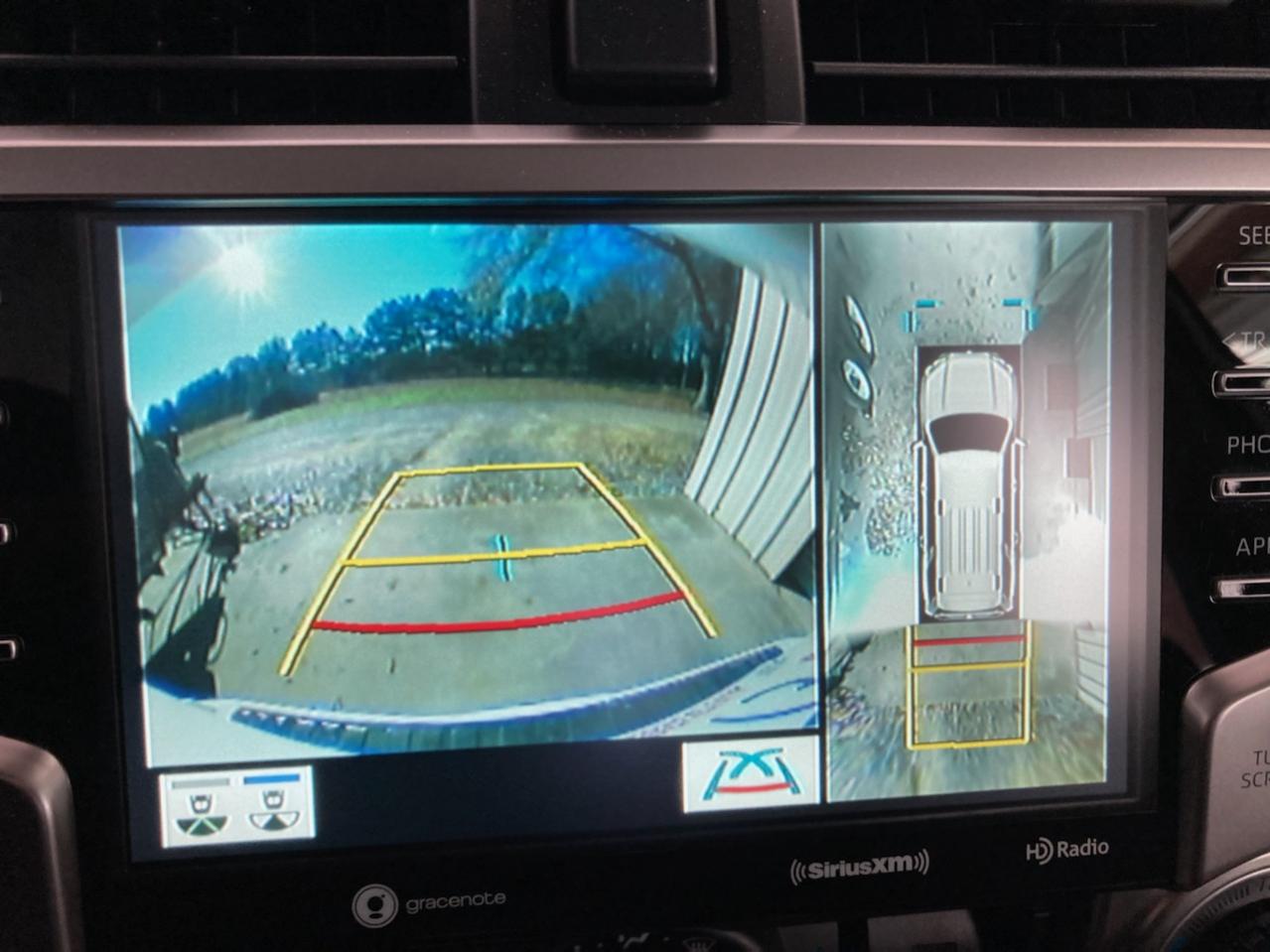

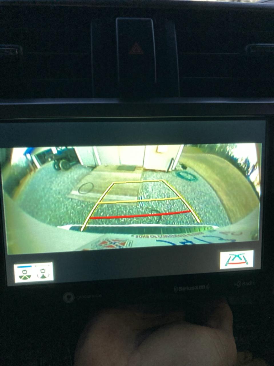

First picture is from my cell phone camera, an iphone 7, nothing fancy.
Second picture is what the OEM backup camera sees in early morning
Third picture is what the OEM backup camera sees at night
Fourth picture is the OEM backup camera in front of my shop earlier
Fifth picture is the OEM backup camera in full screen mode
Sixth picture is the Anytime camera systems new camera
Its clearer, its better, i will have to see what it looks like in the dark and in other situations to tell whether i think its worth what its taken me to get it working plus the amount of work to mount it, and run the wiring. I was hoping for spic and span perfect quality. This is kinda on par with most other backup camera add-on systems for other vehicles. This camera may be the best there is, maybe its the screens quality or maybe i am just being too picky. This isnt as good of a picture as my 2008 4R with an aftermarket double din radio and cheap $100 backup camera but its leaps and bounds better than the OEM setup.

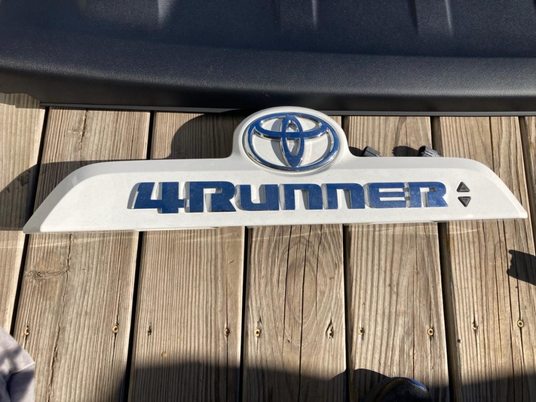

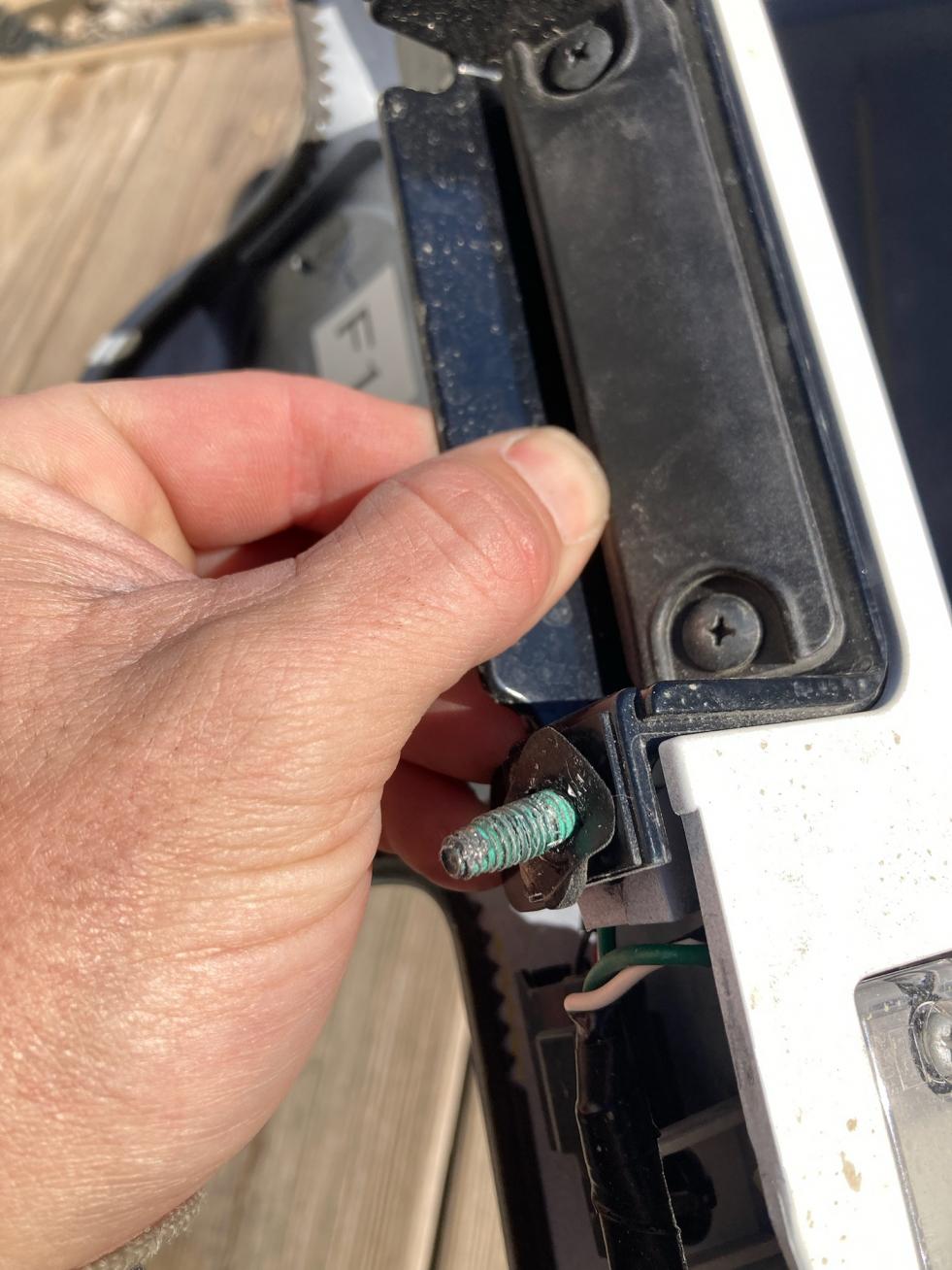

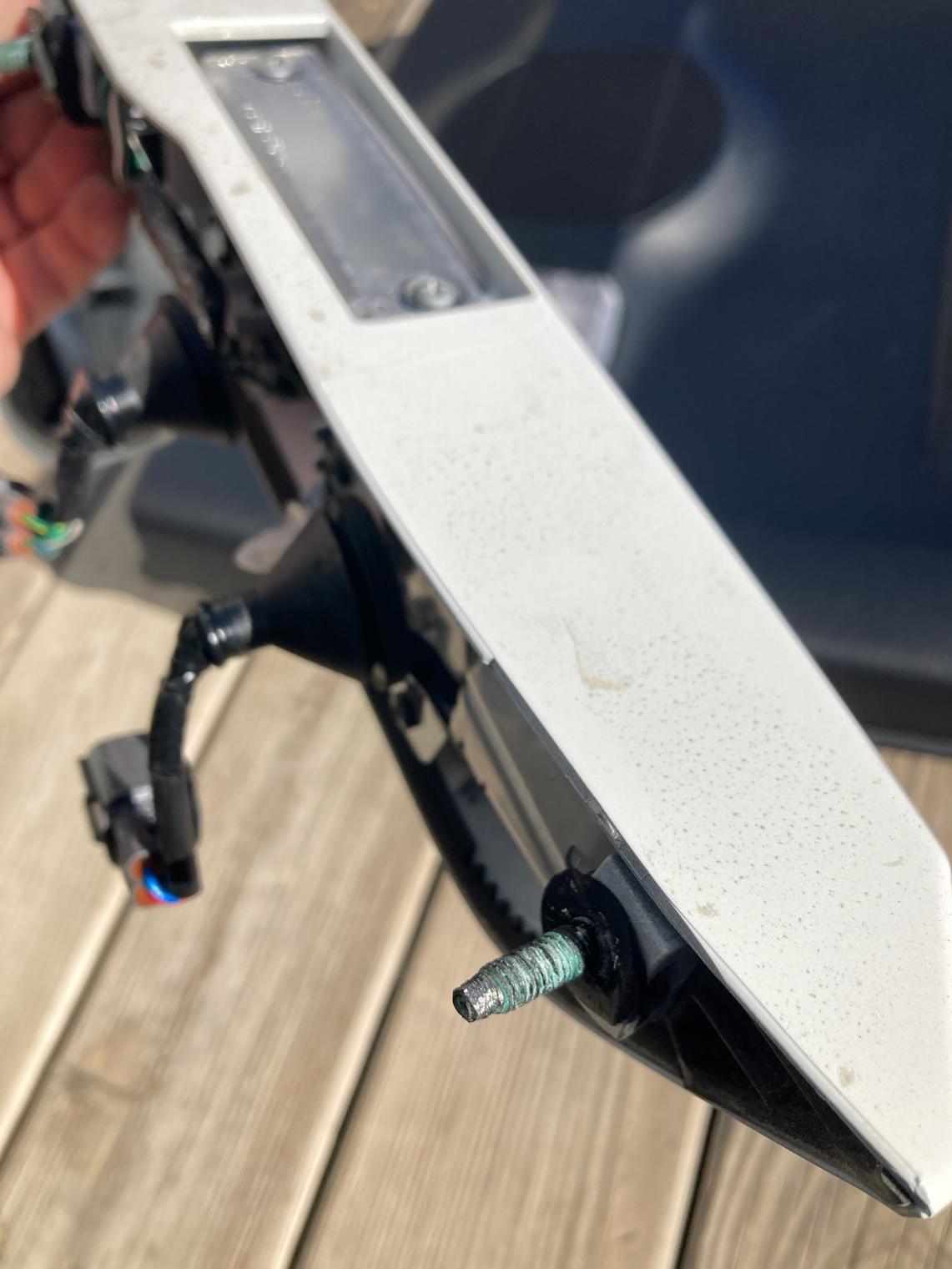

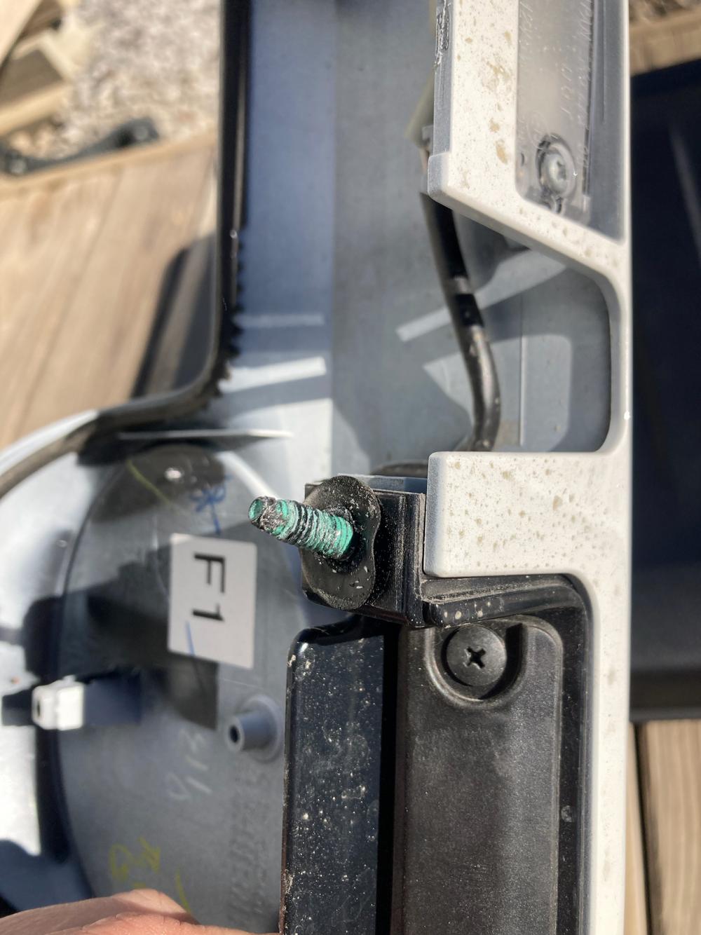

This is for anyone who is going to pull off the rear emblem piece, be forewarned, there are 4 bolts that have green loctite on them and YOU WILL break the plastic buckets they sit in and you WILL NOT be able to get the rear emblem piece off very easily. I have done backup cameras in a few older 4th gen 4runners and also had to pull this same piece off on my 2012 5th gen to replace it. I have never seen loctite on these 4 bolts so naturally when i went to pull the rear piece off this current 2023 i just stuck my long extension and 10mm on the impact and zipped the nut off, however in all 4 the nut was stuck and the bolt head spun and broke the plastic bucket the heads sit in. Once the bucket the bolt head sits in breaks the bolt spins with the nut. The only way to get the nut off is to grab the tip of the bolt with pliers and back the nuts off with a wrench. This mauls the tip of the bolt up and you cant get the nut off so you have to file the threads with a triangle file, up in the rear hatch, and boy its a pain.
If i was going to try this again i would use a mini propane torch like you light cigars with or something to heat the bolt and nut up before i pulled it apart. You are going to have to melt that loctite before you are going to get the nut off without breaking the plastic clips that hold the bolt head secure.

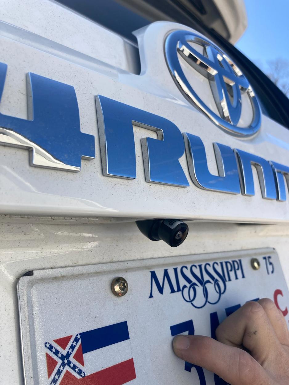

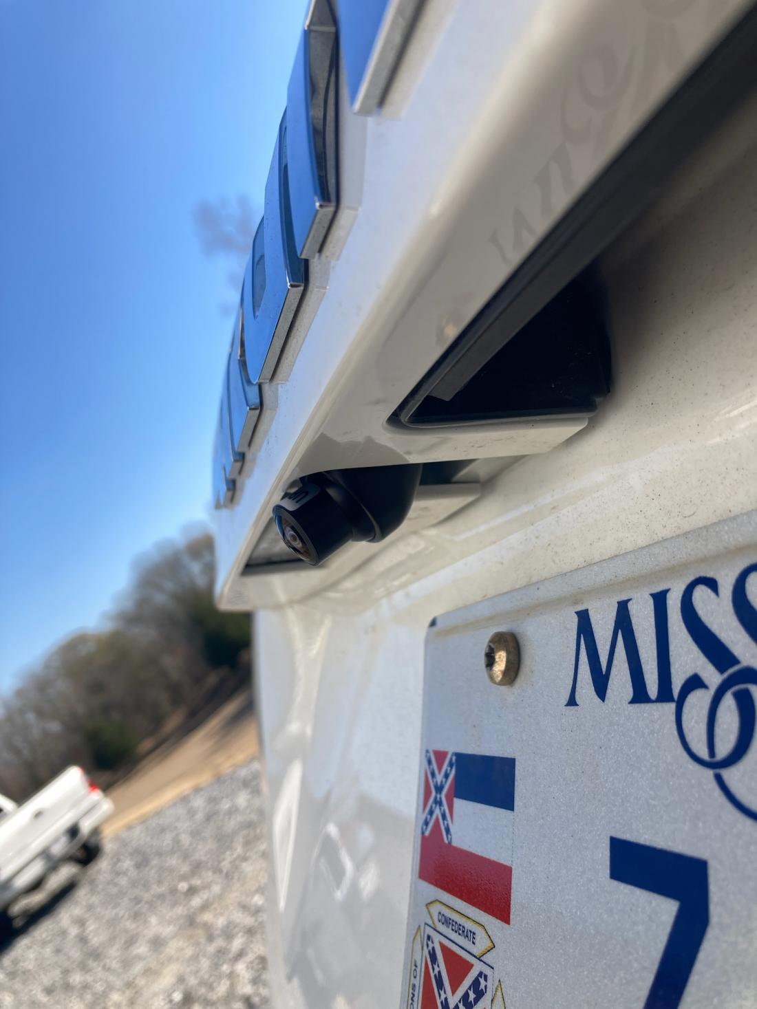

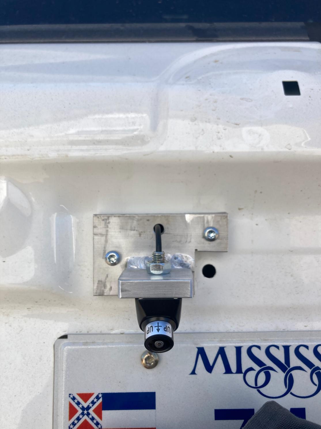

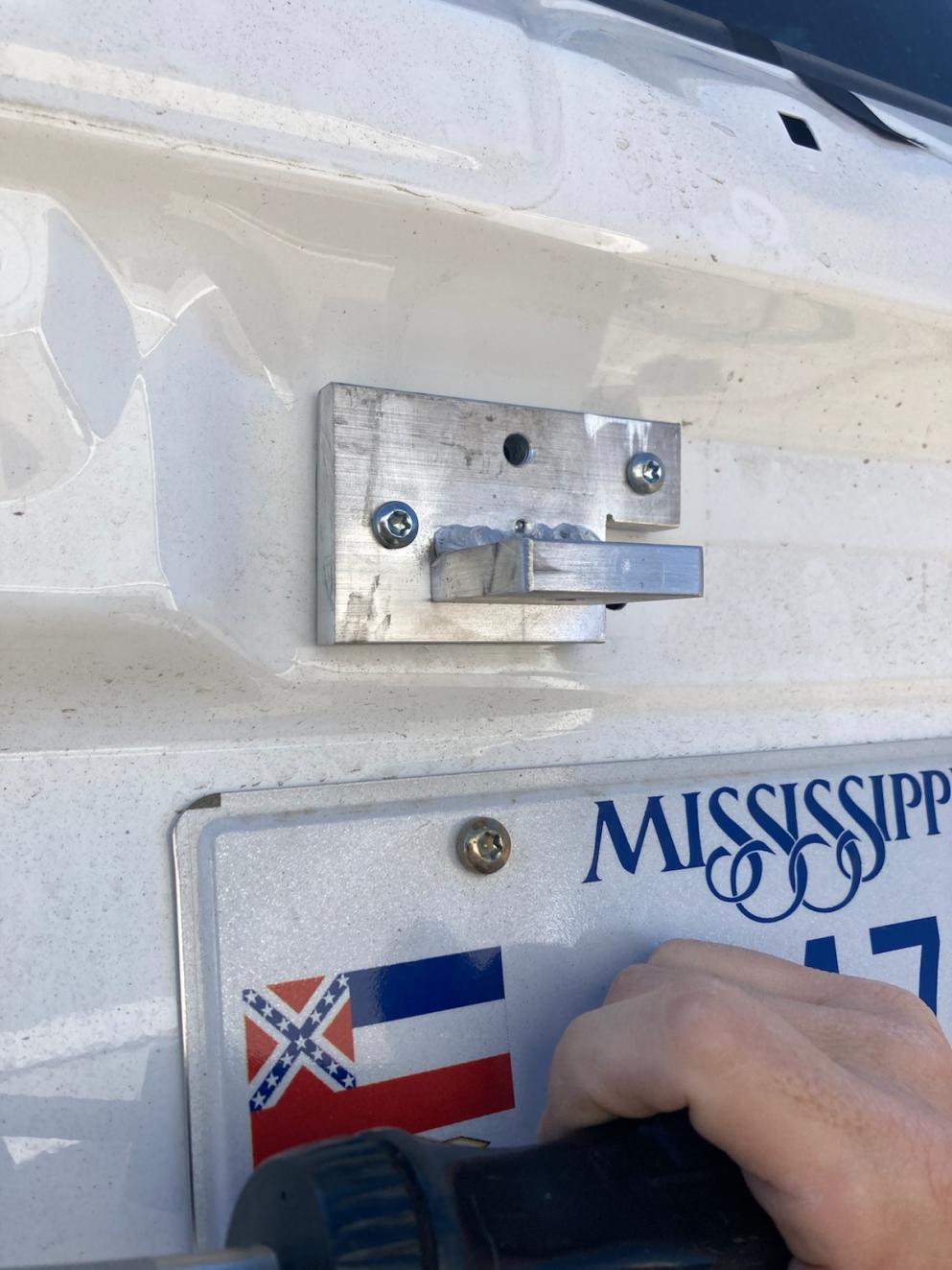

Here is a few pictures of the mount i made, and the camera installed. I put the lens out a little further than the OEM lens, intentionally to try to get away from seeing so much of the vehicle on screen. The OEM backup camera was tucked in pretty deep in the pocket and you would see the whole bumper pad on screen, as well as the tag light and plastic piece overhanging, as well as the sides of the tailgate beside the tag. I pushed the lens a little further outward to try to minimize any "static" in the background and just get a clear image of whats behind me.

So it took me a bit longer than i originally anticipated to get this done but its finally done.
A few key takeaway points
1) This system was not designed to run as a REAR camera, it was designed to run as a FRONT camera add-on
2) Since this system was designed as a FRONT camera add-on the wiring is far too short to run to the rear of the vehicle. I ran the camera wires following the stock harness, looped under the rear window on passengers side with stock harness, and started pulling wire thru the placement of the OEM wiring and realized i was going to be about 6-7ft short of the radio harness. I re-ran the wires the shortest possible route, across the tailgate to drivers side, spared not one single inch of wire pulling tight and tying to OEM harness, pulled as tight as i can thru the headliner to A-pillar, with this system wired in a rear camera, you are going to be about 2.5ft short on the wiring so you will need to extend the wire or build yourself a short adaptor / extender for the RCA cable.
3) Since this system was not designed to run on the 360 degree MTM (Multi Terrain Mode) camera system, the wiring was a fair bit different and required some changes to the harness and wiring system they sent.

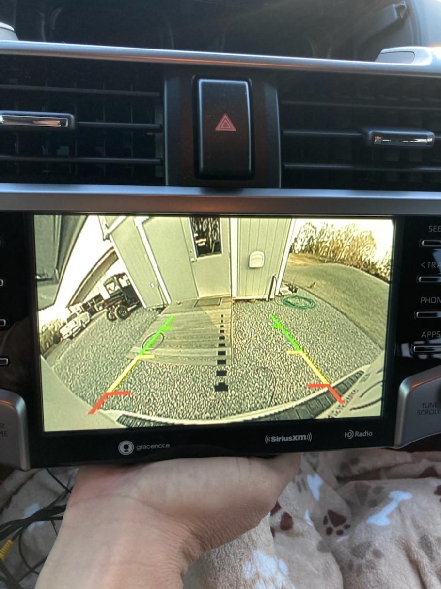

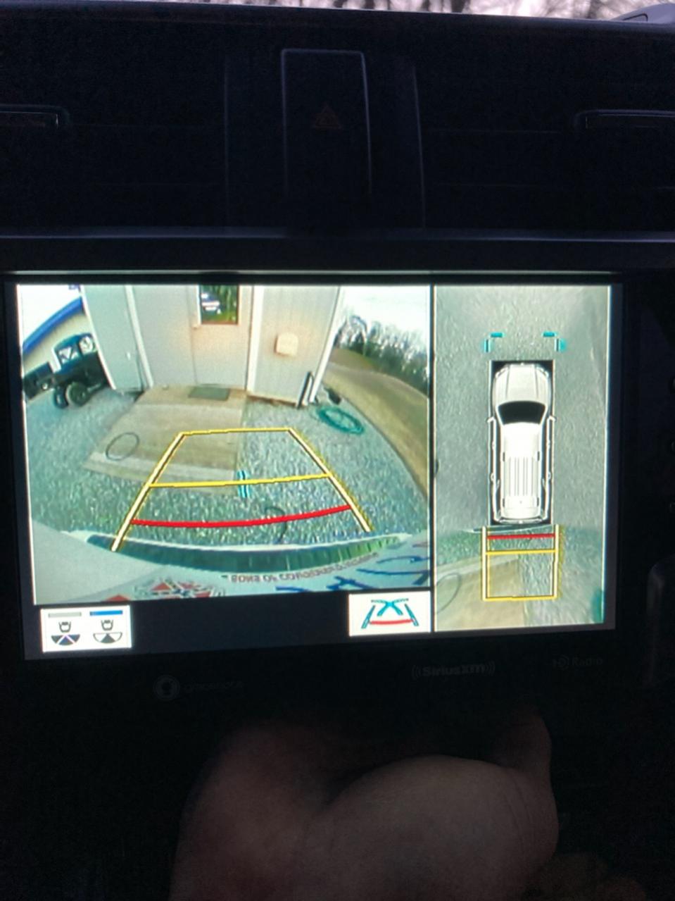

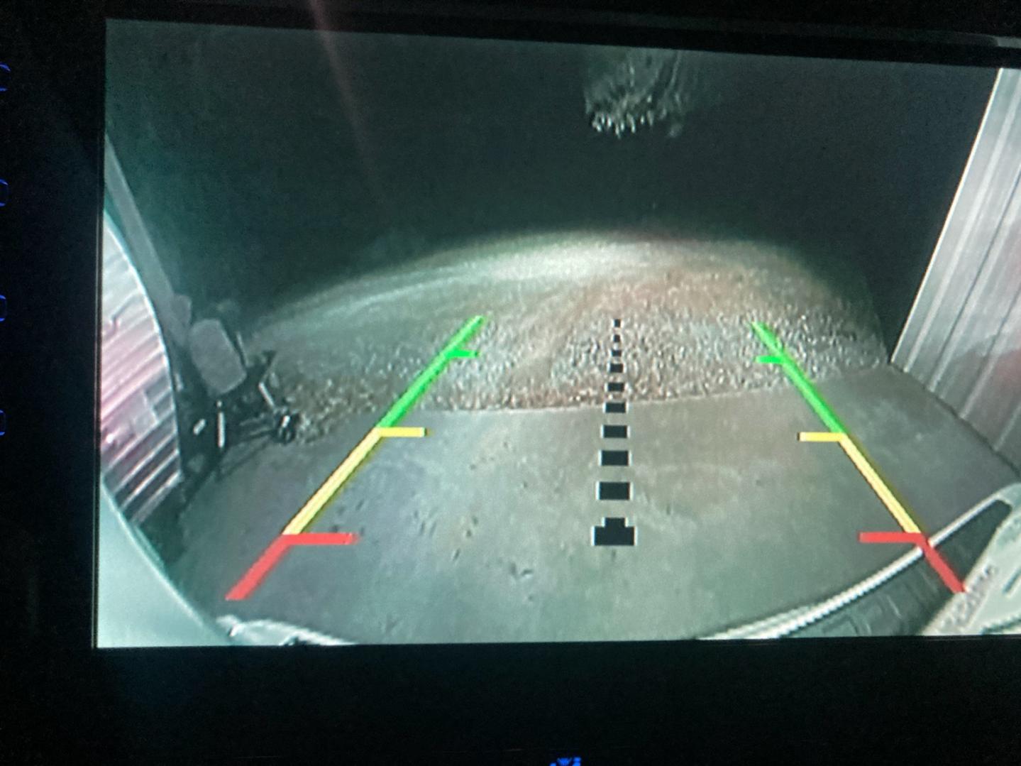

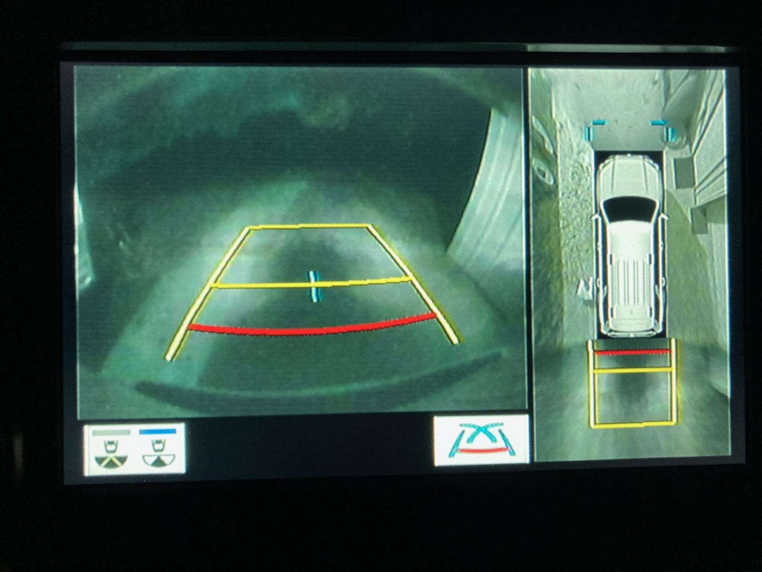

First picture is before with OEM backup camera, the night-time quality was horrendous, like virtually unusable.
Second picture is last night with Anytime Backup camera system wired up
