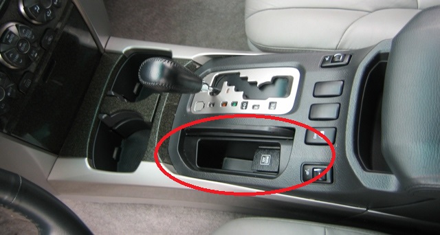

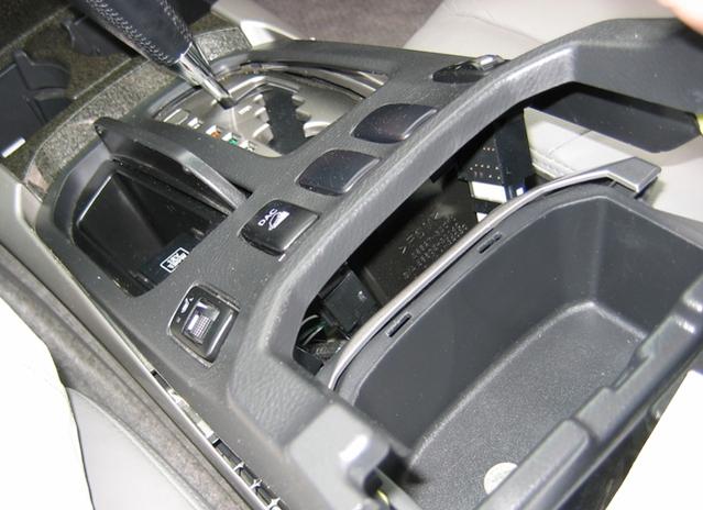

Hello fellow 4th Gen-ers... Appreciate any help you guys can provide.
My DC power port is not working, I was trying to fix DC port in the center compartment next to the shifter.
So I removed the whole thing... Anyways I failed to fix it.

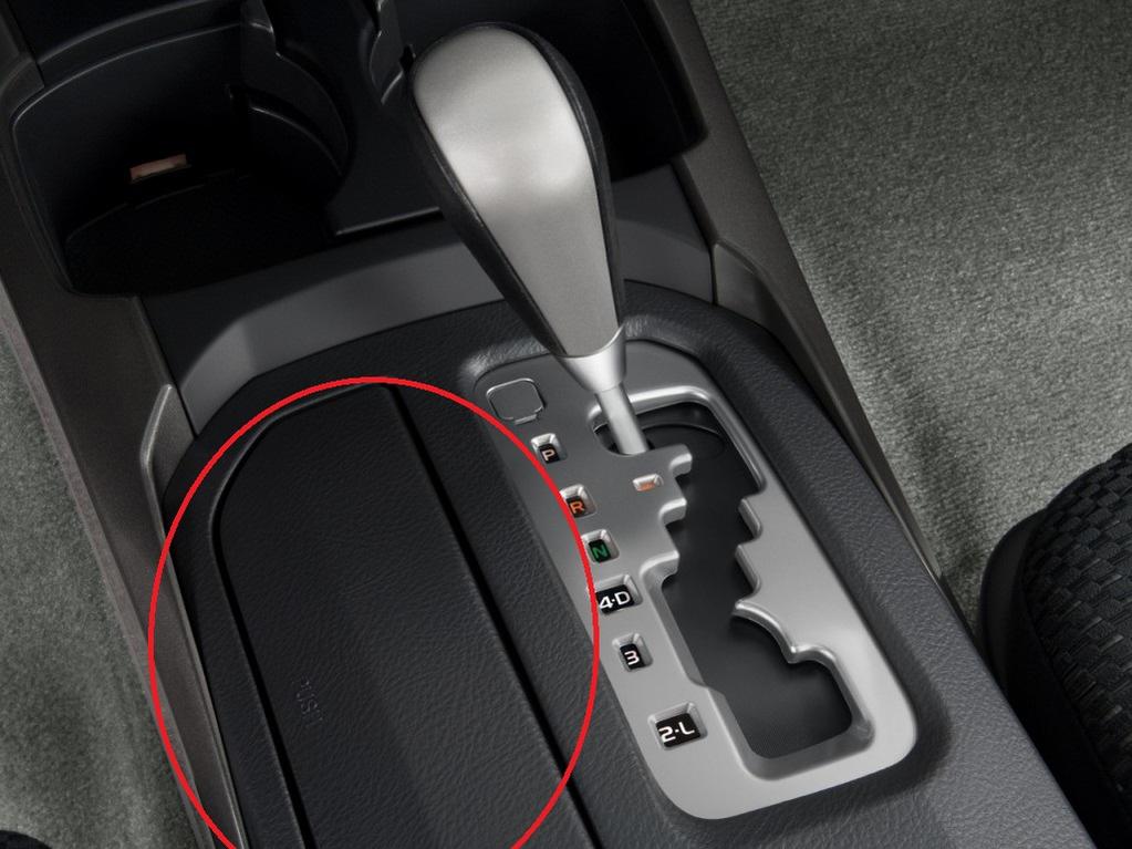

When putting it back together the slide over cover/door wont close anymore.
Seems like something that closes it when you push it fell out??
Anybody know how I can fix this? Is there a spring? How does the mechanism work to keep it closed and open when you push it?
Attached are pictures of the cover/door I am referring to. Screenshots are pictures I stole from google just to refer to what I am talking about.
P.S. - Also if anybody knows how to replace the DC port I would love that too.. I'm not sure if the port itself is dead or maybe a fuse.

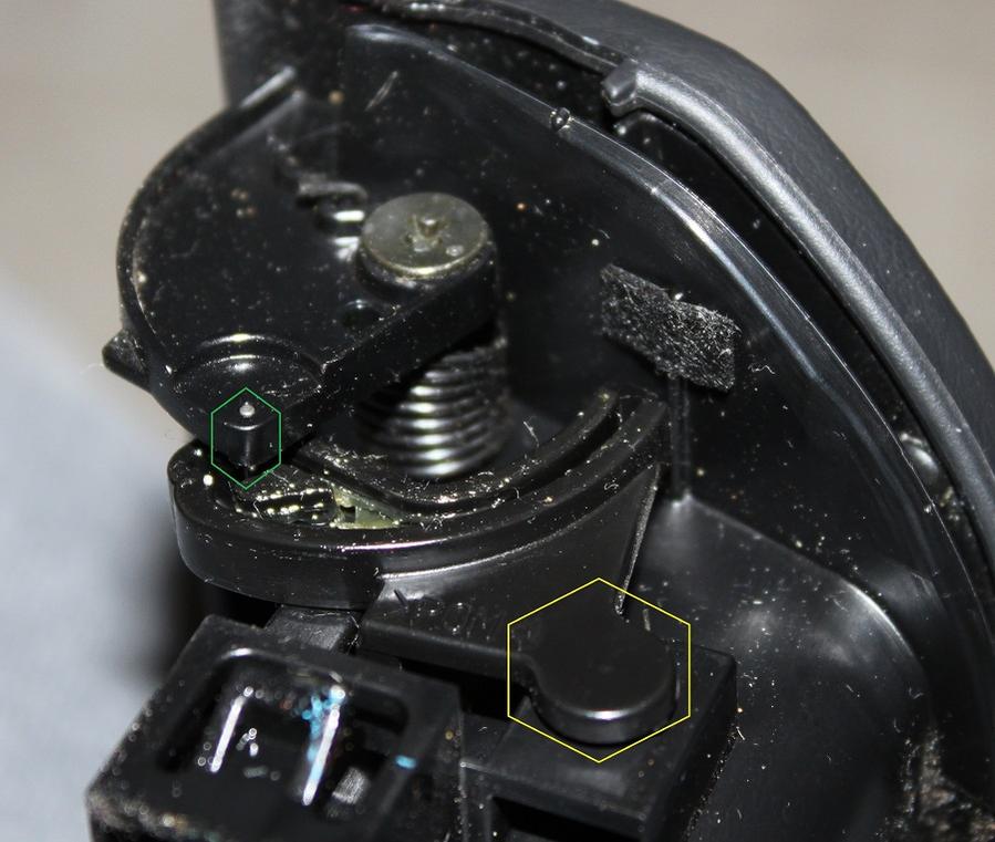

Had this thing sitting on the table.
Looks like a rotating cam like thing.
If the little metal pin broke or fell out, green hex, or a small spring broke, yellow hex then it might not work.
