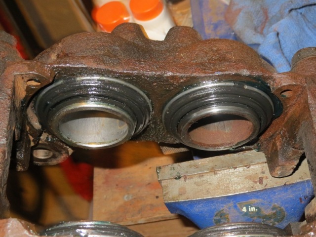

Pic 1: Depress the brake pedal to expand the pistons. DO NOT do this with the caliper removed from the rotor otherwise the pistons will pop completely out of the bores and you will be dealing with a massive brake fluid leak.

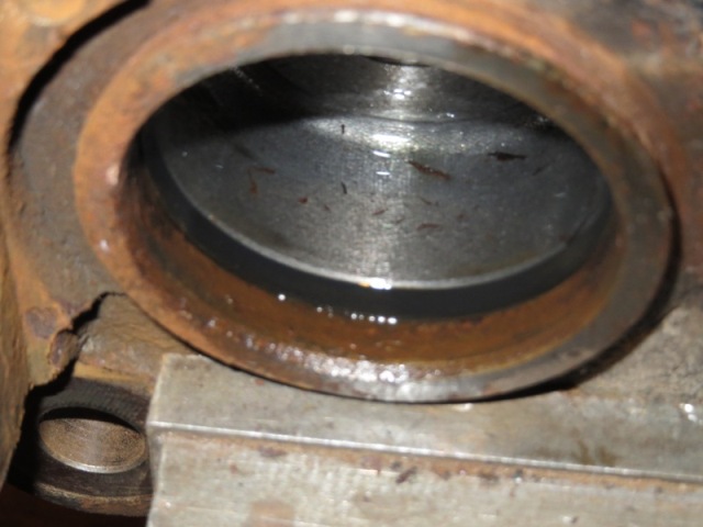

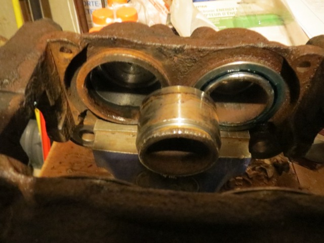

Pic 2: Close up. Notice the rust on the lower inner piston. This piston wasn't completely stuck but was hard to compress.

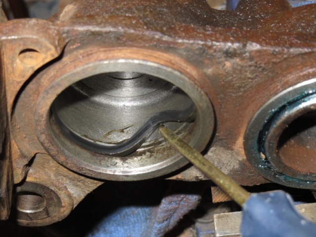

I didn't remove all of the pistons. I cleaned, inspected and lubed each that was freely moving. Then I manually depressed each back into the bore. You can see how this looks with the right side piston in the first pic below.

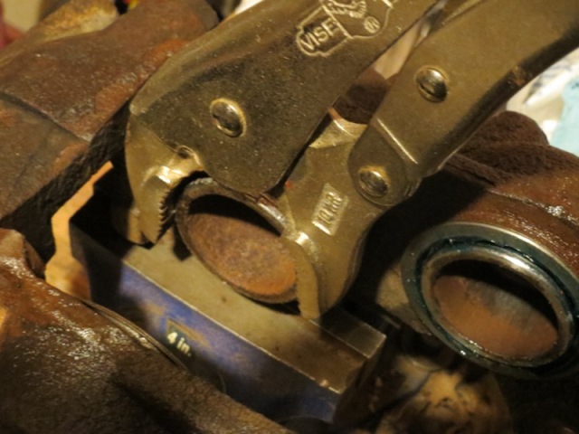

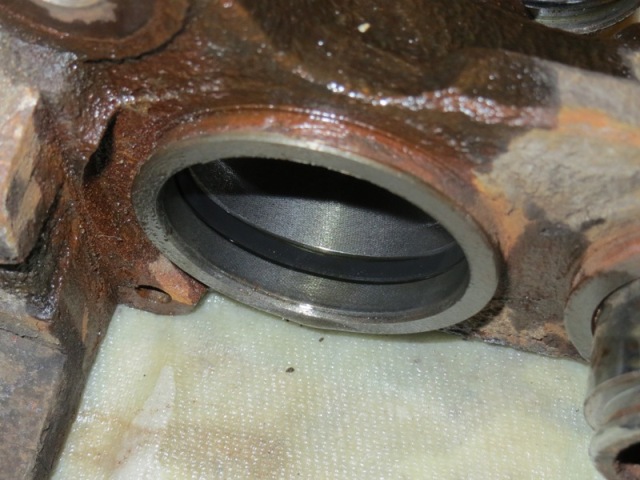

Pic 3: After doing the 3 easy pistons I worked on the lower inner one. What a PITA. This one wasn't even entirely frozen like the driver's side. Tried to use a vice grip to remove it. It was hard to budge and rotate. Ended up using a hammer and drift to knock it out by working my way around (sorry no pic of this.) Time and patience.

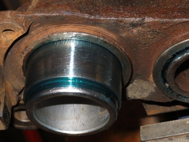

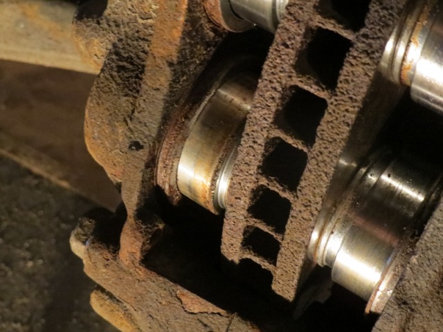

Pic 4: Shows the bore with the piston removed. The piston isn't badly corroded and the surface rust is easily removed but I didn't want to chance it and just used a new piston (plus I chewed up the top pretty good with the grips.)

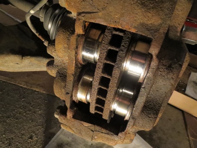

Pic 5: A close-up of the culprit. Notice the rust buildup on the inner bore that causes the diameter to close/decrease and "grab" the piston.

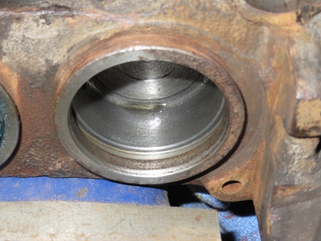

Pic 6: Removed the bore rust as best as possible with emery cloth. Did this with the old seal in place to keep as much junk as possible out of the groove.
Then remove the old seal.
Pic 7: All cleaned up and ready for a new seal. Used liberal amount of lube on the seal.

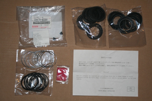

Pic 9: The OEM seal kit. It came with 2 sets of different styles of cylinder boots (see next pic.)

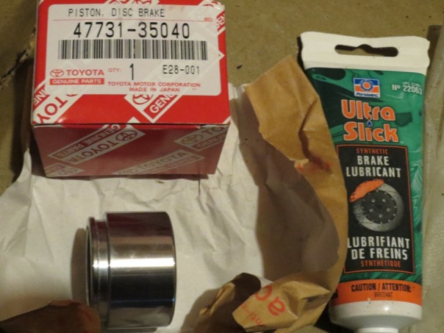

Pic 11: The OEM piston and the brake grease I used. There was a very small packet of Toyota pink grease in the kit. You can buy a larger tube of this but it's an arm & leg at the stealer. The PermaTex works. Be careful to use the right "lithium soap base glycol grease" that is compatible with the seals. DO NOT use white lithium grease.

Pic 12: A piston all lubed up before being inserted back into the bore.

1) Yes, that kit is everything needed (seals, boots, spring rings, bleeder covers) as shown above in picture 9 in post #5.
2) The brake line fitting screws back into the caliper without any replacement seal.
