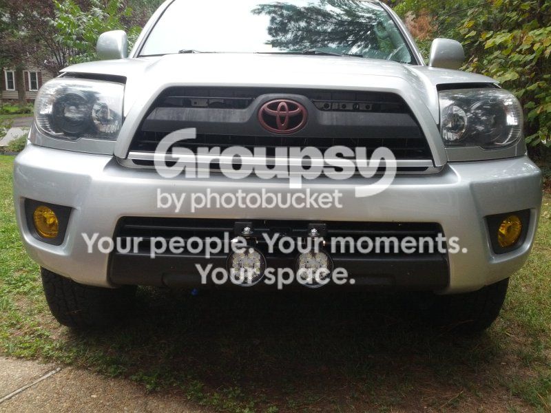

i have a cbi front hitch. keeps the front hitch like those from curt from being the first thing you hit off road. right now i got lights mounted to it but have put other things in it and really like the build quality

Yes, I considered the CBI - I called and spoke to Nathan. He said their hitch doesn't play well with my avid light bar.

i will say the cost of the cbi hitch is twice what your hitch is so thats one down side to cbi. its all about what YOU want for your rig. not saying cbi is a better option just a different one for those that look at this thread. i can also confirm the the avid light bar will not work with a cbi front hitch. i helped a friend install one and i compared the mounts. with some work or fab i think you could do it but it would be a lot better with your option. all in all its great to see more people getting front mount hitches

I don't understand your silly antagonism. Yeah, I like CBI products too. I run their frame sliders and they make quality products.
In my application, the CBI did not work with my light bar. Besides, even if it did, I wouldn't want my cargo mounted up that high right in front of my radiator blocking air flow.
