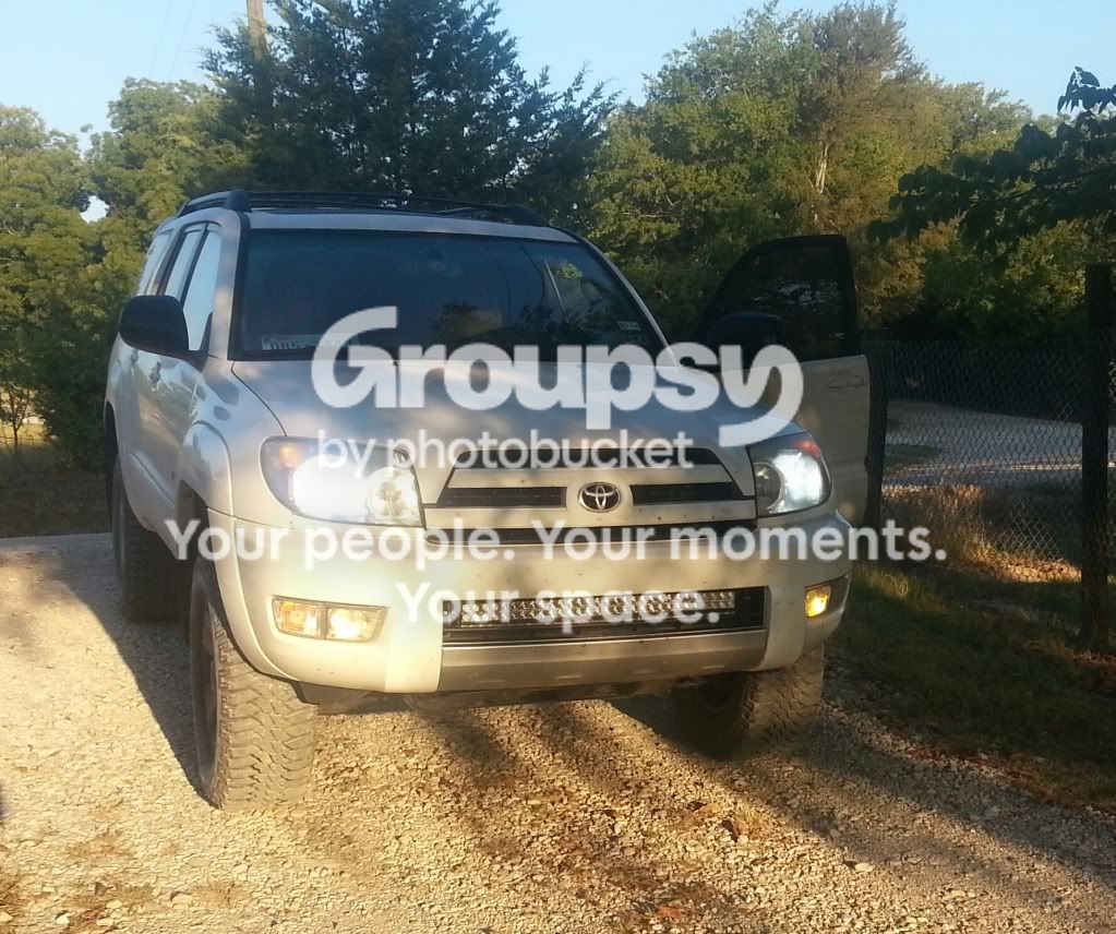

I just installed a 30" led light bar. Kinda a no name brand which I got it from a friend at an audio shop. The light bar is bright so I am happy.
The install was pretty simple. I do not have any pictures.
Cut the top portion of the lower grill out with a razor knife.
There is a metal bumper bar located right there at the bottom of the grill.
Modify the light brackets to mount the light lower to have it align with the grill opening
Drill and threw bolt 3" 1/4x20 bolts to mount to the metal brace
I used a rocker switch and mounted it in the blank spots on the left side of the steering wheel
I wired a relay under the hood and put a fuse inline
Total time for wiring was 45mins
Total time for the mounting was around 1.5hrs
