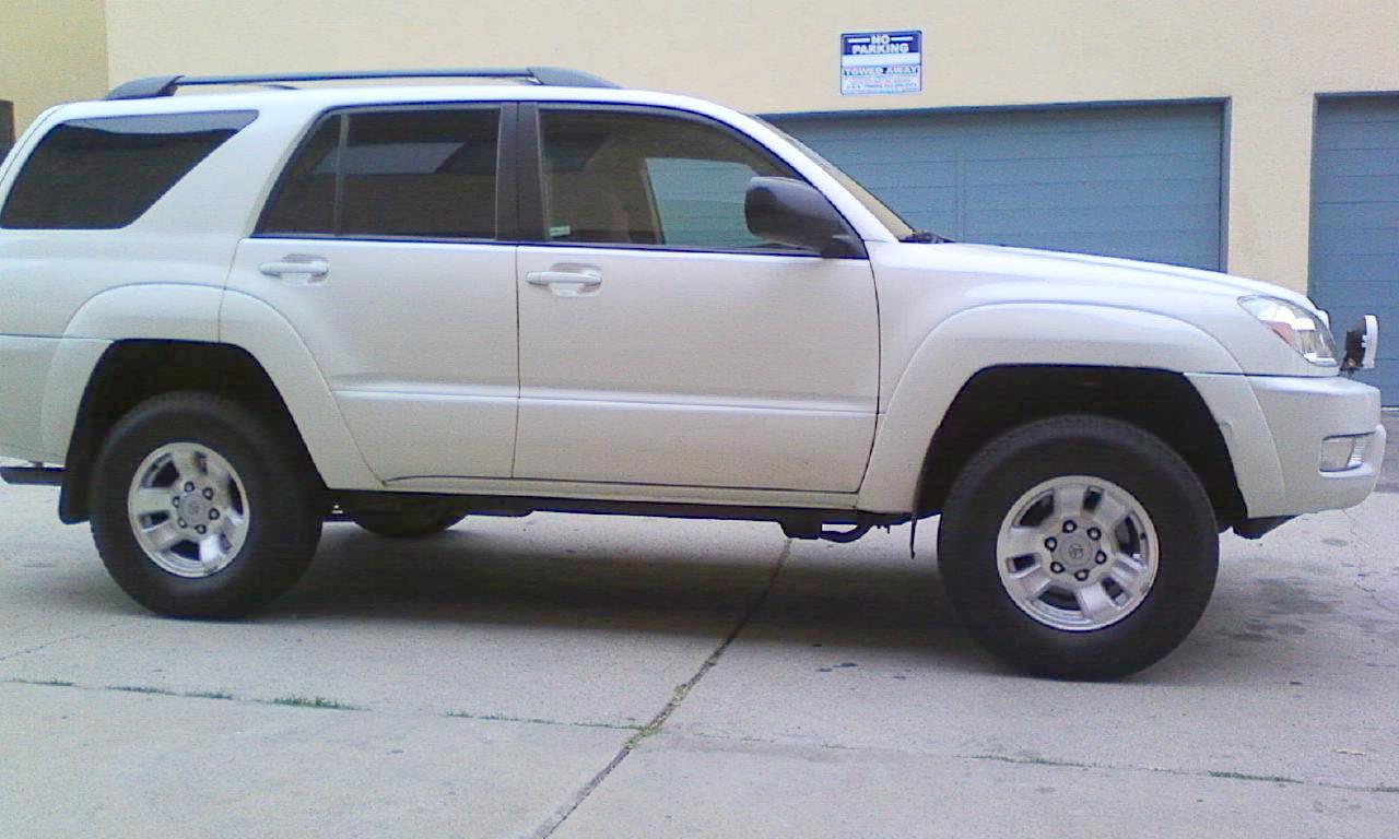

The 5100's are adjustable, seems pointless to me to buy a spacer to use on top of that. Use the shock as it is intended and you can level it out. The FJ Bilsteins and Bilstein 5100's are both more firm than stock, but this is a good thing. A member here has FJ springs with 5100's that he just put on his 4runner, and the difference is amazing. After riding around with him, I'm looking to ditch the stock suspension because it was much smoother than mine (and mine's smoother now than it was before the lift). I went with FJ springs front/rear and a 1/2" Toytec spacer. I wasn't ready to ditch the stock shocks, and this was a great solution. I gained 1.5" lift, although yours will vary based on engine and drivetrain. Here's mine, more info/pics in the link in my sig.
