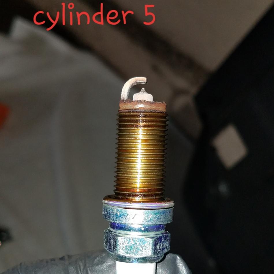

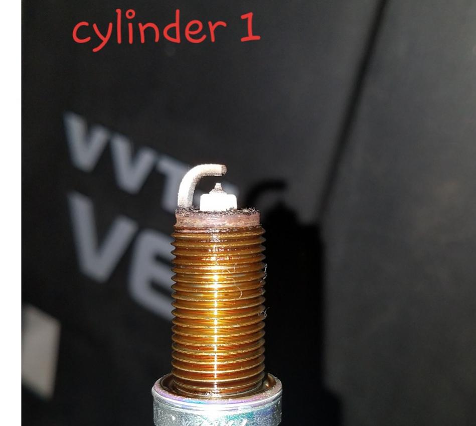

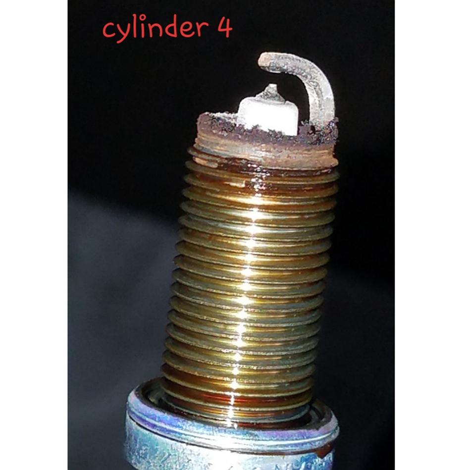

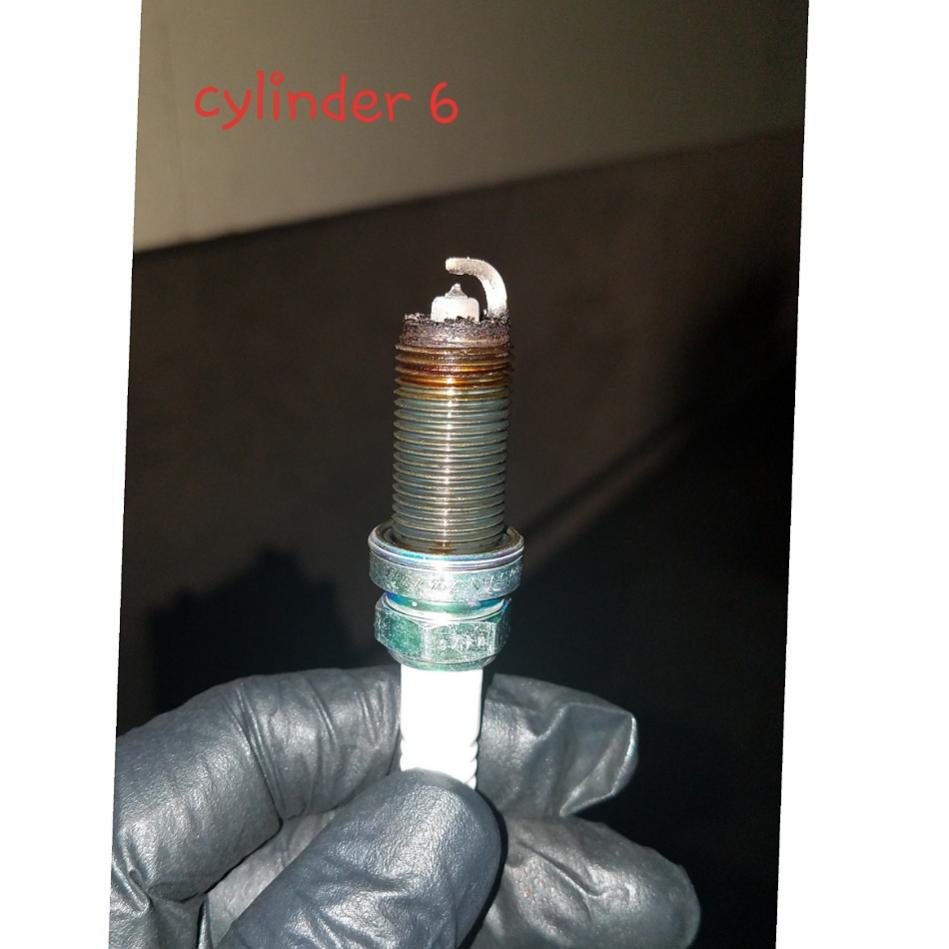

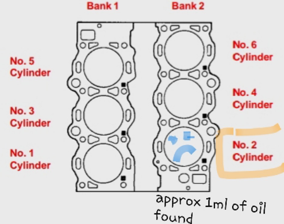

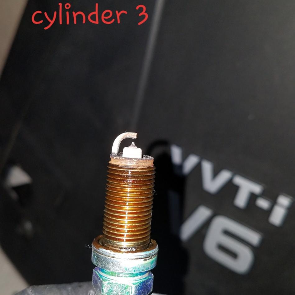

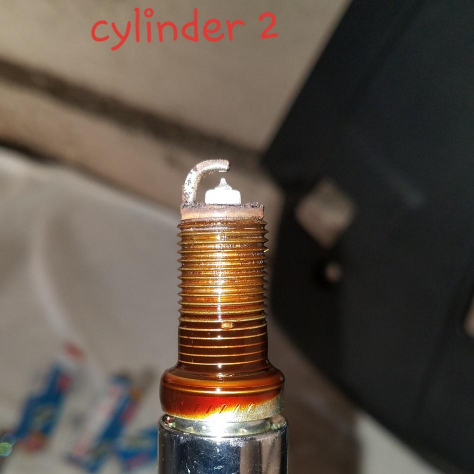

Here are my findings during todays spark plug change.
What can you report from these findings and or suggest? [MENTION=66389]BlackWorksInc[/MENTION]
And everyone else too!
It ran smooth with the old ngk plugs - gap at pull was .040, did notice one at .041...forgot cylinder. ( but I noticed it had hesitation during hard acceleration, just seemed weak.
After putting the Denso plugs in ( gapped them at .043 per manual) it runs very smooth, quiet idle, hard acceleration is excellent, very responsive and runs great now.

Remove valve cover bolts and inspect/ replace gasket?
This.
There are round gaskets for each plug tube that seal between the head and the valve cover. If you're going to tear off the valve covers, might as well change those gaskets too, usually come in sets. Don't forget the crush washers for the cover bolts
This.
Yeah I agree on changing all the gaskets. I didn't know there were crush washers for the valve cover bolts, first time hearing about that on this subject. I think I may have even noticed some black sealant under the valve cover bolts on mine if I remember correctly. I'll have to take a look.

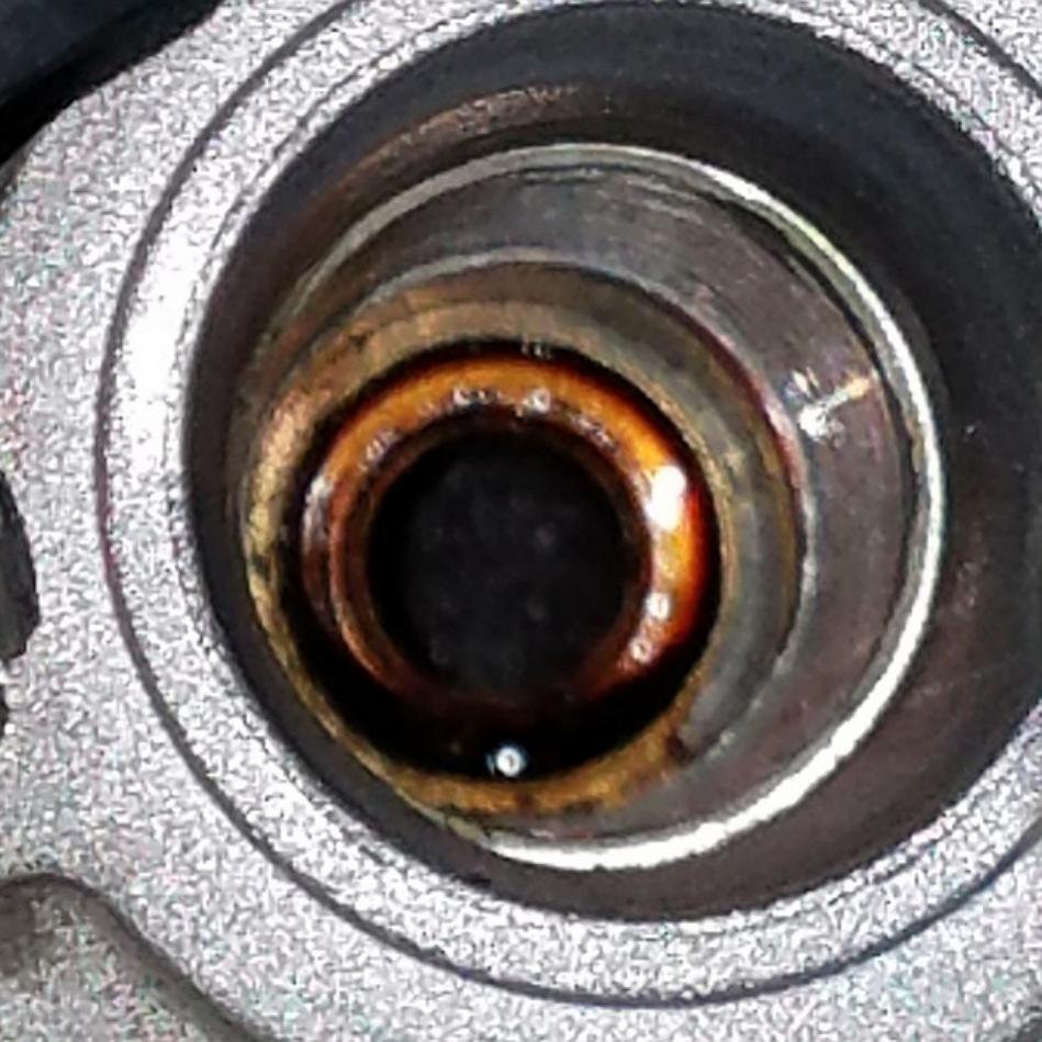

At this time I'm not even close to being ready or prepared mentally to take on valve cover gasket replacement.

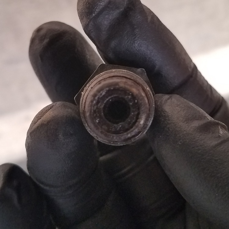

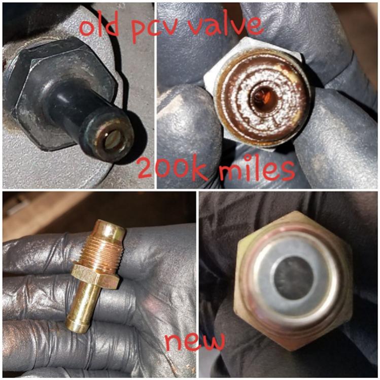

Due to the small amount of oil found I decided to check the PCV valve and see it's condition. I figured replacing it with a brand new one would help with relieving a bit of pressure on the gaskets giving me some more time before having to remove the covers and replace the gaskets. There was a big difference in the old pcv and the new one so I went ahead and replaced it. Guess I'll check the plugs in another 7000k or sooner if I sense any issues. 7k. :laugh: make fun of the new guy...I get it!

Updated:
... Guess I'll check the plugs in another 7000k or sooner if I sense any issues.

With aluminum is easy to strip the thread is why everyone cautions about over tightening the bolts, so it's important to use a torque wrench to tighten them correctly, with the smaller bolts in aluminum it's sorta important.
That all being said since you're not going to do the gasket soon it appears I would at least check the valve cover bolts for the correct tightness, if they're are not tightened correctly and they are loose it could be another reason why you're getting the leaks, most major auto part stores loan out tools for free, if you don't have a torque wrench to check them with, they do require a refundable deposit until you bring back the tool/s back, you will need a "inch lb." torque wrench not a "foot lb." torque wrench for the valve cover bolts.

I took a nice look around the covers and it's clean as a whistle. No leaks anywhere outside.
I also loosened up the pcv valve a bit since I was worried I put it in too much. It's still tight and I'll periodically check it.
I agree, it's your valve cover gasket not sealing enough on cylinder 2. since you are replacing the gasket anyway, just do both sides. don't overthink about it, just be a little more organized. you need to have a table big enough to put stuff in order so when assembling it back, you just follow the order in reverse. label it if you need to.
