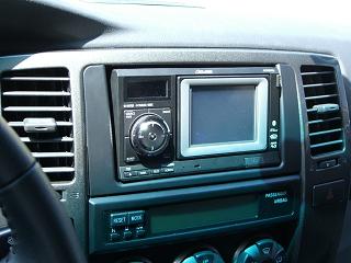

I went to my Toyota dealer and ordered the dash bezel for the Urban Runner, while still using the factory radio bracket. I just drilled new alignment holes in the braket. It took some manipulating, but looks factory.
part #PZ365-35904
Retail is $117.20
I got for $87.31 with Tax
