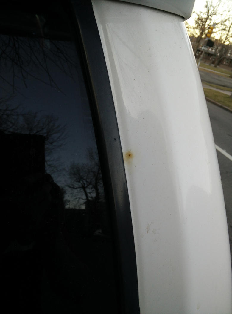

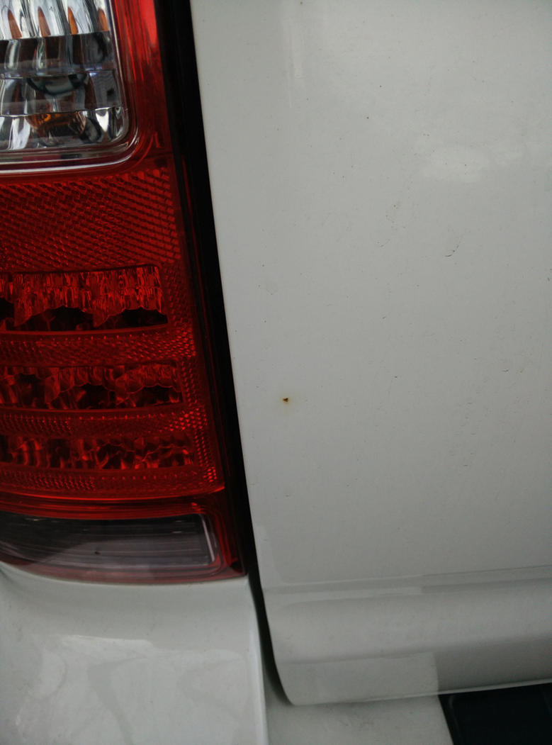

My hatch just started getting rust spots. Never had any rust till I moved to CO in December. It's like my 4Runner just decided that because it's no longer a Southern vehicle it should start to rust.
Where abouts is it rusting? I know the 06-07 models had issues around the chrome trim where it would rub off the paint and rust. I'd imagine that's your issue? As soon as any paint disappears from these hatches, whether they be chips or etc, they start rusting.
I haven't checked under the plastic trim, but these two spots in the photos there is no chip in the paint, it's just rusting up through the paint.
