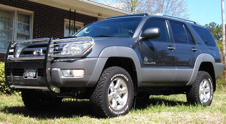

I got the 2.5" daystar lift. I love mine and dont regret a minute of it. Ride is still great.
