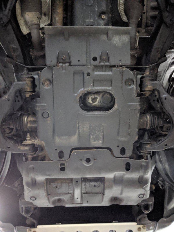

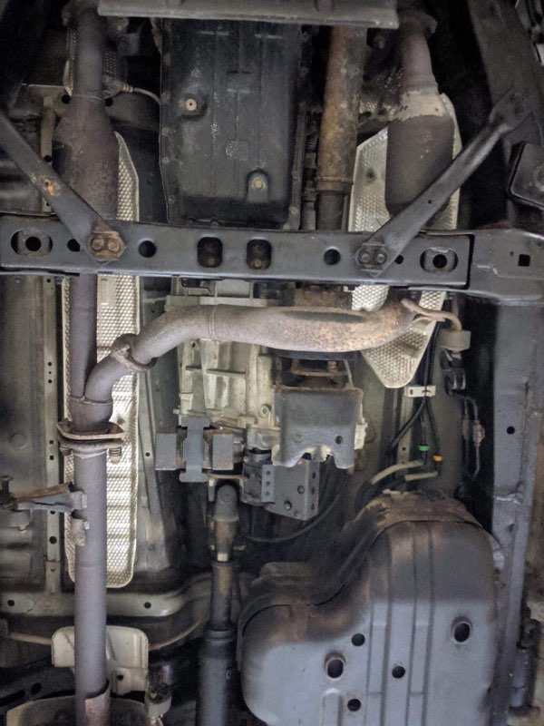

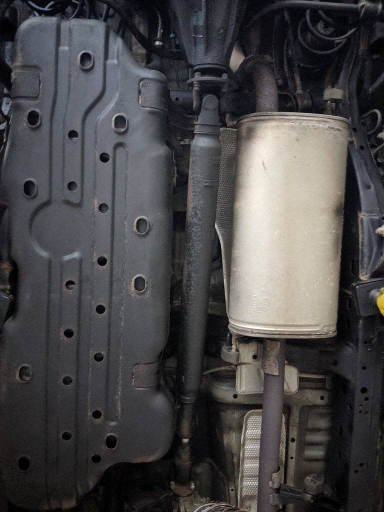

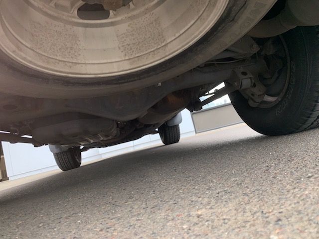

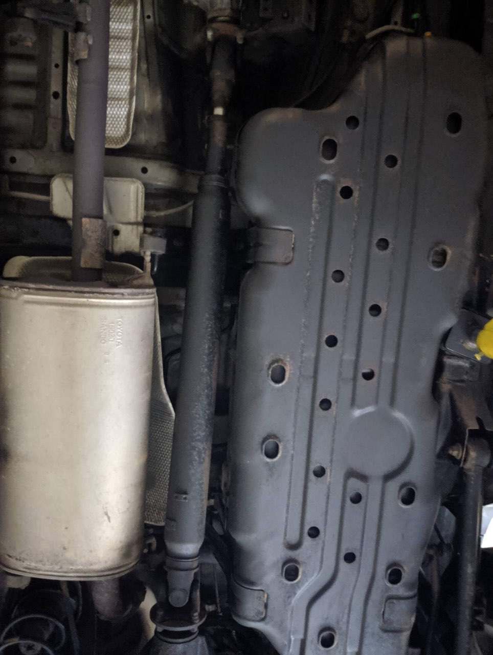

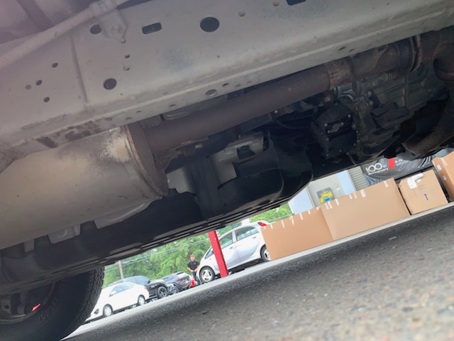

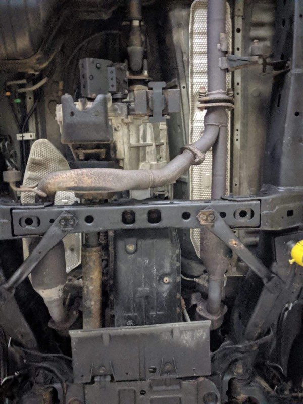

I hate to dash your dreams, but that is not what the underside is supposed to look like. the paint on the gas tank skid is supposed to be smooth, not matte. It looks like someone went to extreme lengths to hide the fact that everything is rusted underneath that truck and they painted over it. The fact that the driveshaft is rusty only on one side indicates that they parked it and painted it once without moving it and could not get paint on the other side of the rusted driveshaft, turning the driveshaft away from you on the picture (but not all the way because we can all see the rust) seems really shady to me. I would not entertain their offer of 16k. Perhaps 9k... Thats what I paid for mine in CA with 98k miles on it and no rust with the vvti v8. Everyone seems to want a 4th gen 4runner now and they are starting to pop up with scammy histories like this one.
Hell you can see the overspray on the muffler. I would walk away, but if your dead set on looking at it, take a flat blade screw driver and beat the crap outta that frame. Get an old blanket and get comfortable under there. Take a hard look at the gas tank straps as well as small fasteners and brackets under there that might show some rust. They might not have gotten all of them painted. I do this when looking at all vehicles. I saw an FJ here in Florida that was literally flaking apart. Even the axle tube was flaking with rust. Be VERY cautious!

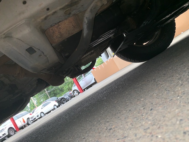

how about this sr5 with low miles?
